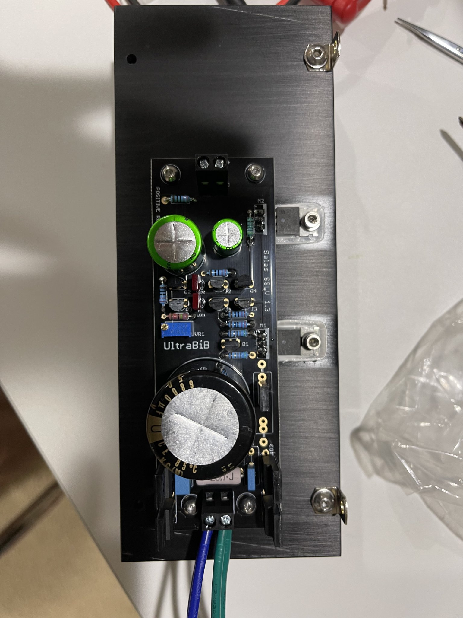

I am building the 5V shunt regulator. I’m using a 9 VAC toroid and Rs is .3 ohm to get a 2 amp output. On powering up the output is fixed at 12.65 VDC with no response to the VR1 pot. I substituted IRF 9630 for the FQP3P20 and IRF 630 for the IRF 530 as you suggested
Could you offer any advice?

If you have enough current test first wit a 2.5 ohms 30W dummy load the regulator.
Could you check or you know for sure the real load draws 2A?

It’s for a DAC the Qutest
Is R1 of .3 ohm correct?
I checked it without a load

Pls measure the voltage across R1 0.3 ohm, regulator don't need to be loadedIt’s for a DAC the Qutest
