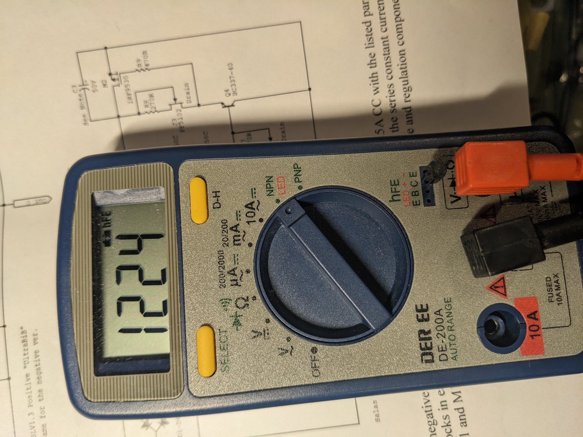

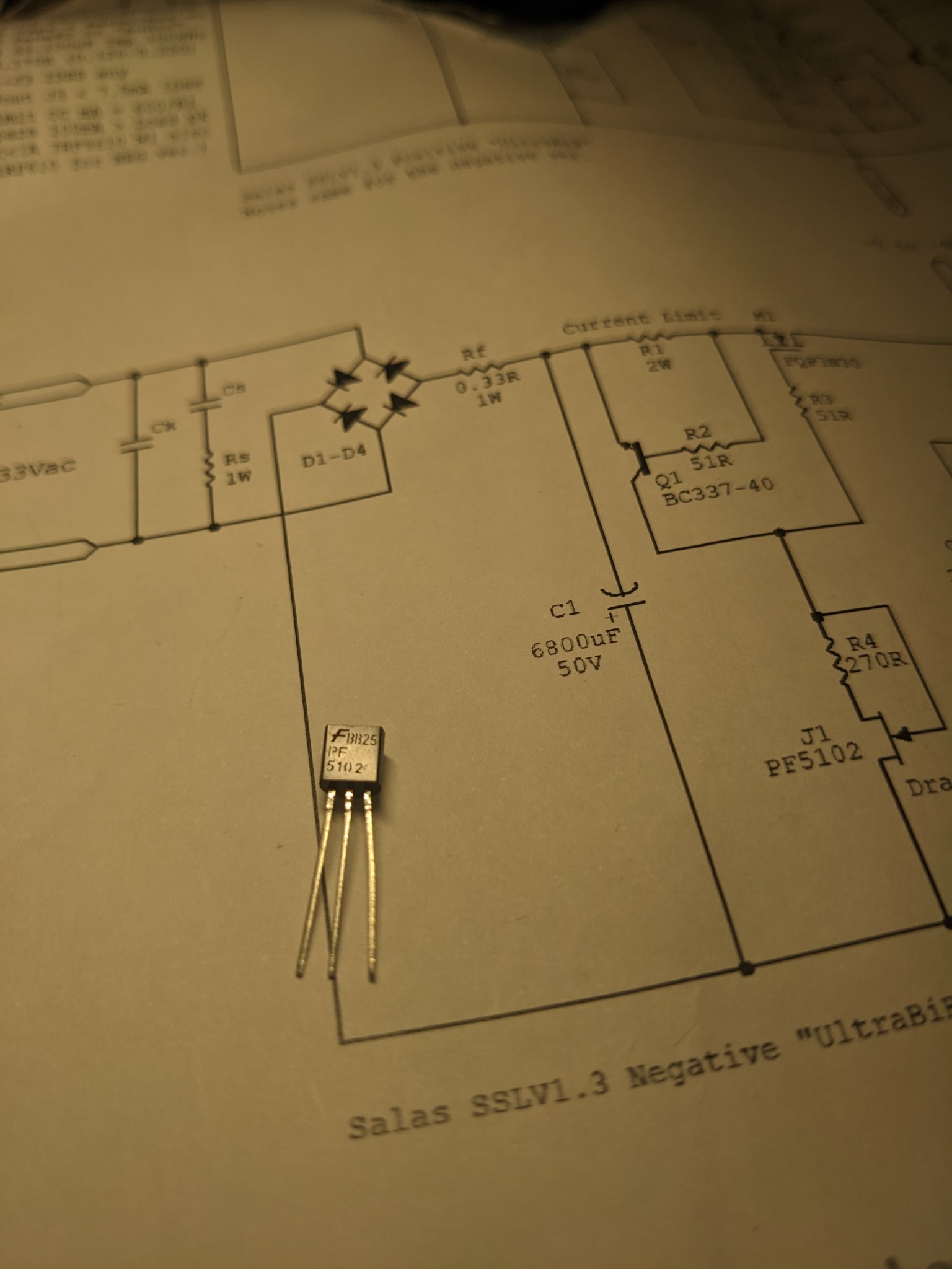

Hi Salas.
I bought some PF5102 from eBay.
Are they possibly fake?
https://www.ebay.com/str/miantaxia0...=3418065&ssuid=&widget_ver=artemis&media=COPY
Hi, its letters print and leg stems look legit. You can't meaningfully measure a JFET in an hfe tester, that's only for bipolar transistors.
@tamra
Measuring JFET Idss is a kinda more involved process. You may look it up in many threads.
If you're just looking to match you can alternatively short gate and source pins, then measure Ohms across drain to source. That indicates Rds which is inversely analogous to Idss. The fewer the Ohms the more the mA in other words. If Rds matches between two or more samples their Idss usually matches too.
