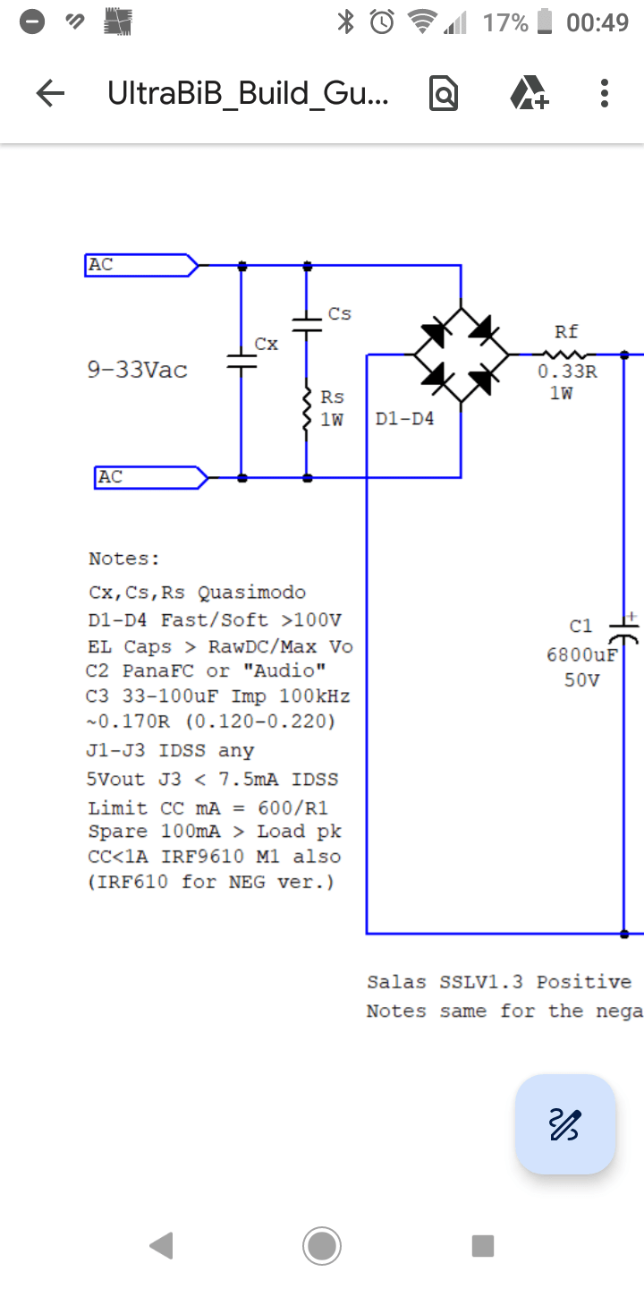

It’s current draw is not more than 2 amps
I will start going through the board after dinner
Thank you for your input so far
