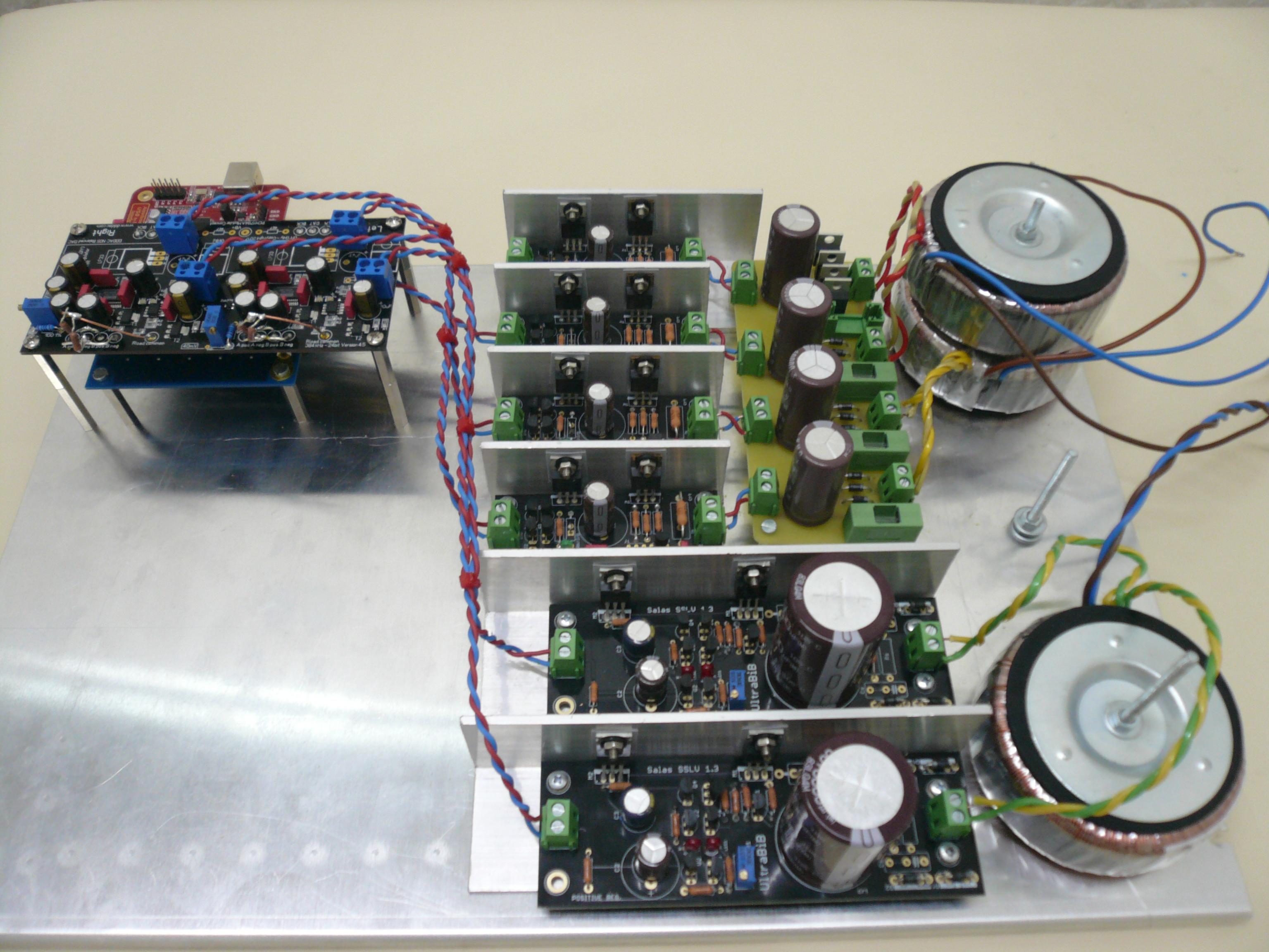

Here is my little power station... 3,3V x2, 5V x2 , 10V x2. All grounds only meet at the obscure object of desire!
Very nice

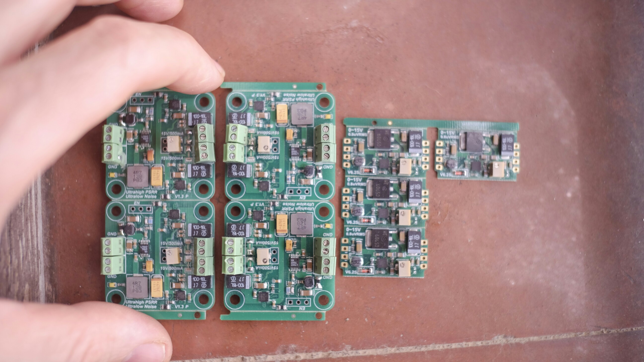

Other than to power a DCB-03 preamplifier, and a 14v. Tripath chip amp., my plan is also use one UltraBiB as a prereg. set it at 7v. and then chain it to a several 500mA. modules ultralownoise 0.8mV. postregulators LT3405. These I got plenty and cheap on Taobao site. Are claimed a flexible voltage dropout between 1V. and 4V. So theoretically I could power many 3,3v and 5v. gizmos I have in my USB chain: Filters, hubs, memory sticks, clocks, etc.
