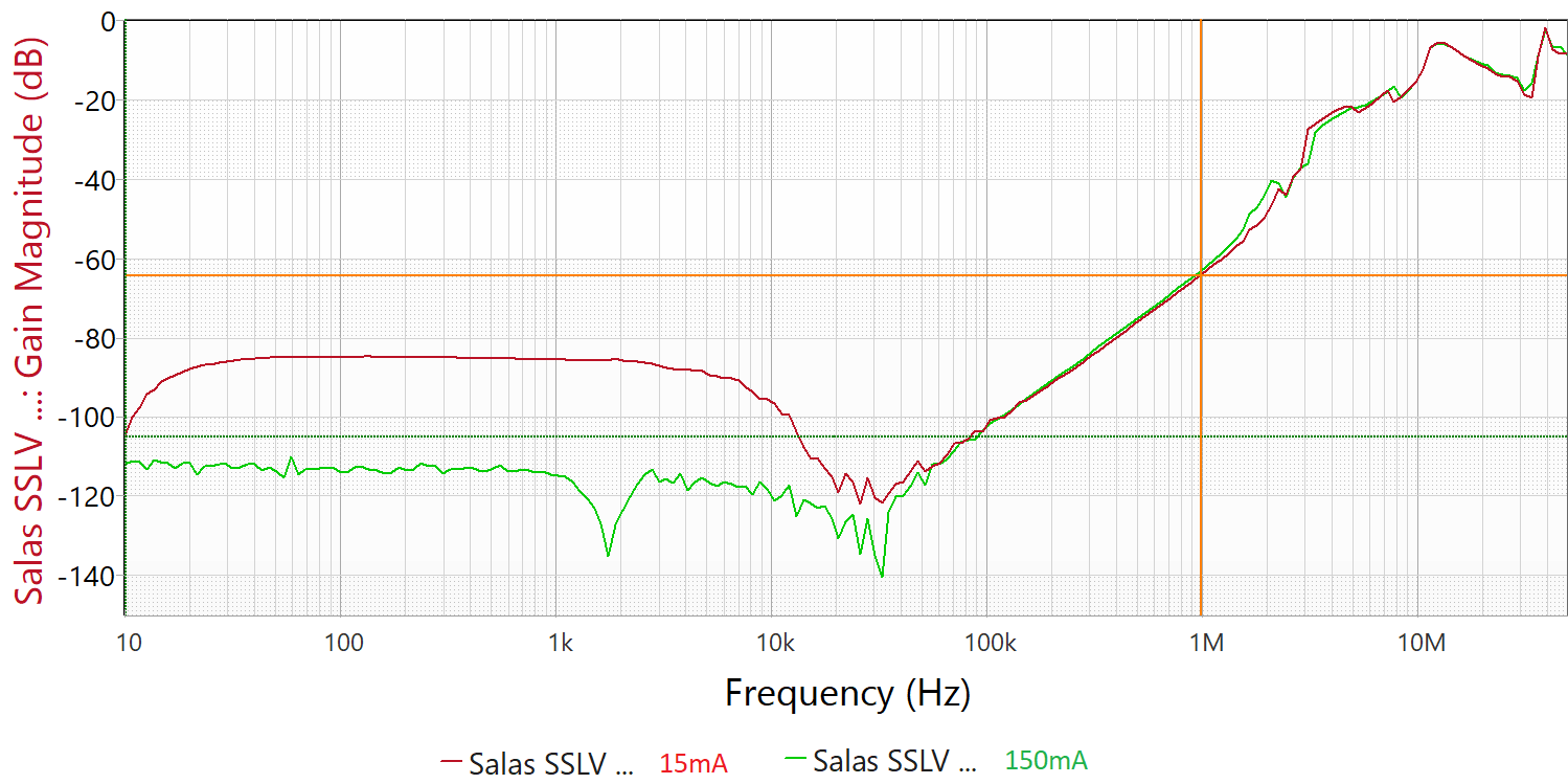

Some PSRR tests == without C1 (6.8mF). Board is cleaned of excess flux etc., etc. Powered by two 12V SLA batteries. Perturbation signal +3dBm
Nice practical results I would think. ~Flat PSRR at around -120dB across the audio band and staying below -100dB at 100kHz. LT3045 "ultrahigh PSRR" linear reg chip has -85dB at 20kHz and -78dB at 100kHz in its datasheet I now see. LT1083 has -48dB and -30dB at those frequencies. But why skip C1? OK batteries have been used in this test, still it has an HF filtering role in combination with the Rf resistor and a local decoupling role to the CCS area layout as well. With nothing there this CCS may even oscillate on enough incoming wires inductance. At least a small decoupling capacitor is recommended in C1's place when the DC source is external. Like the CD cap in Reflektor-D when the DCin mode is used. Ref-D has a similar design main CCS.
Nobody will blame you. Its a good choice especially in high CC 🙂
The guide's list has "For CC >1A C1 10000uF/50V". Of course you may use a lower voltage cap if not interested in high range Vout settings given that the trafo's secondary level is within your C1's voltage rating after rectified to DC.
But why skip C1?
Because the line injector isn't happy with a capacitative load.
Is that the Bode 100 vector network analyzer by the way? Your charts remind me of some videos I have seen with that test machine.

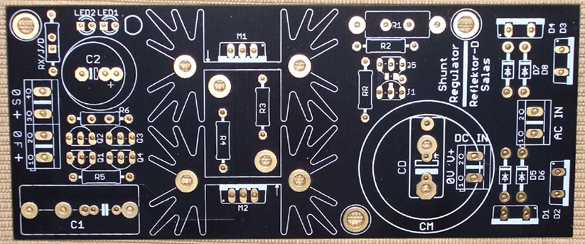

As the beloved SSLV1.1 BiB shunt reg was getting long in the tooth especially for NOS JFETS I had in mind for some time now to design its successor. The goals were: 1. In production parts 2. Much simpler to set up. 3. Better technical and subjective performance.
After many breadboard experiments and two prototype PCB iterations I feel that my goals were finally met. So here comes the UltraBiB 😀
-Uses no NOS parts.
-Can do 5V to 40V output without changing a thing in its parts configuration.
-Nothing to choose and match. No tolerances in predicting its CCS limit setting.

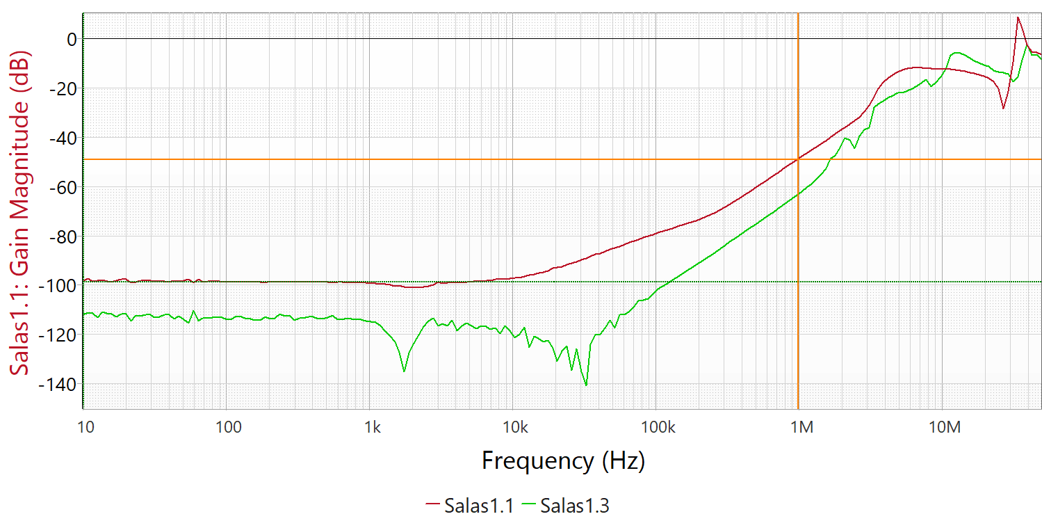

-Has 45dB more open loop gain and many times less output impedance than 1.1
-Sounds easily better.
-Its an electrically and mechanically drop in replacement for an upgrade.
I have already given spare earlier proto boards with now deleted experimental features to few local beta testers. They are all happy by now as far as I know. The pictured board in green is the final layout in just cheapo proto that's a pain to rework and its pads vaporize in the end. It will come in proper grade black solder mask and immersion gold three sections board just like the original.
Attached: Zout plot for 150ma spare current and noise plots for 100,150,220,330,470,1000uF C2 (red 220uF). Also the rails probed on the scope for positive and negative sections. Here are typical values schematics also. I will write a PDF with instructions. Not that there is something truly special to consider when building it with the suggested parts but to describe it better as an item and to clarify details and precautions.
