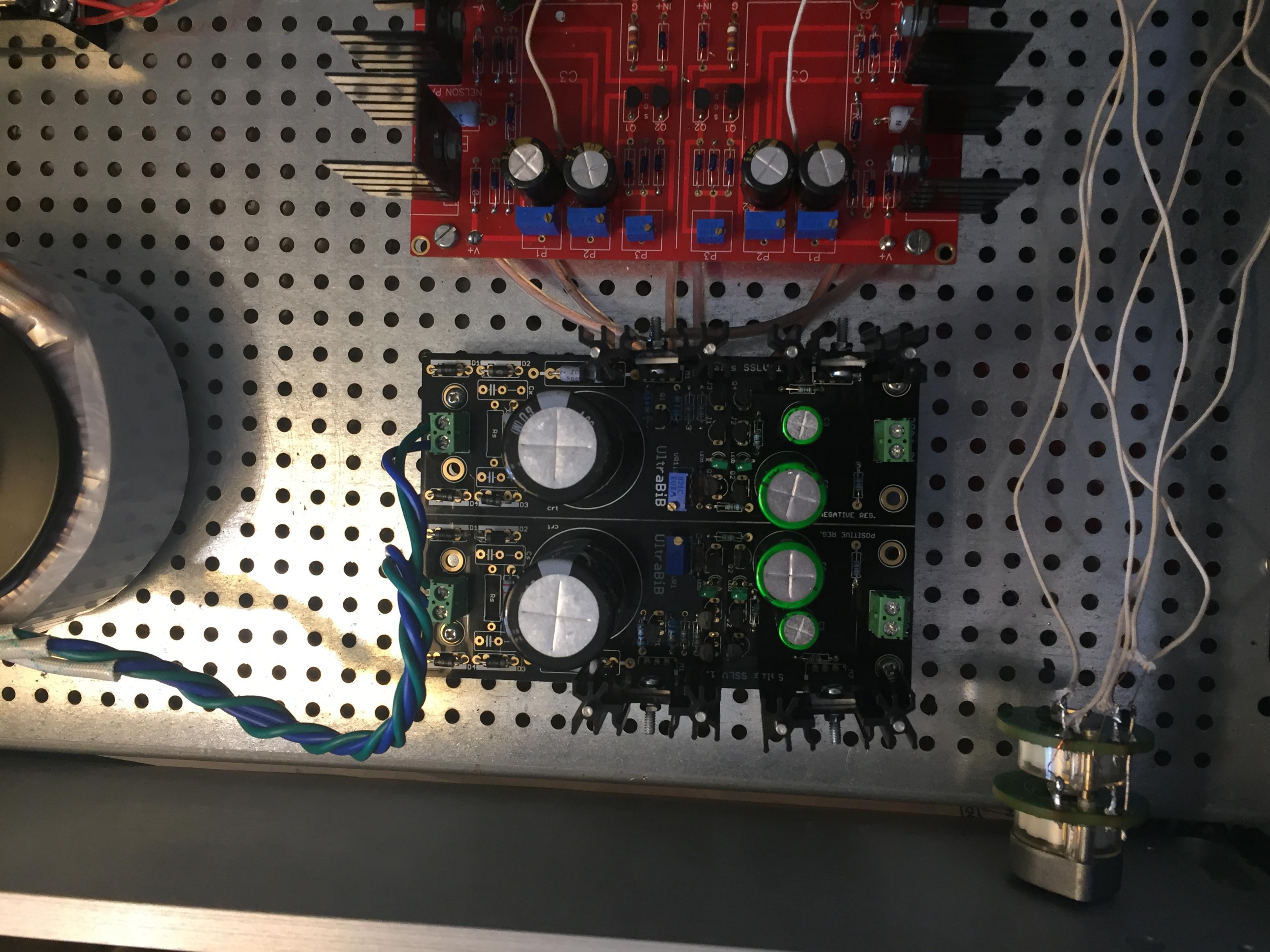

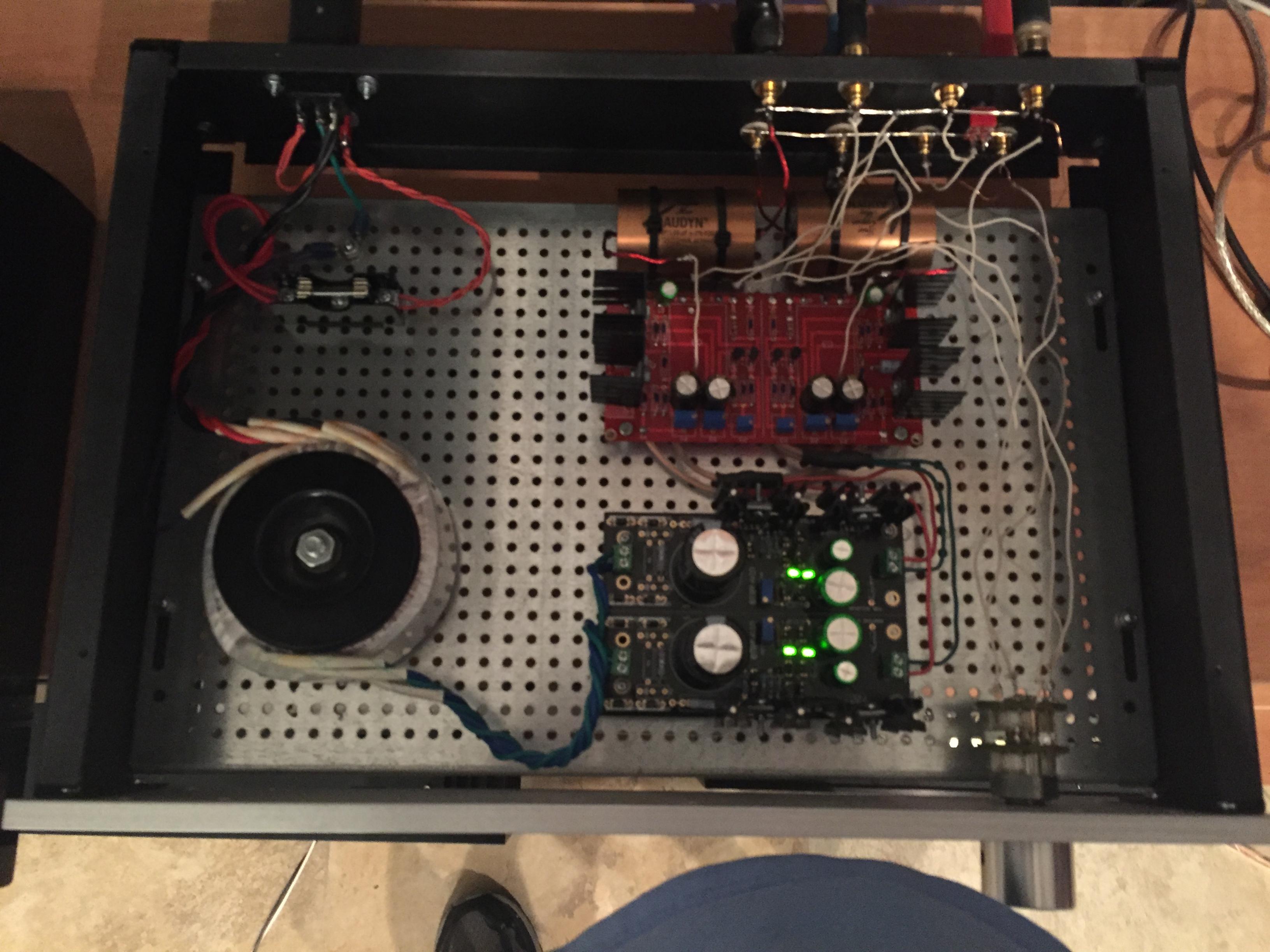

Check the leds, without desoldering them, with a battery in order to check the orientation and that are working properly first.
Oops indeed! No Rf means no continuity from the diodes bridge to the reservoir capacitor. Open circuit. Use a wire jumper at least for now if without Rf during the weekend.
Power supply working
Got 2 0.22ohms resistors for rf and everything is working fine. Adjusted voltages without load and after connection to load. Will check them later. It looks like soundstage is larger and more air, so far. Only 10 minutes playing!
