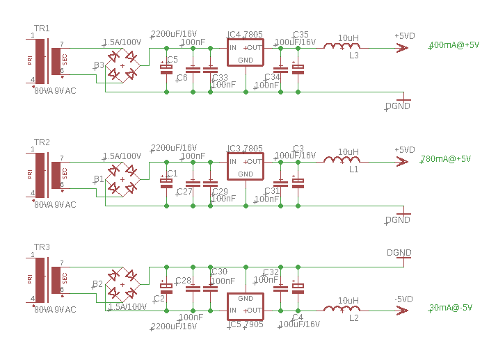

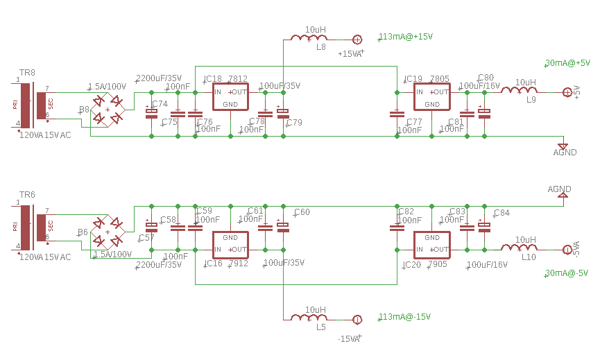

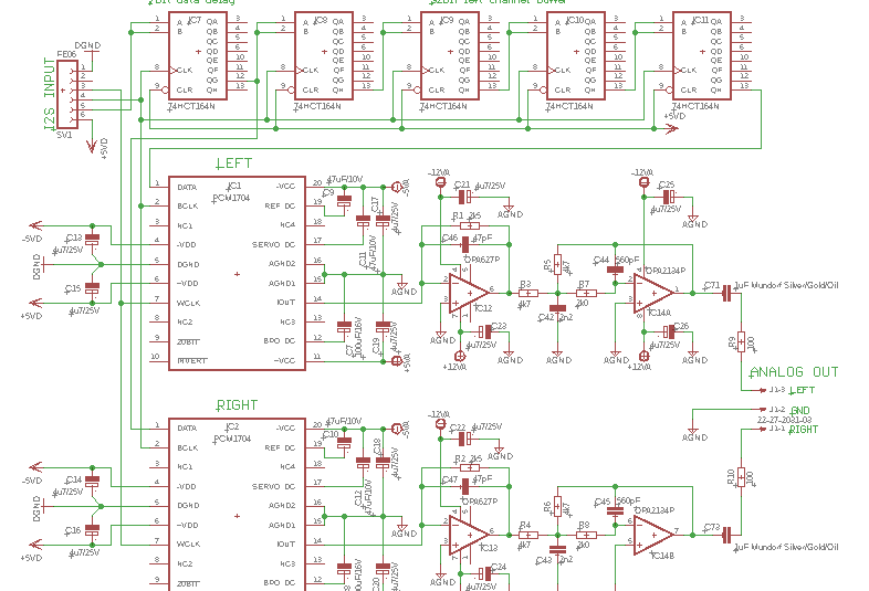

I tried to write total power dissipation of IC components which parts of PCM1704 DAC.Is SSLV1.3 UltraBiB ideal to change with these 78XX regulator circuits? For 5 different transformers with 7 UltraBiB are useful?..First regulator (400mA@+5VD) goes to USB/I2S conveter board.
Best Regards

The +/-15V part is a nice candidate for Ubib, its for the analog output section. Maybe the third Ubib from its breakable PCB for the USB/I2S. 7 Ubibs would take too much real estate. Mini Reflektors for the rest if insisting shunt or replacement 7805/7905 better chips/3 pin discrete compacts from ebay etc. And a custom order trafo with many secondaries for everything. Better don't tap on the +/-15V for the 30mA +/-5V as shown. Use secondaries and bridges+reservoir caps of their own.
Two BIBs and four Reflektor-D. Add four rectifiers/reservoir caps for the Reflektors and adequate heatsink. Let alone six secondaries, hopefully from three transformers.😱 It's going to be a big box!

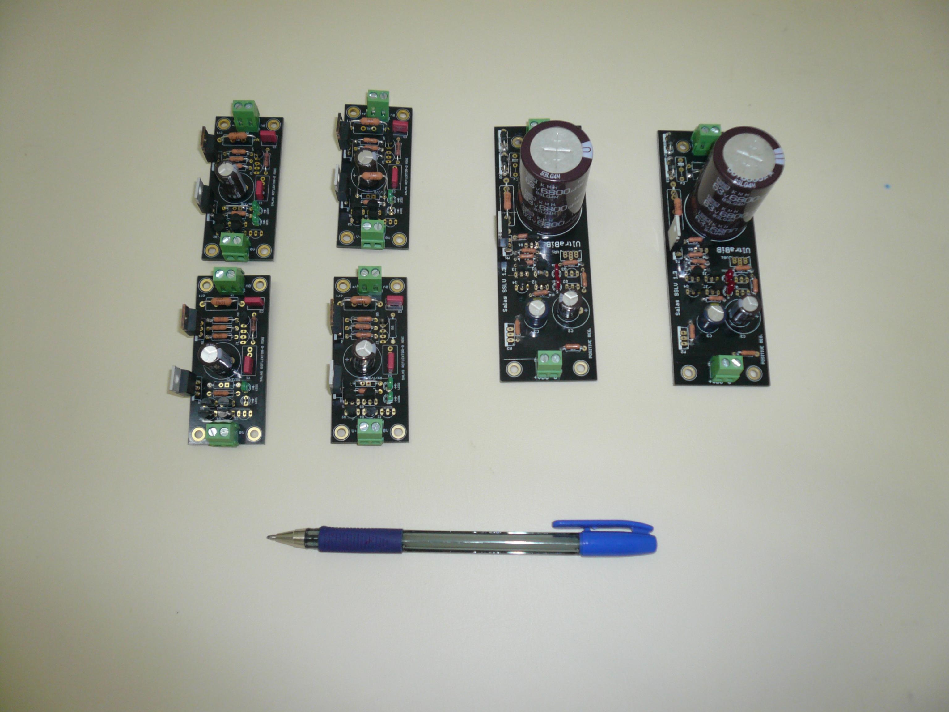

Looking at ways to minimise the footprint of four BIB's for the DCG3. Having them on edge means they will match the 160mm width of the amp board. All four will be mounted to a 4mm thick 130 x 160mm plate then to the chassis.
Trying a few left over BYW32 200V 2A rectifiers in these, they are very good diodes.

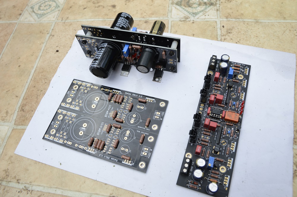

Finished assembly, no-load test... Nothing...Nada... Not working!
Even the LED's do not light up!
Data: This ps is for my ba-3 linestage, which I built with a Twisted Pear audio bipolar ps. So, the transformer is a toroidal 20-20 100va. Input voltage in the board is 20.6v
R1 3.3 ohm which was suggested by Salas.
The mosfets are as per BOM as specified for CC less than 1A
Also the regulators.
Checked and doubled checked solder joints and transistor labels to make sure they were positioned correctly, and it looks like they are. The jp.. transistors
are as per BOM.
The LED's are as per BOM, but I used the green ones and were positioned according to the A and K labels in the board.
And it is the same for both positive and negative boards. Obviously did something wrong. I'll check the led orientation again....Photo included.
Any suggestions will be appreciated. Thank you.
