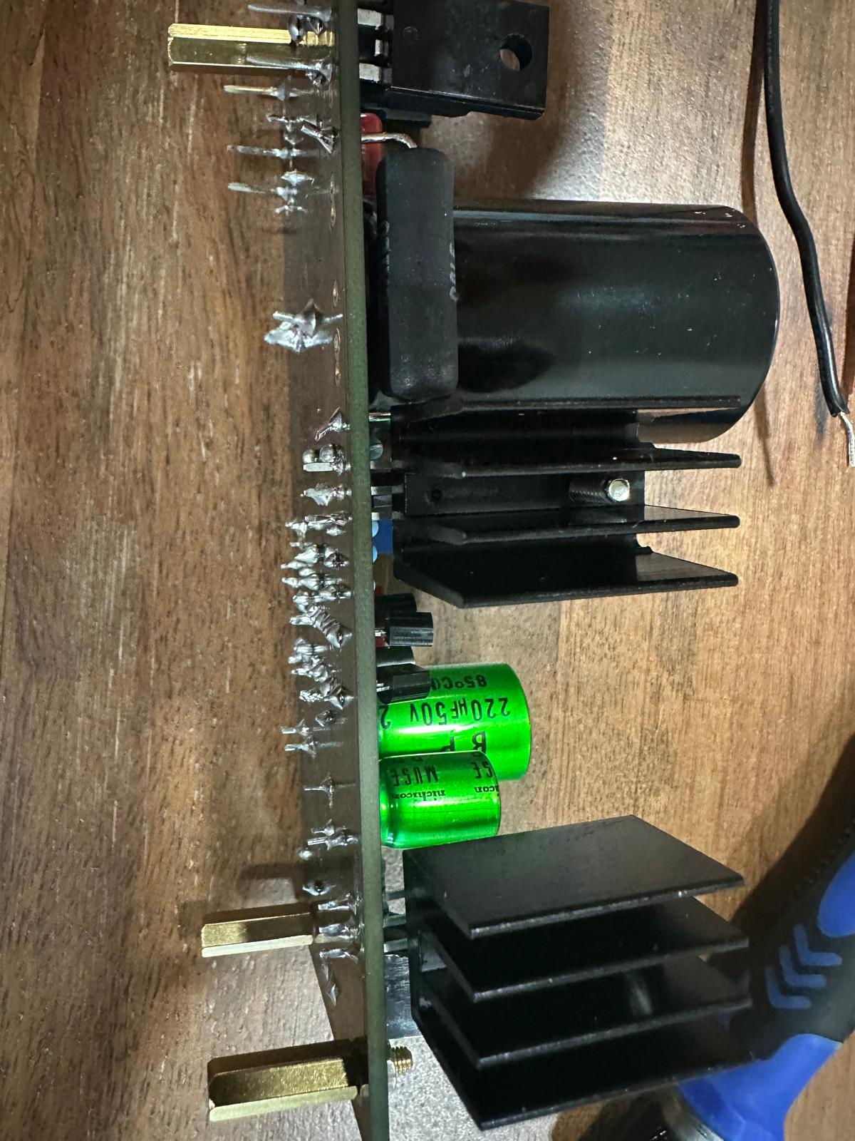

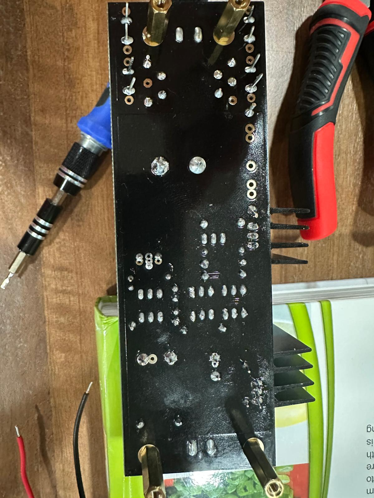

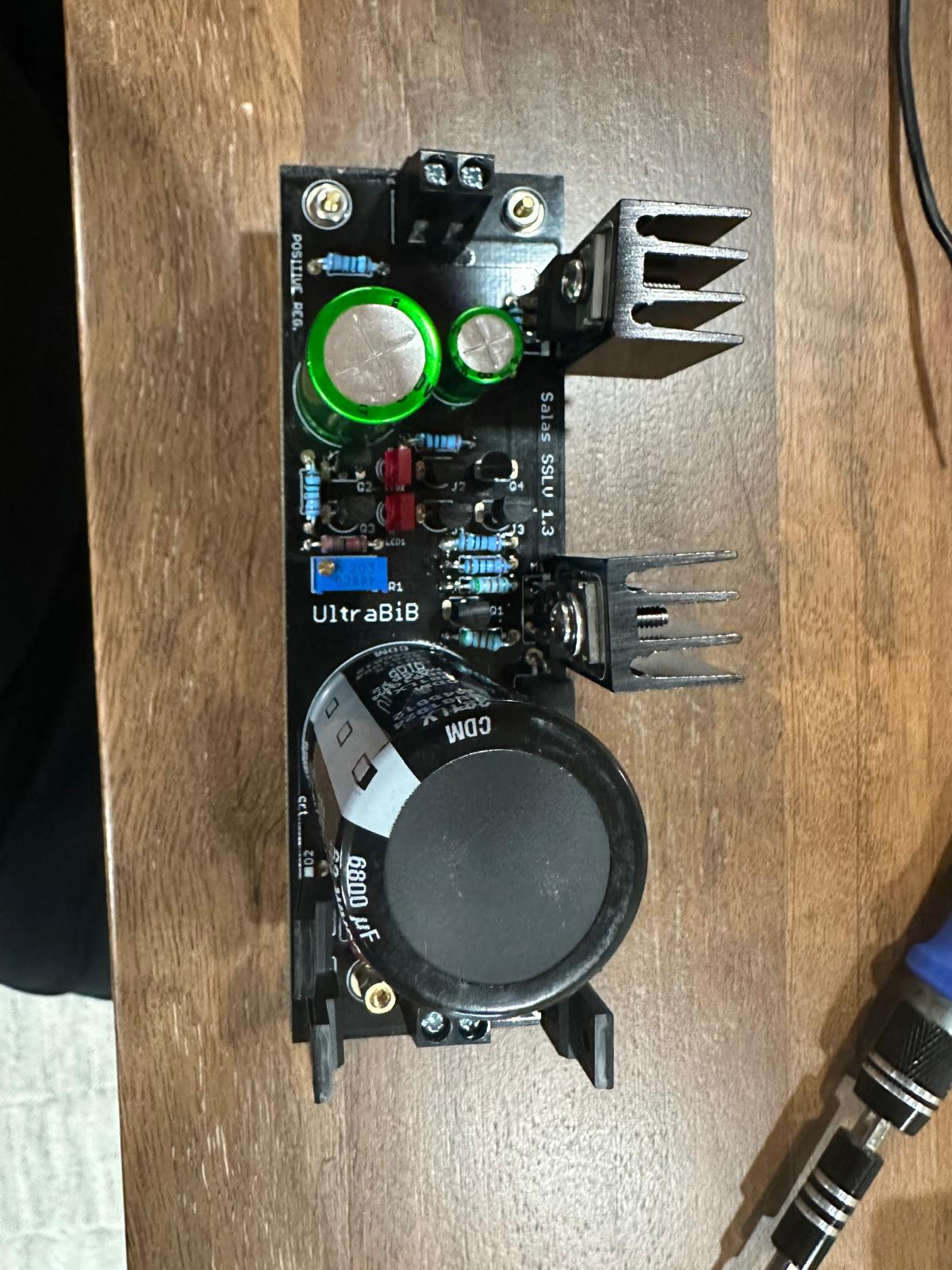

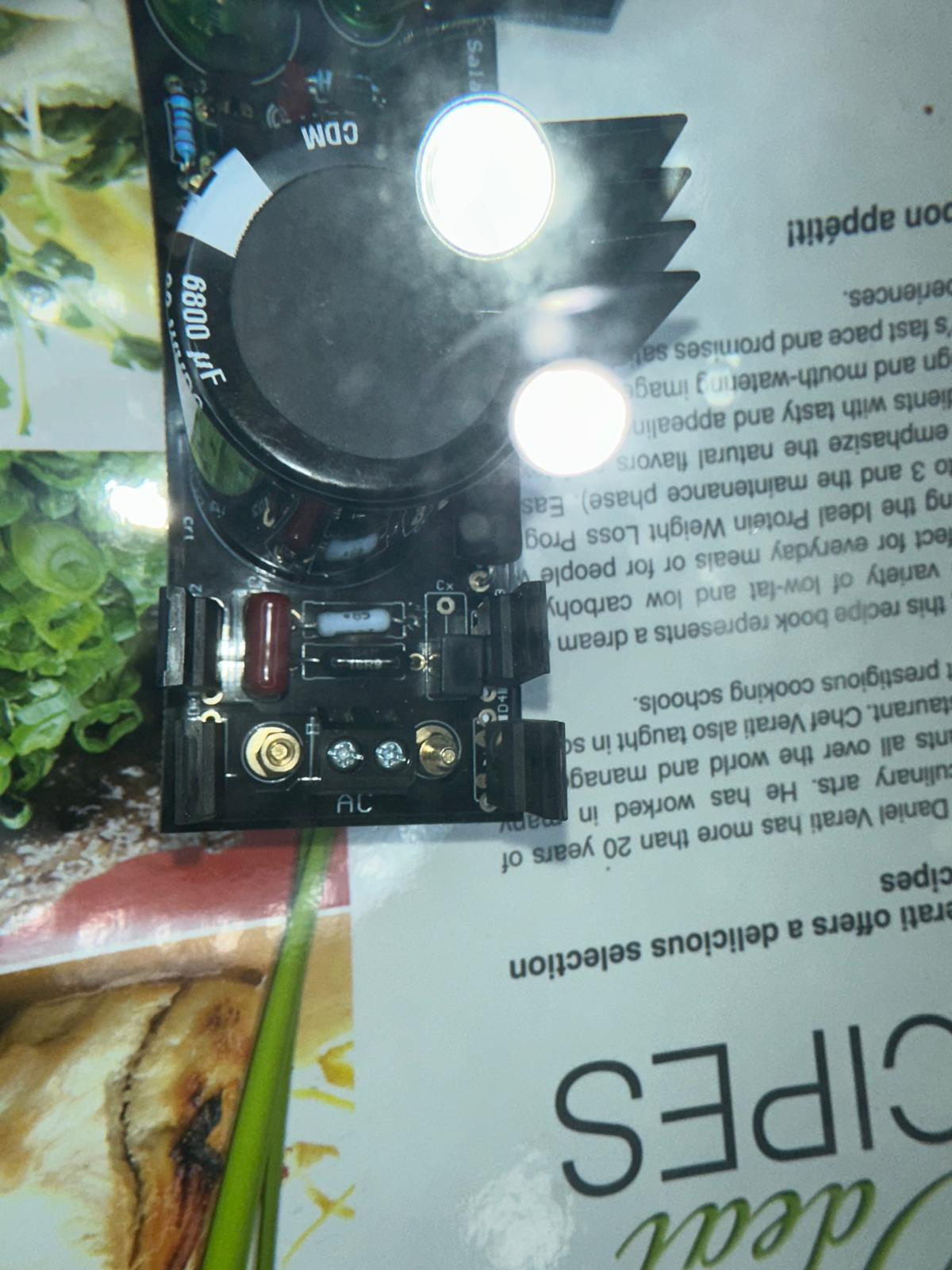

Hi All,
New DIYer and need some help. I'm trying to build a UBib with 12VDC output and 300mA output current. I did quasimodo testing of my transformer Hammond 1182M15 and my Cx =0.01uF , Cs=.15uF and Rs = 16.9Ohms. I'm using https://www.mouser.com/ProductDetail/279-H4P16R9DZA as my Rs. When for R1 I'm using 2Ohms 5Watt 5% resistor.
When I turned on the power there was a loud spark. Looking closely at the board i see some blackening between Rs and Rf. Maybe one of the resistors snapped? How should i proceed to debug? Here are somepic of the project
Hi, measure the rectification diodes using the DMM's diode check mode. For a start because those sit between Rs and Rf.
Your R1 2 Ω is good for 0.29-0.3A CCS setting, if the load is 0.3A leaves no spare current in the reg for proper function.
Check that M1 M2 Mosfet types have not been mixed for position. Clean board flux, redo any joints looking not shiny/dry.
Tiny sinks for a Ubib you put, they will be unusable hot when it will be fixed, especially for 0.3A work.
Hello, so I checked, M2 and one of the leds are screwed. On the other hand I only watched Q2 and it's ok but is it better that I check the others?Hi, IRF610PBF should substitute FQP3N30. The LEDs or M2 or JFETs are seldomly reported broken, but you can check.

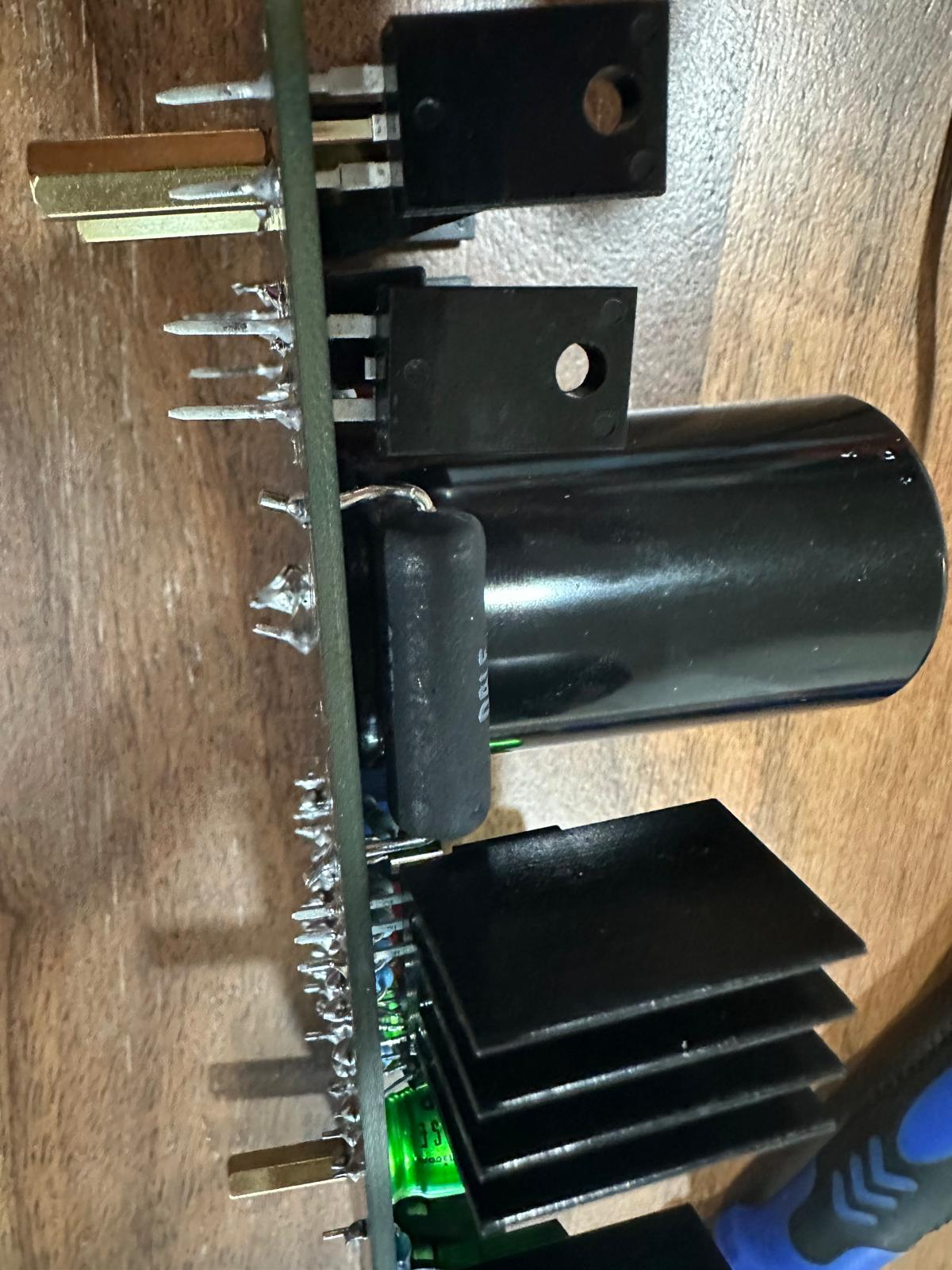

@Salas could you suggest some heat sinks for this project.
Largish common sink, needs to drill and tap, something relatively cheap like this: 120mm Amazon heatsink
Use insulation pads and nylon grommets for the Mosfets.
