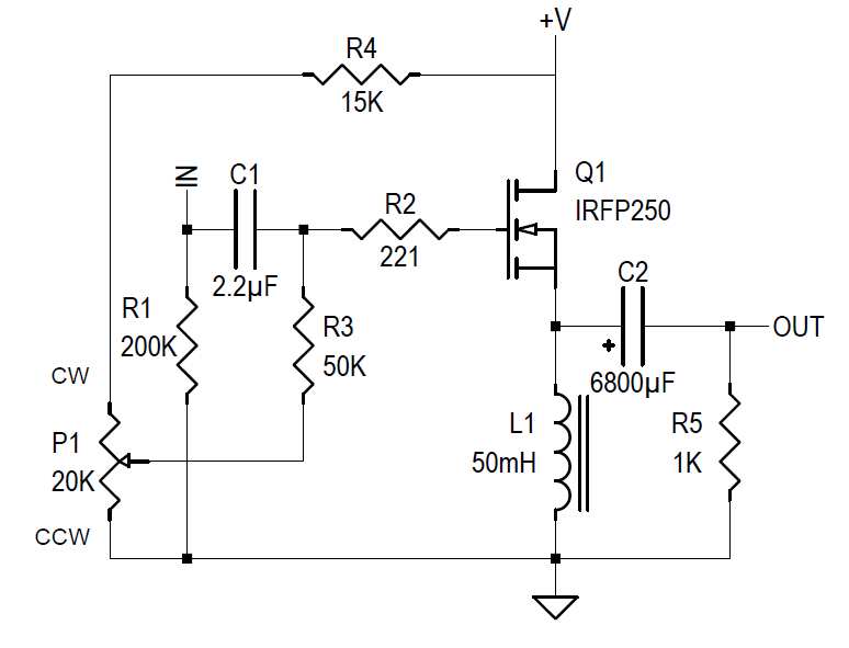

the Mofo is an amp source follower in class A that has no gain and is loaded by a large inductance on the source. The maximum current is set at 2.5A and B + 24V.How much is the peak to peak current that amp will ask for max signal output?
the schematic in attachement
Anyways with IRF9640 M1 & IRF640 M2 it may do it. The burden is on M1 that will burn the voltage drop across the reg times the CCS setting constantly. That will be 15W if set at 3A assuming 5VDC across. M2 has it better with a high bias Class A amp as load because it will just burn the excess while the amp will pull the heavy part. You will see the reg's LEDS blink if the CCS is set low for the amp's needs with some speaker on peaks. Start with R1 0.22R 5W for circa 2.7A CC. Use a sink for M1 & M2 that will be at ease with at least 20W constantly.

Watch where the main current goes when you will be setting it up though. You would either need a 100W 10R dummy load (sinked power resistor) or the amp itself hooked up because 65W will dissipate on M2 (24V @ 2.7A) frying it if there is no way out for the bulk of that bias!

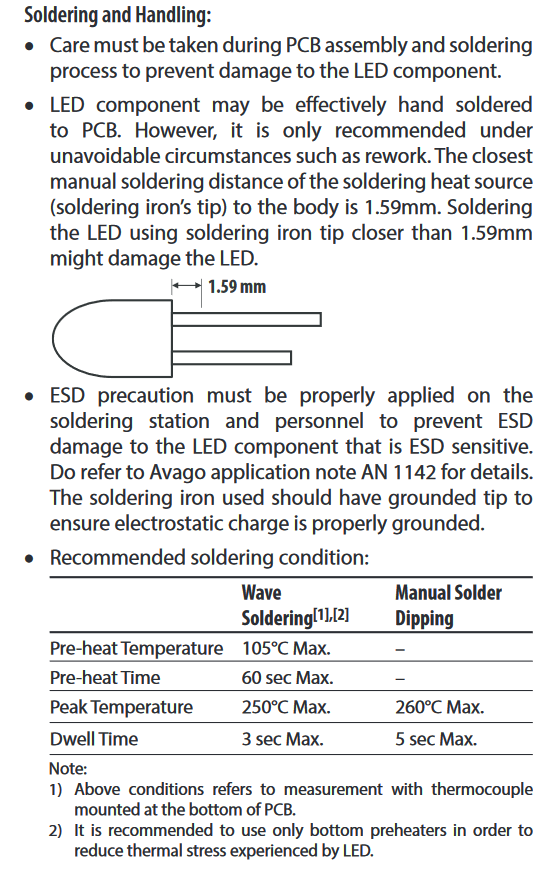

Alright. In the precautions section it says not to manually solder that type any closer than 1.59mm to its body. So populate it bit proud above the PCB. The FR4 is thick enough but some solder will flow to the upper side also through the plated holes.
http://www.farnell.com/datasheets/1918234.pdf

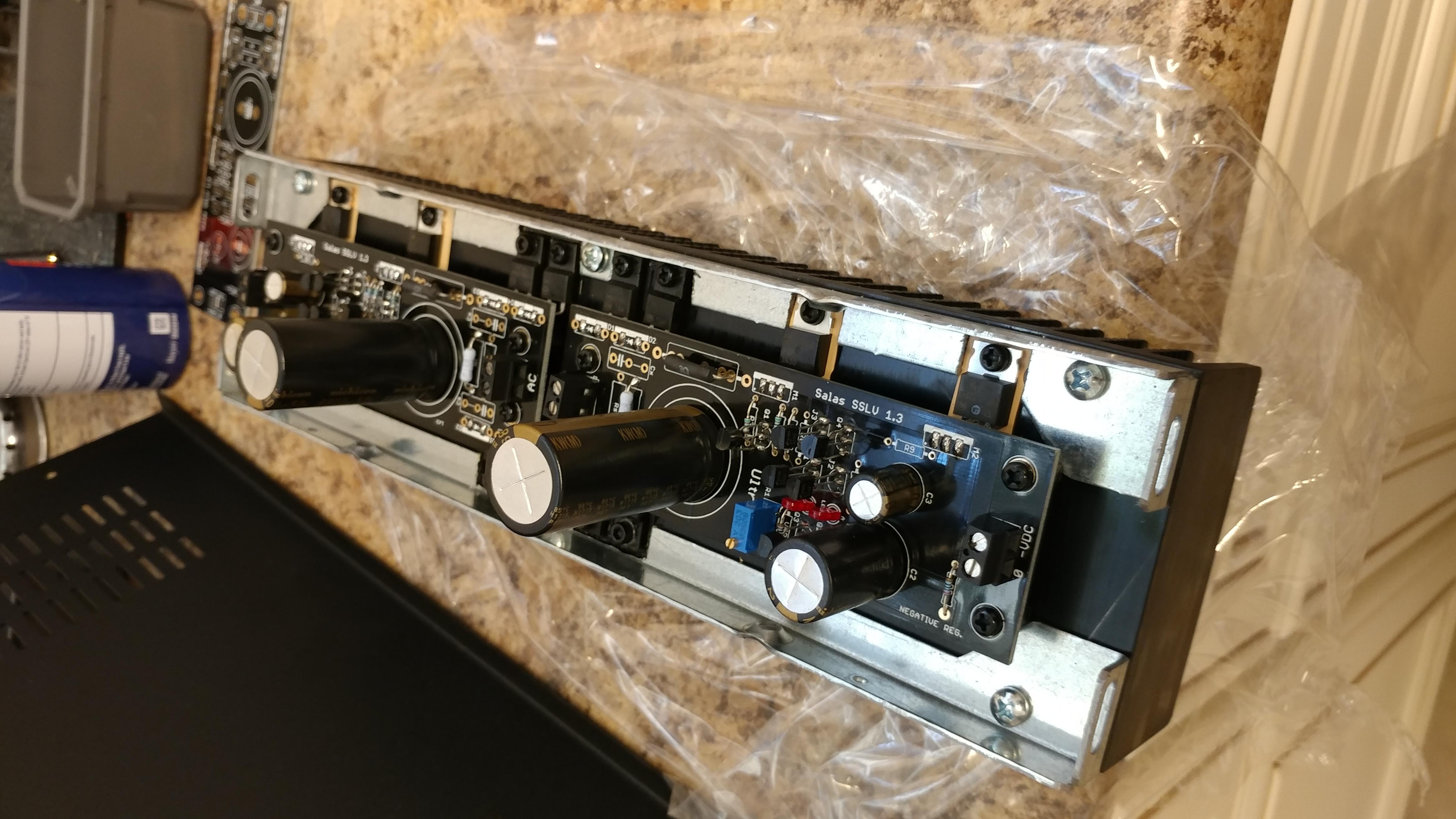

Salas/Tea,
Received the minis and boards Thursday, and Ive been busy!
Greg
Hi Greg,
First time I see a final PCB issue Ultra assembled. Looking cool in black. Well arranged, congrats. My two GB grade PCBs left America June 22.
P.S. Why R8 & R9 are missing?
