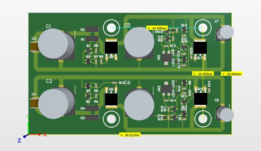

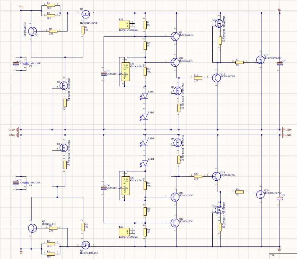

Hello,
I have a UGS muse preamp that I use with some Salas SSLV1.3 UltraBiB regulators and the sound coming out is very nice. The pcbs for the regs were drawn by a member for the group buy.
Each channel of the preamp draws 150ma per rail at 28V thus I set the ccs for 250ma leaving 100ma spare for the shunt. I have also 6v that I drop on each ccs. All this sums up as a lot of heat and big heatsinks are required. The preamp will be hosted in the next future in a modushop 2u enclosure that is entirely in aluminium. Each side panel of the enclosure has 2 cuts, as long as the panel is, having 45mm between them.
I thought to use the side panels as heatsinks and to mount the regulators directly on them.
Now I have 2 possibilities, one is to use a classic fr4 pcb and through hole mosfets or use an aluminium pcb and smd to-252 mosfets. The second option seemed more interesting to build and I started drawing a pcb but I came to a point that I want to ask for some help.
What smd to252 mosfets do you think would be best suited for this? Any other components that you suggest replacing?
Where is better to join the gnd, on the preamp pcb or on the reg pcb?
Hi, if it was me I would go for the first option since the GB layout and BOM's through hole Mosfets are a tried and tested combo. If you will go for the 2nd option, I can't tell about what SMD TO-252 more than try to select close gfs, Ciss, Crss, to the original TH types specs. Which differ for M1 and M2. Better to join the ground at the reg PCB since its not a Kelvin output.
