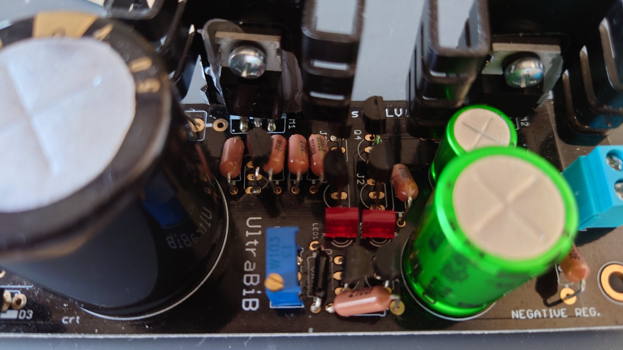

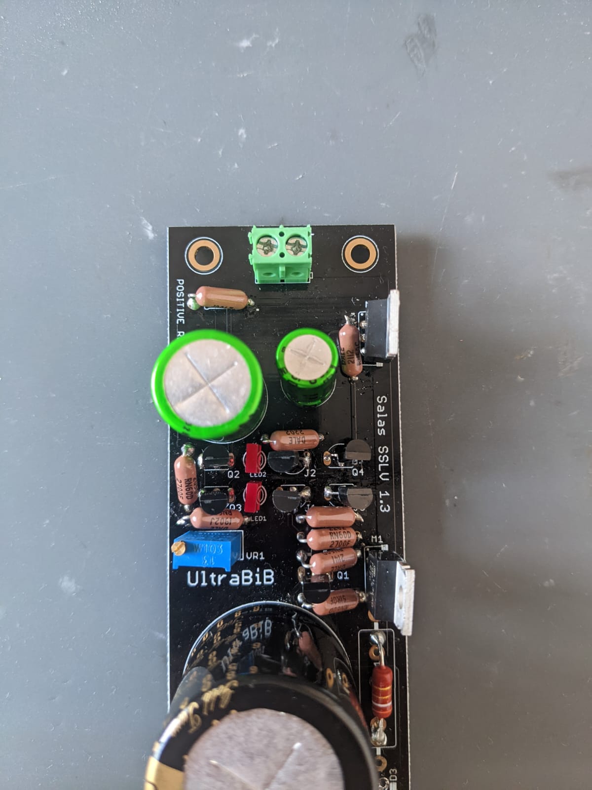

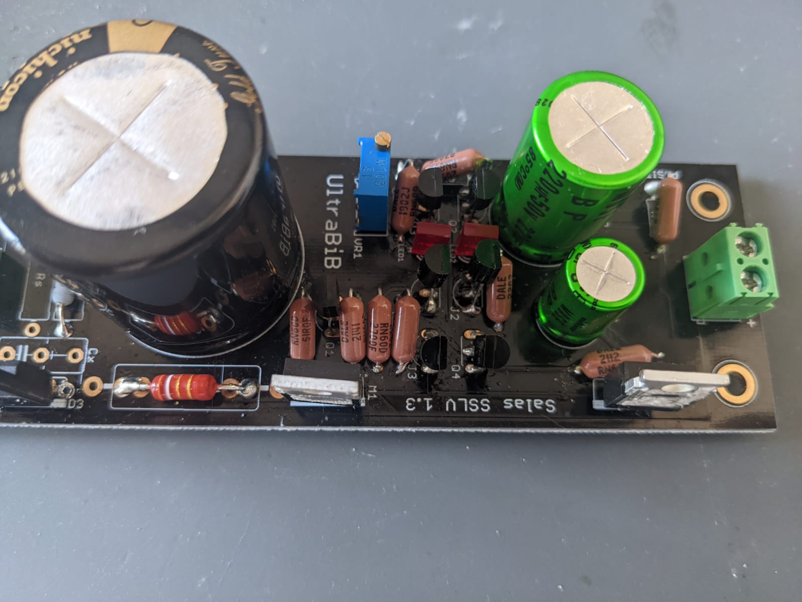

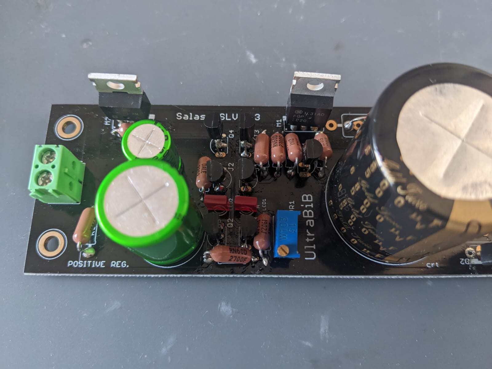

Hello. I'm having some problems with making these boards working. My knowledge is very limited, but I'm really trying my best.
I've build two sets of boards, but I lay two of them work as intended, thanks to this message I've narrowed the problem a bit. My IRF MOSFET only measures 0.58 between legs, the MOSFET itself was provided by the group buy, so I assume is legit. Where should I look to find the origin of the problem?
One thing I did wrong when buying the resistors is that I bought dale rn60d but they are physically bigger than the room for them on the board. Is that important?
The boards not working output 1.4x volts both positive and negative. (One of them outputs nothing, but I will leave that one for later) and also leds do not work
Also is there a book/webpage I can read in order to understand power supplies better? I don't intend to be and expert by any means but at least to know what I'm doing because I have no clue as to where to look when there is a problem.
I have already built a whammy, a dam 1121 and another couple of headphone amps, but this is proving to be a challenge.
Thanks in advance for any help.
Of course! This is the one I've been tinkering with. I've already changed the trimmer because it didn't changed the resistance when turning it, but it made little difference.

Hi, because the brown resistors are big* for this board, curving thick legs creating tensions, the soldering has blobs and I am suspicious of sneaky cold or buried no continuity spots. Especially between layers via eyelets. Two other sections assembly had worked for you while using the same kind of active and passive parts? Have you verified circuit continuity vs the schematic with the DMM's continuity mode buzzer?
*RN60 values selection set from Israel?
0.58V is legit only as Q1 Vbe between its pins 2 & 3 or across R1. Those are same points electrically because R2 does not drop practical voltage. M1 FQP between its outer pins reaches over 4V when properly conducting in this circuit and IRF M2 3V or more.
Yes, two other sections where built and they work fine. All active and passive components are the same across al boards (I´ve spent quite some time reviewing every part is correct and it´s where it should be)
I haven´t verified continuity, but sounds like something I can do this evening.
I dont´understand the (*) I ordered RN60 from Spain but I´m not sure where Mouser shipped them from.

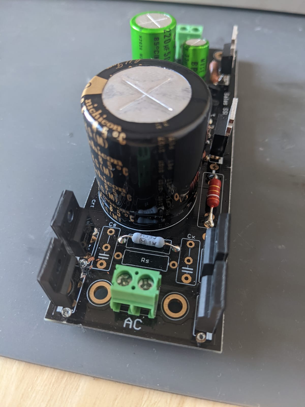

""I am suspicious of sneaky cold or buried no continuity spots"" this you say makes sense to me. Another thing that happend is that I marked a third section (a negative one) as "working" but the following day it wasn´t working anymore. Could this be cause by that? Also while I was soldering, the tin was not flowing properly to the front side of the board properly. While doing it I wasn´t sure wether this was normal or not, but I feel it isn´t normal as I read more about how to solder.
The board on the pictures from yesterday was resoldered from above trying to "fill the gaps" I will attach a pic of one of the boards that hasn´t been touched since I soldered it the first time so you can see better hoy I soldered it the first time. In the pic I see that the "holes" on the transistors are more or less filled, but on the resistors the seem to be empty, am I correct in that observation? is that because of the resistor being too big (and me not having very good skills) isn´t it?
Oh and 0.58v was measured on the outer legs of the IRF mosfet, which shouldn´t be the case. I didn´t explan myself properly on the first message.
It´s looking more and more like I will have to replace the resistors? That is going to take some time, but it´s the cost to learn 🙂 so It´s ok.
Thanks a lot
(*) There was a popular ebay seller of legit RN60s that you could pick values for a nice price. I wondered why not the easier to fit 1/4W type that is why I asked if you got them from there.
If for cold solder joints, sneaky problems may occur. Since two other sections had worked with the same parts it could be an assembly issue or static discharge could have compromised some Mosfets during handling and soldering. Turn up the temperature of your soldering iron for this board if it has such a facility. Or use a fatter chisel type tip.
Some half filled pads can look suspicious but not the culprit and another good looking joint maybe has the bug in the end. Best to test electrically.
Try to see if continuity testing will verify all connections vs the schematics. Because it will be frustrating to remove components from a dual layer thick copper board just on suspicion if without a vacuum desoldering station. If continuity shows nothing wrong, try to remove M1 & M2 and see if they are good. M1 first. Do you have a component tester? Else there are guides on how to test Mosfets with just a DMM if you Google it up. You don't need to remove the resistors if they are doing the job and have verified circuit connections. But do check if there's a wrong resistor value systematically misplaced somewhere in the non working assemblies. The RN60s have large value code print but also use Ohmeter when in doubt.
