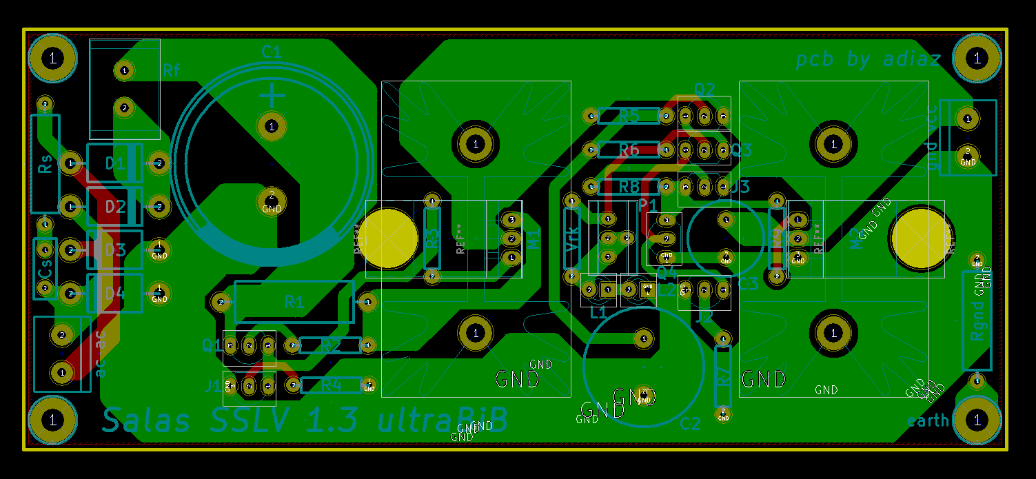

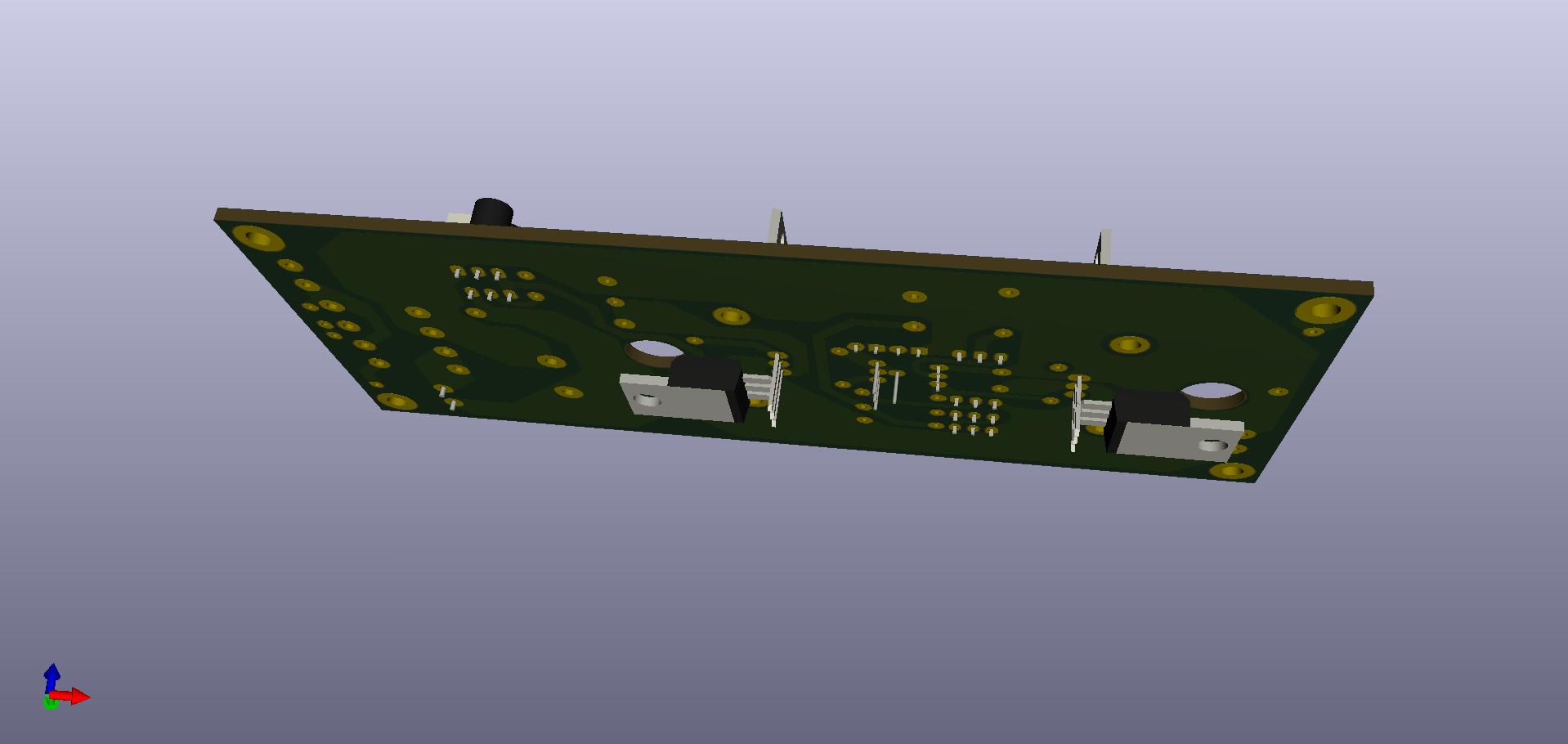

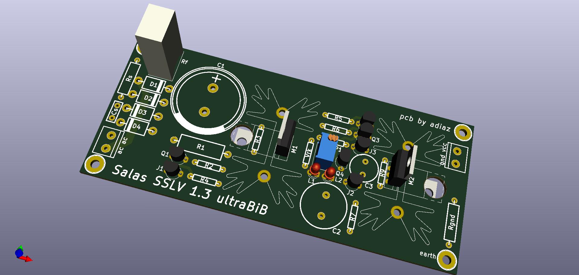

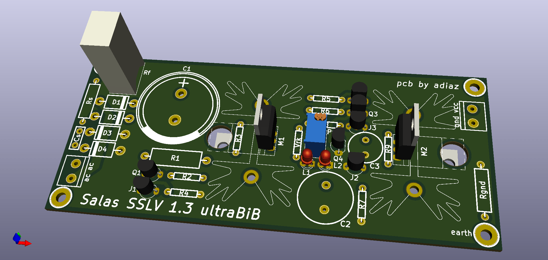

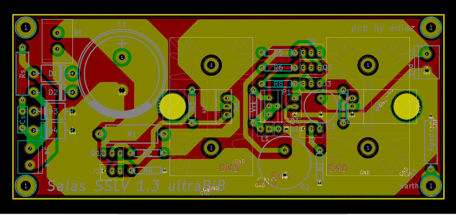

My pcb design is finished. I did it to be able to mount the mosfets on SK129-STS heatsinks or also mount them on the bottom of the box if it is aluminum. Both options available.
Rectifier diodes can be mounted from MUR220 to MUR460. Capacitors C2 and C3 are Nichicon muse BP ES, for 220uF/50v and 47uF/50v.
Next I will send to manufacture JLCPCB...
