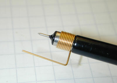

I am sure that the actual noise of ubib 1.3 is even lower than what I have measured with my oscilloscope probes.
In any case, with the measurements and tests that I have carried out on this ubib 1.3, they have far exceeded my expectations, I am very satisfied.
