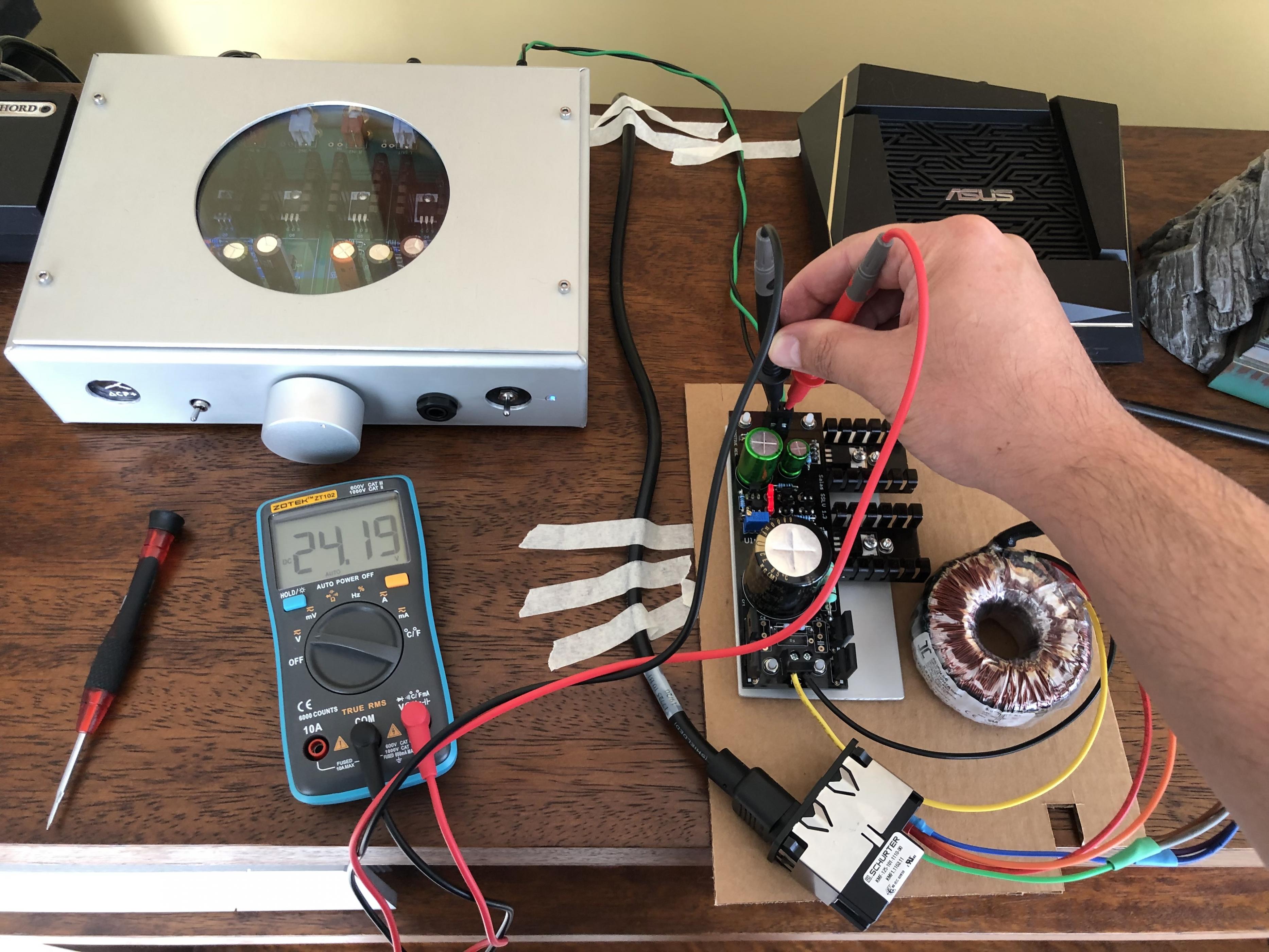

Yes, you are right. It still works fine now the dac board is repaired!

Yes, replacing Q2 did the trick, nothing else needed changing. Unfortunately, I had to canibalice my yet-to-be-built bi-polar PSU that i will build with the other 2 PCBs and, as Murphy will have it, with the one obsolete and non stocked Transistor! LOL! I’ll order a few BC559B (not sure why is the B the replacement for the C) with my next Mouser order. I take it they are a direct replacement as long as Vout < 30V.
I still have a few things to sort out, my drift is quite considerable, about a full volt. So I need to ask if the ACP+ Can tolerate the extra voltage on startup or if i am better not overshooting and then living with a lower Vout.

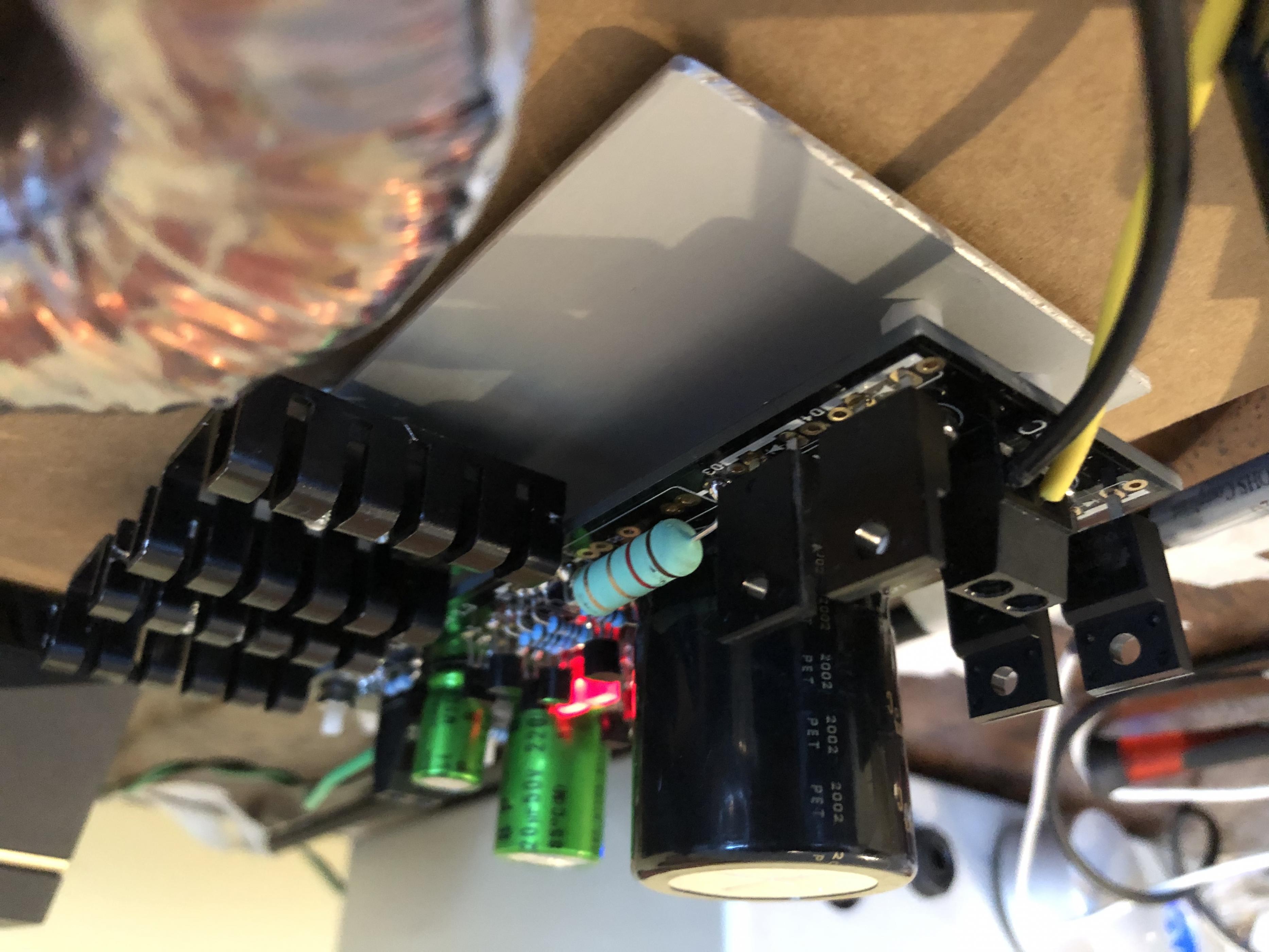

The other thing, and here I’d like some suggestions: I put individual heat sinks on the Ms, M1 is cooking at 80°C on the MOSFET metal next to the bolt. Heat sink is at 67°C, so there is good transmission of heat, perhaps a bit smaller than needed. M2 is a bit cooler at 68°C.
They are far from the operating range of 150°C, but this is with open case. So I may need to put a thick aluminum plate beneath the heat sinks. They are “floating” some 5mm above the base. Or is 80 reasonably enough?
I’m attaching some pics, more to say thanks! For what is worth, my “troubles” were of my own making and not at all a problem with the kit, which is superb!

Congratulations for fixing it. Your now sinks are surely tiny, definitely more substantial sinking is needed for your app. Higher temps are generally eating away electronics lifetime even when away from an imminent destruction limit. They possibly contribute to your now drift level as well. BC5xxB variation has less Hfe than C but still adequate. C was out of stock then. When C is stocked prefer C.

For me, this matches perfectly the behavior I saw. This math in my case:M1disW=(Vin-Vout)*Iccs
M2disW=Vout*(Iccs-Iload)
M1: 5W
M2: 3.2W
Perhaps for 24V I should have opted for a 22V secondaries transformer instead of the 24V one, but not sure if those are too common, the ones I could purchase in Mouser jumped from 18V to 24V, so that's it.
5W + 3.2W of dissipation for me, which gives me about 60° over ambient with those heatsinks. Yeah, I'll add more dissipation. I'll keep those, and bolt them to a large aluminum bar that would be heatsinked to the chassis itself. Let's see. Had I known this, I would have probably mounted them vertically and try to secure a "vertical" heatsink. As is, I will need to get creative.

5VDC vin-vout at least is good to have. In your case that would give 0.577V/1.2R=0.48A. 5V*0.48A=2.4W. Why you burn 5W on M1? You have 34V rectified with that transfo?
Sorry, yeah, I copied something wrong apparently.
Still: 24V transformer. I did measure a little more RMS than that, but I'm sure that the rectified voltage after the diodes is 31V. Output is 24V. Iccs is, according to the PDF, 600 / R1: 500mA. You have a 'tighter' number on those .577V.
So: M1 W = (31V - 24V) * 0.5 = 3.5W
For sure, my M1 runs considerably hotter than M2, so for sure it has to be dissipating more than M2. I don't know. 3.5W makes more sense? I don't think its 2.4W, that would be much cooler, even according to the heatsink datasheets.

3.5W makes more sense. 24VAC Tx when including diode losses can give around 31VDC indeed. 7V in-out is good on M1 as it keeps its internal capacitance low enough. I used 0.577V to calculate Iccs because you mentioned 577mV drop across your R1 in a previous post.

I believe you will make it significantly better. R1 drop probably wasn't affected even when Q2 was blown, but you can remeasure R1 drop now you fixed the reg to confirm. To be positively accurate when you calculate dissipation.
