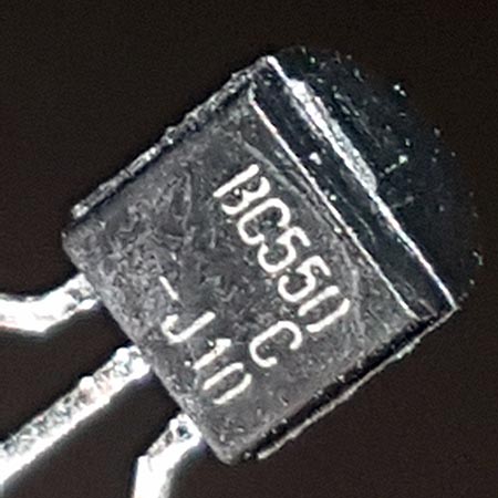

Hi guys, I'm pretty excited to try UltraBiB with my DAC. Today I started to solder, it's almost done. Besides the PCBs, I also got a set of elements. Everything looks good... except this:
Matt, irregular surface like in some... non-original specimens, I'm not sure about it.
Do you know this brand, can it be safely mounted?
Those are Fairchild factory markings. The excess flashing is a feature adopted by Fairchild shortly before being acquired by Onsemi... It could be you got one from a late batch showing advanced wear of the epoxy mold.

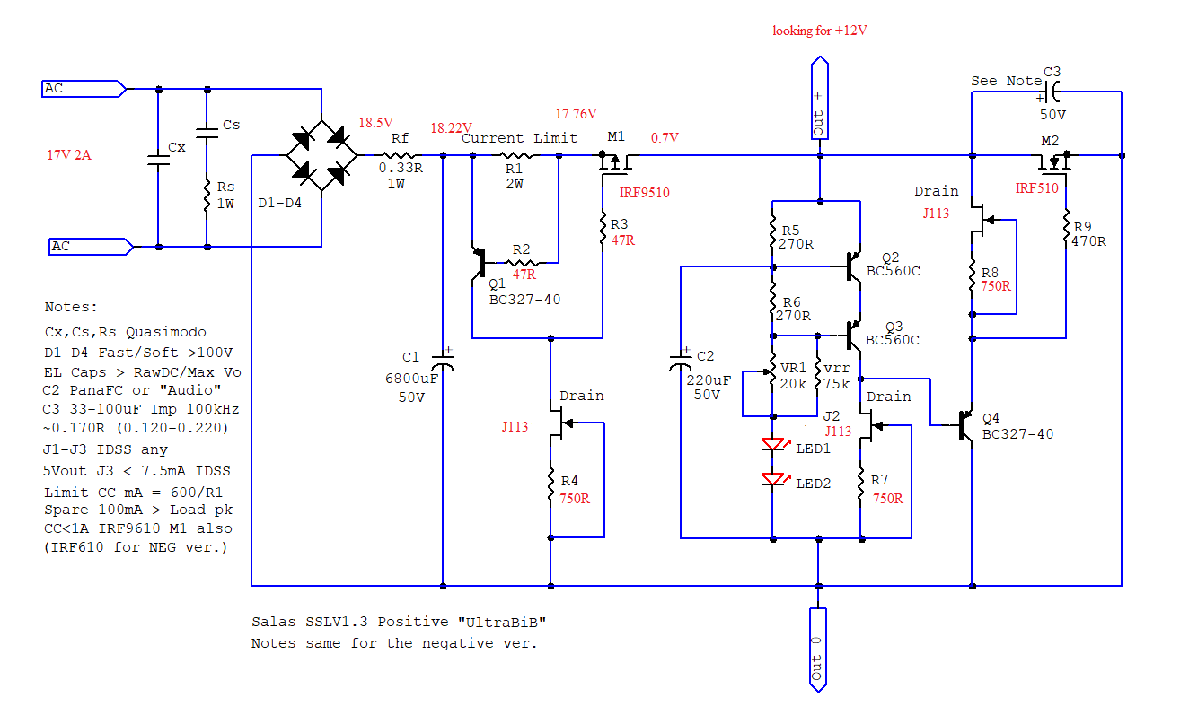

Looking for help with positive version. PCBs are home made, but I cannot get any Vout.
I've attached a schematic with voltages.
All componentes are from Mouser. I used J113 with 20mA Idss and 750R source resistors. Mosfets are IRF9510 and IRF510.
CCS works and I have 1A and that is GOOD! But no Vout and obviously, LED's don't power on.
Trimmer is set to 1.3k ohm, for now, with that values it should be below 12Vout.
Where should I start? Any ideas?

I have managed to sort out the power supply, the guy who made PCB swapped IRF510 D and S 😀
Now, only one thing remains, I can't get more than 7V out. Any ideas where to look?

Another update. With trimmer 100K and if I set it to 28K I get 8.2Vout.
Maybe something with JFET and source resistors or? Maybe I can set 12Vout with trimmer set to 100K, but I don't know if this is OK?
Regards
Edit:
If I open the trimmer too much, Vin becomes Vout, so, regulator and CCS, they shut down. Just an info for easier debugging.
You can find if the JFETs work for enough local bias current by the voltage drop across each 750R. 1-2mA is normal. Also check Vbe in each BC transistor. You would want 0.55-0.65V. 5K trimmer won't take you as high as expected without enough Vbe across R5 and R6.
If no more DC domain explanation bugs will be discovered, its also possible that using IRF510 as output Mosfet brings very high frequency oscillation. Such a bad AC domain situation could stick the DC adjustment as well. Check the input and output power rails with a scope in AC coupled probe mode. Start from 5mV/50uS vertical/horizontal scale settings.
JFETs are at 1.5mA - 1.7mA. 1.16V to 1.3V across 750R. I can lower to 560R if you think it would help?
I think I have IRF640? Would it be better choice than IRF510?
No, you don't need to lower the 750R. To the contrary that suggested R degeneration value worked very well for 1-2mA ballpark with the wild IDSS ranging J113 and it biases the BC transistors as expected. IRF640 has better stability prospects for M2 job than IRF510 in this circuit. But do not go for M2 before you establish Q2 Q3 work as expected for Vbe at least.
Ok, will do that. I will measure Q2 & Q3 Vbe.
Will report back.
Q2 Q3 Vbe is "printed" across R5 R6. That creates a drop across them and a current to "drive" the Vout trimmer and the two Leds. Vtrim+VLeds+2Vbe = Vout.
I replaced Q2 and Q3 and IRF510 with IRF640 and now I have 12.4Vout, I can regulated output voltage just fine. Thanks for your help. If I will need more help, I will report here.
