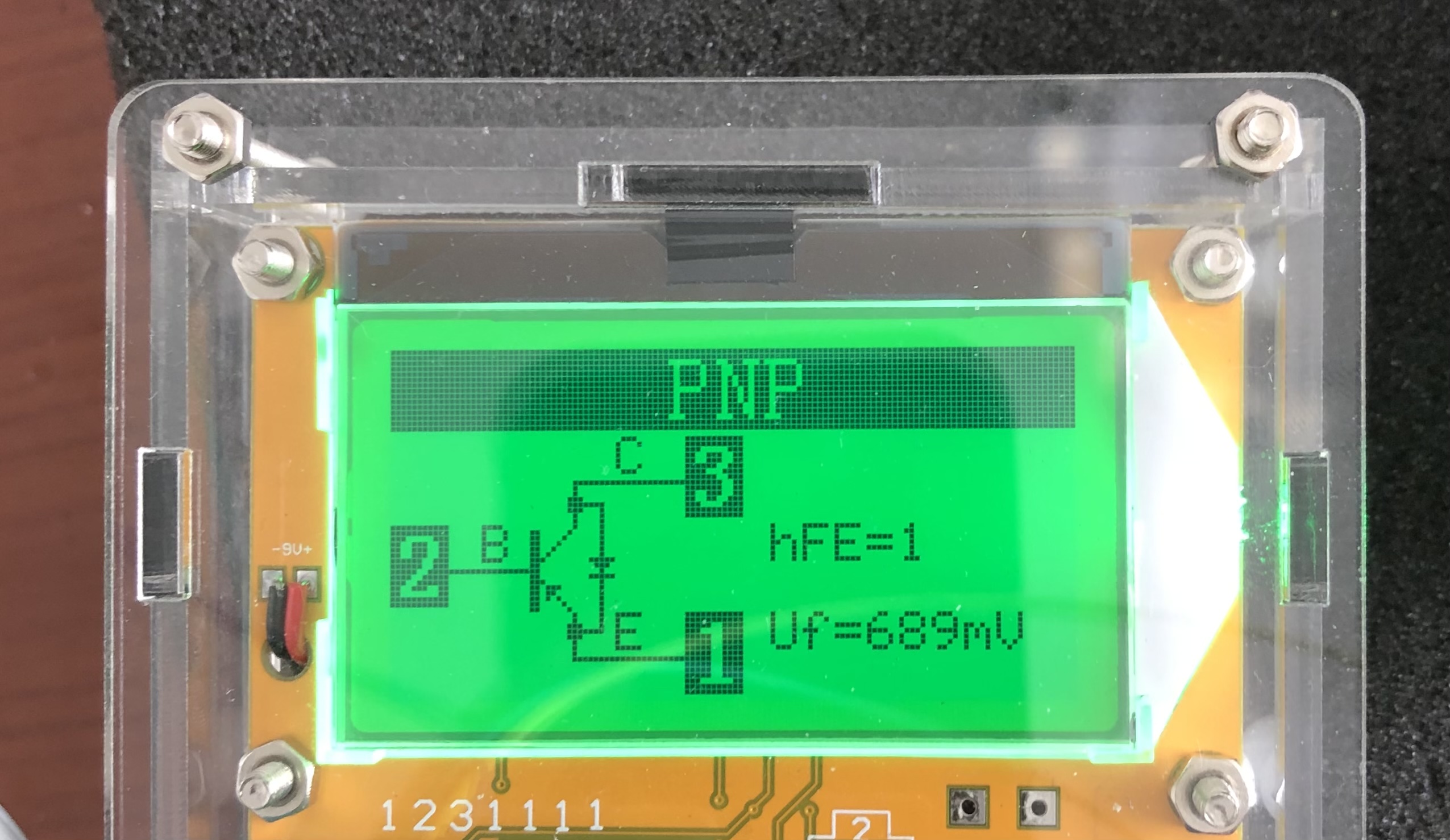

Good evening friends. I write saddened with a half-working PSU.
I'll write here the configuration, then behaviors before and after it started failing, then provide some voltages in the hope that someone could help me navigate and find the error.
Thanks so much in advance!!!

During no load condition all constant current produced from M1 goes to ground through M2 only. M2 gets heat stressed because it dissipates W=Vout*Iccs without Iload share. If its an output short M1 gets all the stress (W=Vin*Iccs) because Vout=0V.
But in your measurements their Vgs still looks normal afterwards (M1 6V M2 3.56V). Thanks to set Iccs current limit M1 can't pass current up to the bridge diodes and transformer limit until something breaks.
First look if Q2 got hit and has wrong Vbe much away from 0.6V. If its too small it can't provide the Vref branch with enough current to reach 24V as it did before the mishap. Also look if Rf & R1 still read as their nominal values.
Thanks so much for the quick reply. Yes, Q2 appears to be fried... it reads as a 3 Ohm resistor in the part tester. The multimeter in diode testing mode reads 3.5v even between the "wrong" legs that should not allow current.

This is what Q3 look like in-circuit, without Q2 installed. No exactly “right”, but better than the 3 Ohm resistor that Q2 reads (out of circuit).
Should I go through the hassle of removing Q3 to measure it outside the circuit? Should I measure Vbe with the multimeter? Or is this good enough?
