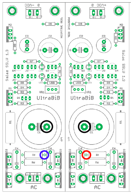

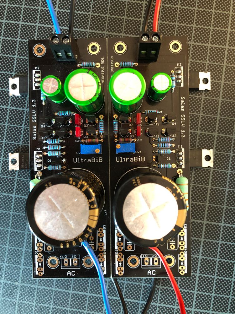

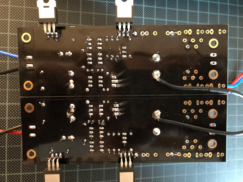

I think I found the problem.
After reading your questions myleftear, I checked everything again with schematics.
I connected Negative ground to the wrong side (not gnd).
thanks for questioning

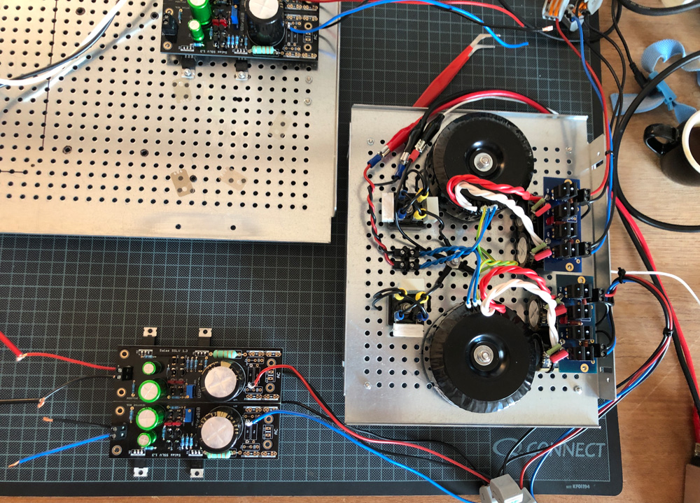

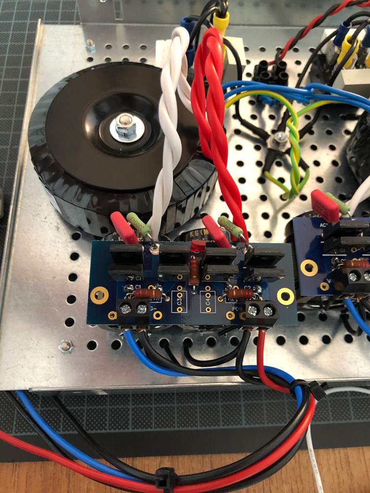

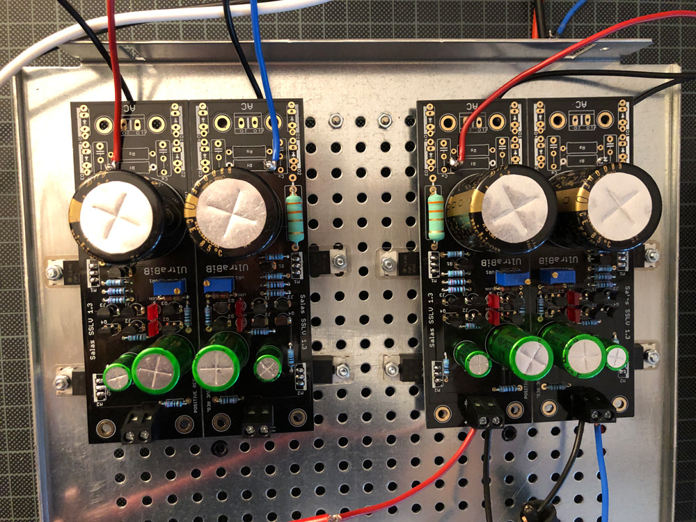

I rewired both ubibs and the led goes on on both.
But lightbulb tester tells me there is still a short somewhere.
The psu without ubibs connected works good.
Also can I easliy omit rf or should I look for a substitute, a more appropriate wattage for 34v in/24 out and 166ma?
Doesn't the bulb go dim after an initial flash (C1 inrush)? If not, see that M1(s) are insulated well and show Vgs too. You can omit Rf.
Lightbulb goes dim after initial flash but continues to glow. (40w bulb)
So I'm too scared to turn it on for longer than a few sec.
Yes correct when to jump each Rf going directly to each C1. How are the grounds common for dual reg? They already meet at the raw DC supply? First check all Mosfet tabs must not making contact with the chassis. Buzz them out utilizing the DMM's continuity test mode.
Even if I power it up not on the chassis it does not work.
The grounds are directly connected at raw dc nothing in bewteen.
Also it makes this sound as if something would cook, very concerning.
