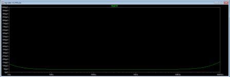

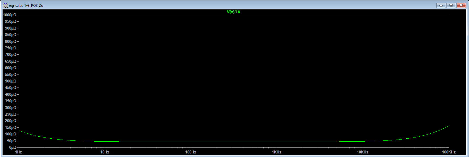

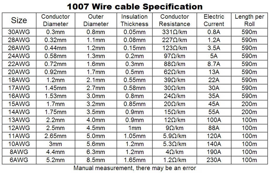

Ok. So minimum impedance of UltraBib is 50-150 uOhm. 18 AWG, for example, 1 meter will add 39 uOhm. Not really extremely much. Capacitance also must not be much if wire core in teflon tube.
Am I right?
39Ω/km is 39 mΩ/m not μΩ
Wire inductance is what we mainly care for in this case, not capacitance. But you can twist them to decrease it some.
Yes, I was wrong.
