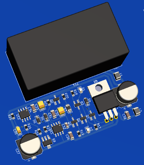

hi! i have made an idea of low power salas shunt for my dac. 0.5W (max) disipated on each mosfet, about 60mA spare current, CC is about 210mA, Vout is 8V, Vin is 11V. Dimensions 55x25mm. it will be fed by golden reference low voltage power supply (GRLV) made by kevin gilmore, designer of dynalo amp series. this is very stable power supply but salas shunt wil add low output impedance and further improve ripple. GRLV is fed by meanwell SMPS brick (15V). i want to thank you Salas for your help
This answer comes from the reg's pdf guide:
"The reg works even with less than 5V difference because CCmA weakening starts only at Vin-Vout <1.7V for ~200 CCmA settings. At 600mA CC it starts weakening at Vin-Vout <2.5V. But more voltage space allows for mains play and for better M1's parasitic capacitance."

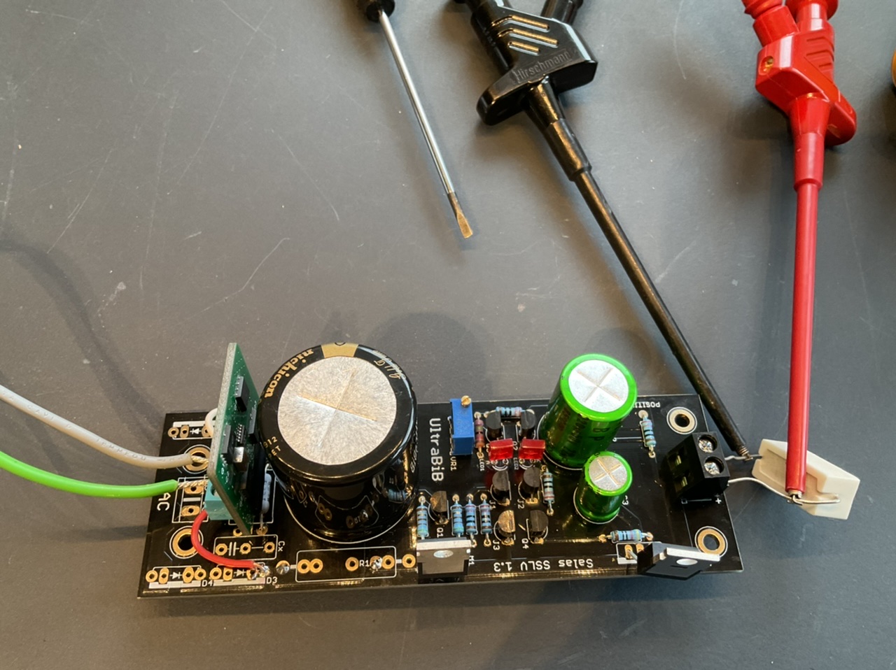

I have build 2 ultrabib positive regulators and cannot get them to run.
I attched a toroid transformer with 30vac output and used a saligny mosfet rectifier. R1 is below the pcb.
On both regulators I get 3,45v output and cannot set the voltage.
Did I make an obvious mistake?
Hope you can help.

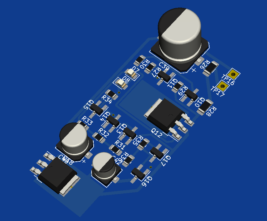

My volume step attenuator (quad) is quite long and interfering mechanically with one of Neg regulators C2 and C3 Ele caps. Is it OK to use 5cm legs on these to move them aside a bit? It will add some inductance and might very little impedance… Thank you.
Short question…
Hi
No don't extend those caps pins, C3 especially not. Oscillation danger or performance worsening the least. Find shorter stature elecaps maybe?
I see. I’ll try to go from backside then. Thank you.
