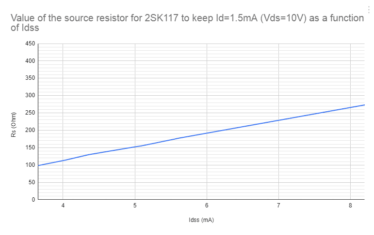

I did a simple measurement of the Id while changing the Rs value on 2sk117 to keep constant Id = 1.5mA, Vds = 10V
The plot is made of 8 points:
The Id is pretty constant in the saturation region while changing Vds, which means - if I'm not mistaken - that the lambda is small, so it's not a "tubey" JFET but it's a good one for CCS 🙂 It also drifts with temp as all JFEts.
It looks like a straight line. So having this:
point 1: Idss=8.2mA, Rs=273 Ohm
point 2: Idss=3.65mA Rs=98 Ohm
we can find the equation (used Least Squares from 8 points):
Rs = f(Idss) = 38.35*Idss - 40.05 (Ohm) - Idss value in mA
Idss (mA) Rs
3.65 98
3.76 102.6
4.03 114
4.36 130
5.03 153.4
5.09 155
5.63 178
8.2 273

Its not the steadiest but it has small Vp and low noise also so I use it in SSHV2 for ages. Very steady ones of high Gos are usually noisier with higher Vp. I look at Vp also because I nest it under a transistor's Vbe in the particular circuit.
Finding a degeneration resistor for each K117 giving 1.5mA in circuit when for Ubib well done.
