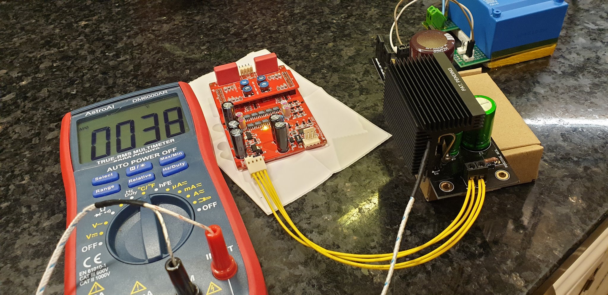

That was my main aim Nick, it has allowed me to squeeze in a transformer more elegantly.
I guess for those with a heavy metal wall of chassis to bolt to then nothing is gained with these but for me in this chassis I hope they come up trumps!
I shall try to fire one up soon and see if it melts!
No fumes were created!
Running R1=2.4r for 250ma ccs.to power an Abraxalito PhiDeca dac at 15v. Not 100pc sure what current the dac needs. I did try to measure but failed. Richard I think says it is 160ma max.
Powered up for about 3.5 hours tonight and reached a max temp of about 38degrees C. My IR gun told me similar.
Will get hitter in a chassis obviously but I think it is a success!

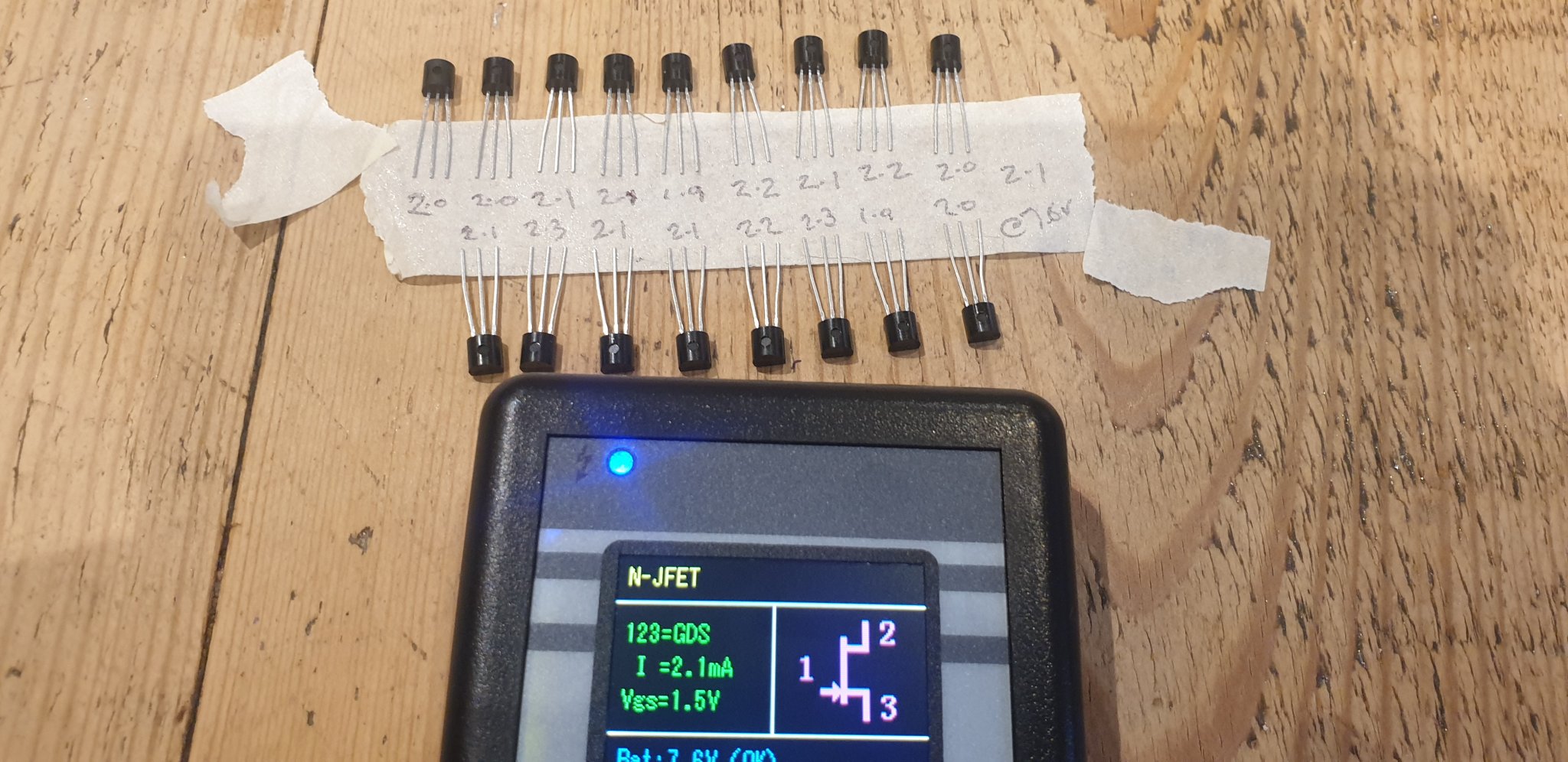

J113 tests.
I've just run a batch of these through my tester, the VdS was 7.6v as indicated on the display.
Is the mA figure the Idss? Seems very low but then the datasheet does state its idss is 2mA.
How do these tests relate to their associated R values for R4,7,8. All measure between 1.9 and 2.3.
thanks!
thanks!
This is not the Idss current it reports. Too small for a J113 in practice. Maybe it's just showing the bias Id it uses to measure Vgs.
