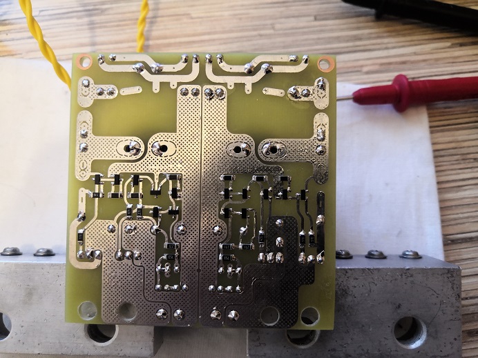

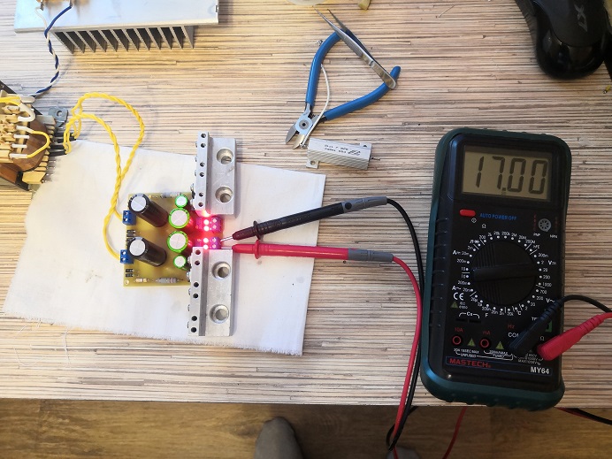

hi everybody,
i am really DIY beginner and just finished my first neg. and pos. ultrabib. so far so good.
connected it to a 12v r-core, leds are shining. but: output is about 16v, so i think something is wrong. trimmer on vr1 makes no difference, when i try to regulate.
i am going to resolder (soldered only on the back of the board, and will solder on the other side, too)
i would be glad, if i can be pointed into the right direction, on where i could start with my troubleshooting.
thanks again!

Hi
Output looks like it's just the top input potential. First thing is it takes many turns on the 20k trimmer to make sure it went low enough.
Next thing is visual confirmation that the right components are in the right places with correct orientations in the right polarity regs (NMOS PMOS NPN PNP) then Vbe voltage checking of Q2 Q3 and Vgs voltage checking for M1 M2.

hi salas,
false alarm, everything is fine. i had to turn the trimmer really often. (and i soldered the other two platines) so looking forward making first listening tests.

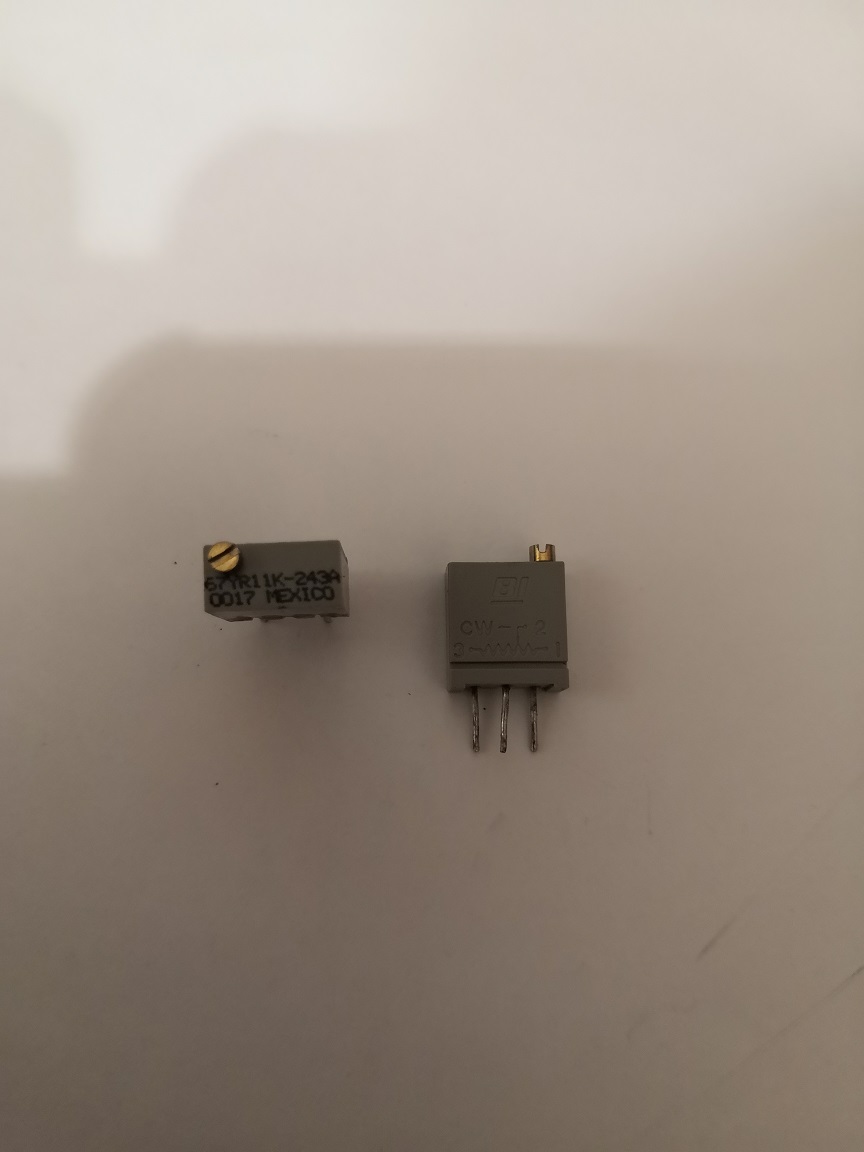

Hello. I need help. This may have already been discussed, but I can't find any information yet. Assembled a mock-up of the Ubib positive regulator. The output voltage is adjustable from 5V to 7.25. R1 2R2. The voltage drop at R1 is 0.56. The diodes are glowing. Vds M1 -16.2V. Voltage drop at R7-1.67 V, R8-1.44 V, R4-1.9 V. Vbe of Bipolar transistors from 0.56 to 0.64 V. I suspect that the problem is somewhere in the area of J1, Q1.What else do you need to measure? Thanks.
Vds J1-13.6V!!!,J2-1.53V, J3- 0.75V The radiator is warm. Vgs M1-5.43V, M2-3.82V. Vgs J1-1.88V, J2-1.66V, J3-1.43V
Vds M1 has to be Vin - Vout. Vgs is normal in M1 M2 so they do conduct. Measure if the trimmer has the expected Ohmic range.
A very interesting situation. The original tuning resistors were faulty. Last of all, I would have thought about them.))) I put the Chinese 10 kohm. Everything worked. The voltage is adjustable. Thanks.
We nailed it on first guess, nice. But yes, weird to chance on faulty trimmers. Maybe they did not respond well to your soldering iron's heat setting.

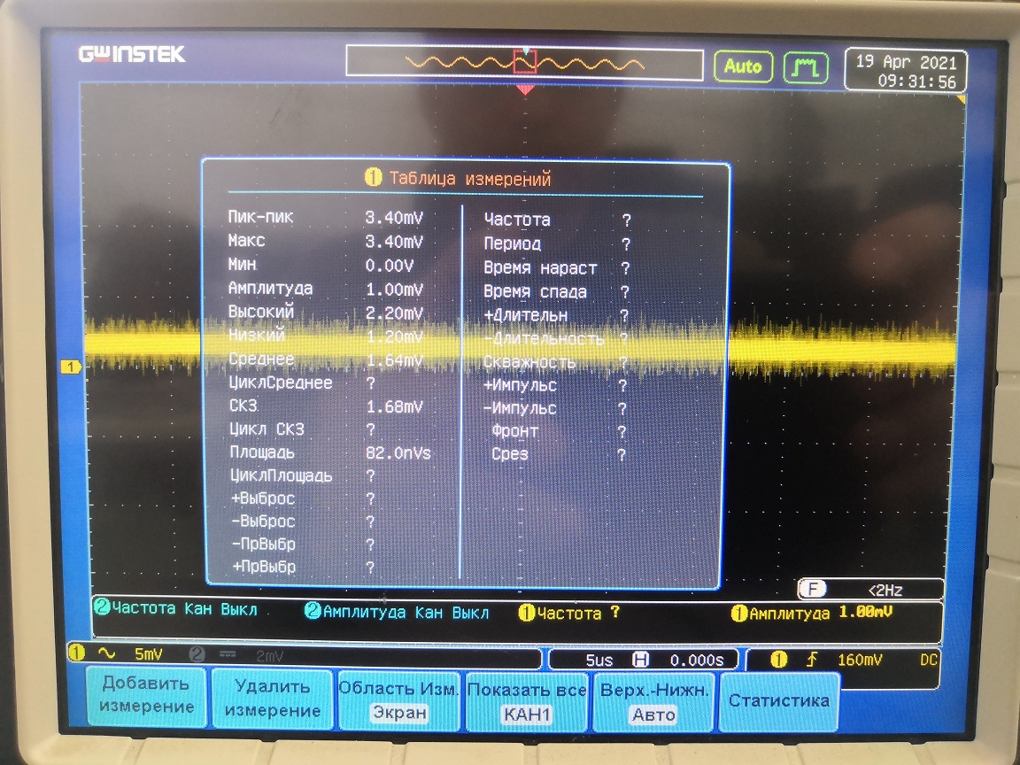

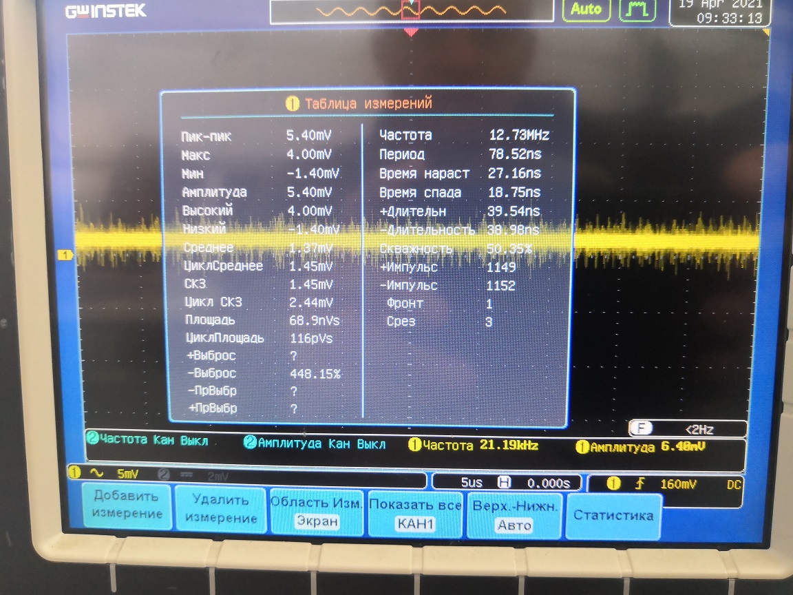

I decided to measure the AC ripple with an oscilloscope. Against the background of its own noise, there are practically no AC voltage emissions. Am I doing the right thing? Or please tell me how to do it. The output voltage is 17 V. Load 100 R.
There is no ripple. At least the M1 current limiter part does its job alright. How much voltage is there across R1 R5 R6? (Each one resistor's voltage pin to pin).
