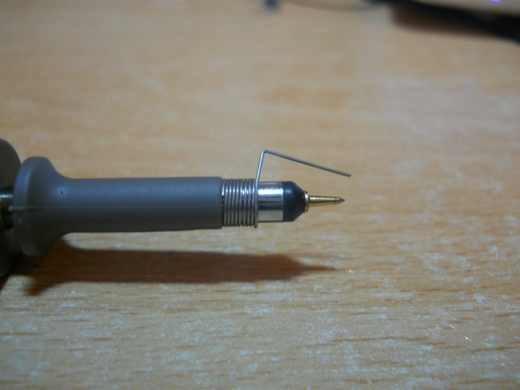

I decided to measure the AC ripple with an oscilloscope. Against the background of its own noise, there are practically no AC voltage emissions. Am I doing the right thing? Or please tell me how to do it. The output voltage is 17 V. Load 100 R.
Remember when you use the scope to measure rails select the 20MHz bandwidth limit and use the short coil ground on the probe's nose. To avoid some of the scope's self noise and interference pick up from the normal crocodile long ground lead's inductance.
Something like this?
