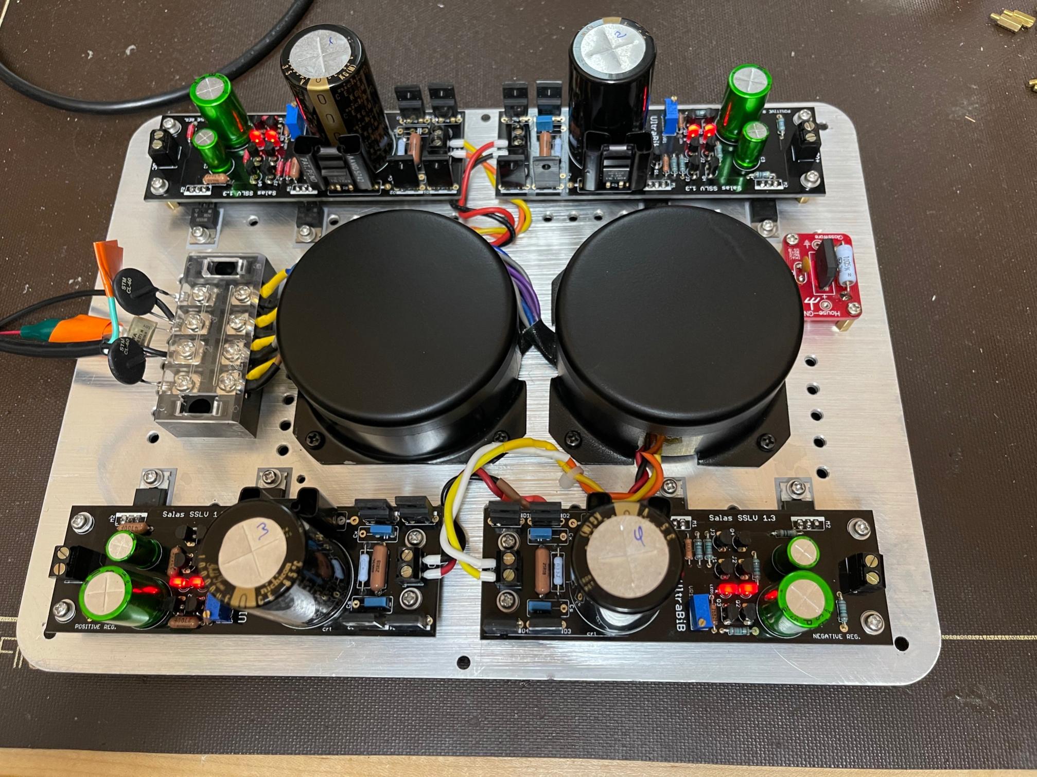

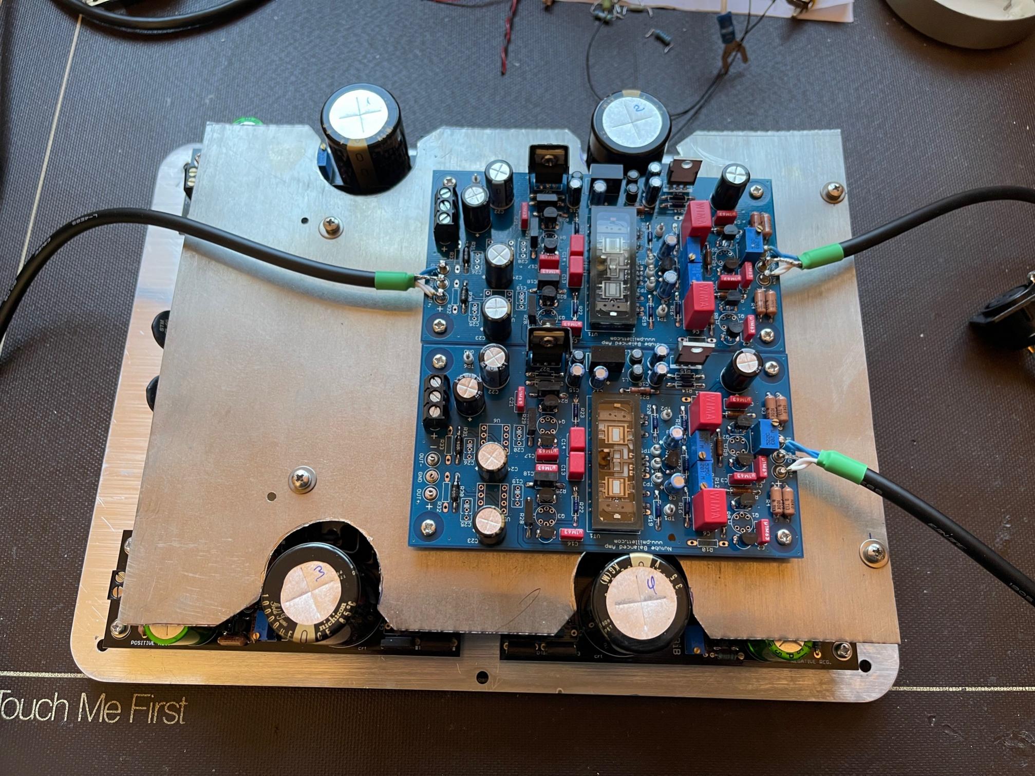

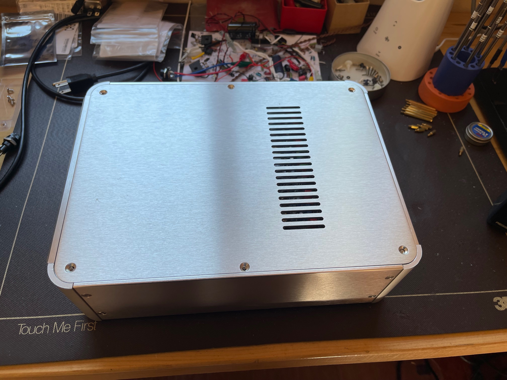

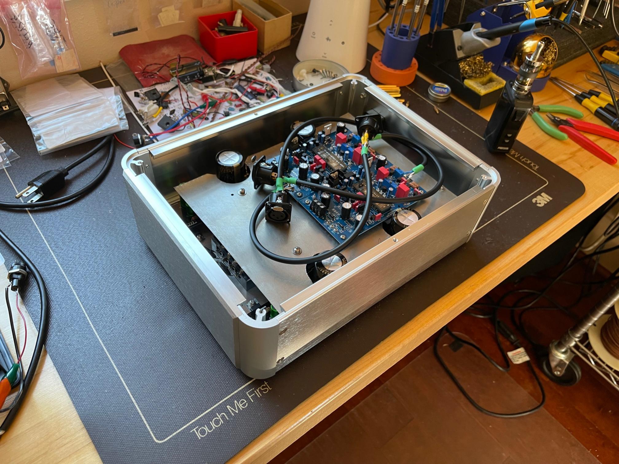

Another use for UBIB for my fully balanced Nu-Tube headphone amp. Did not listen to it yet, but believe it will be prefect match. All assy is still in progress.
