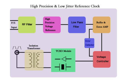

On ebay sells PSU for clocks from Sallarz
R-Uhr High Precision Low Jitter Reference Clock, ultra low noise Regulator | eBay
It is based on voltage reference
who knows is it good good schematics or not ....
