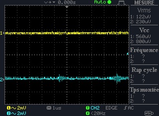

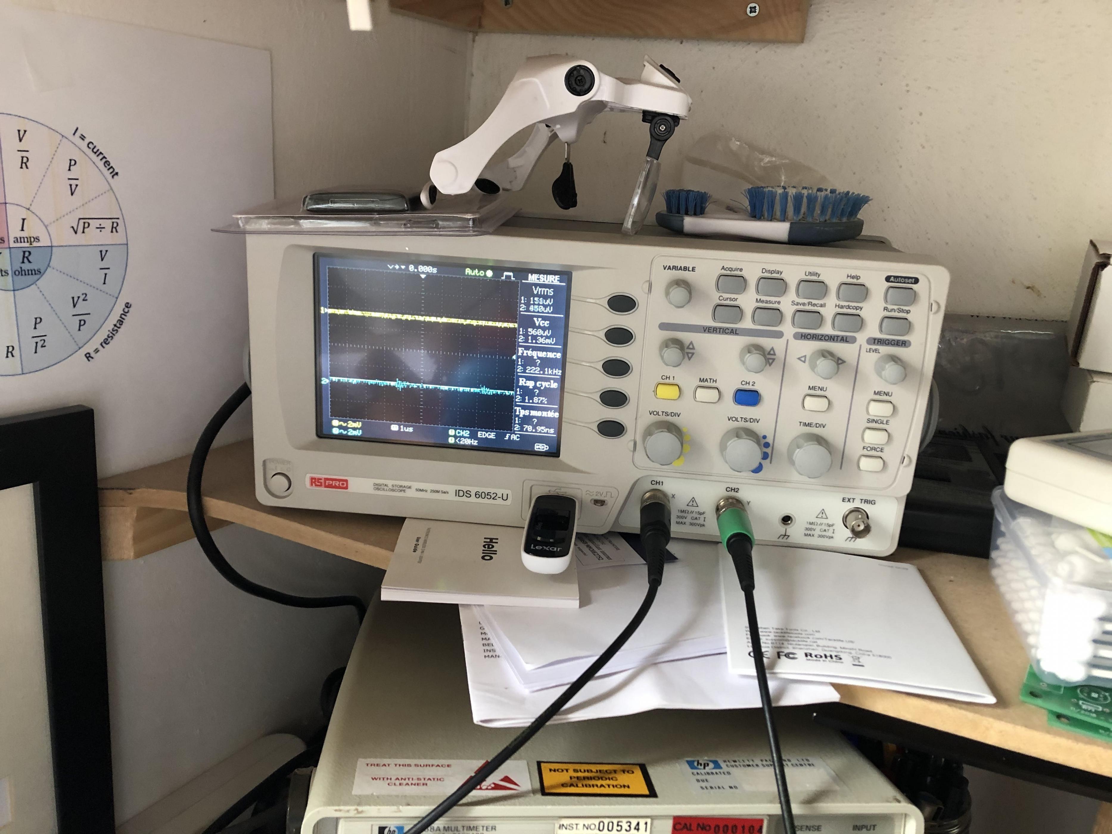

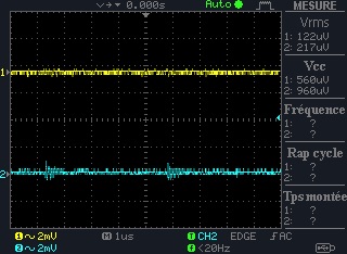

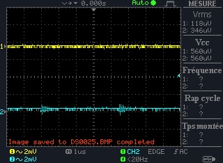

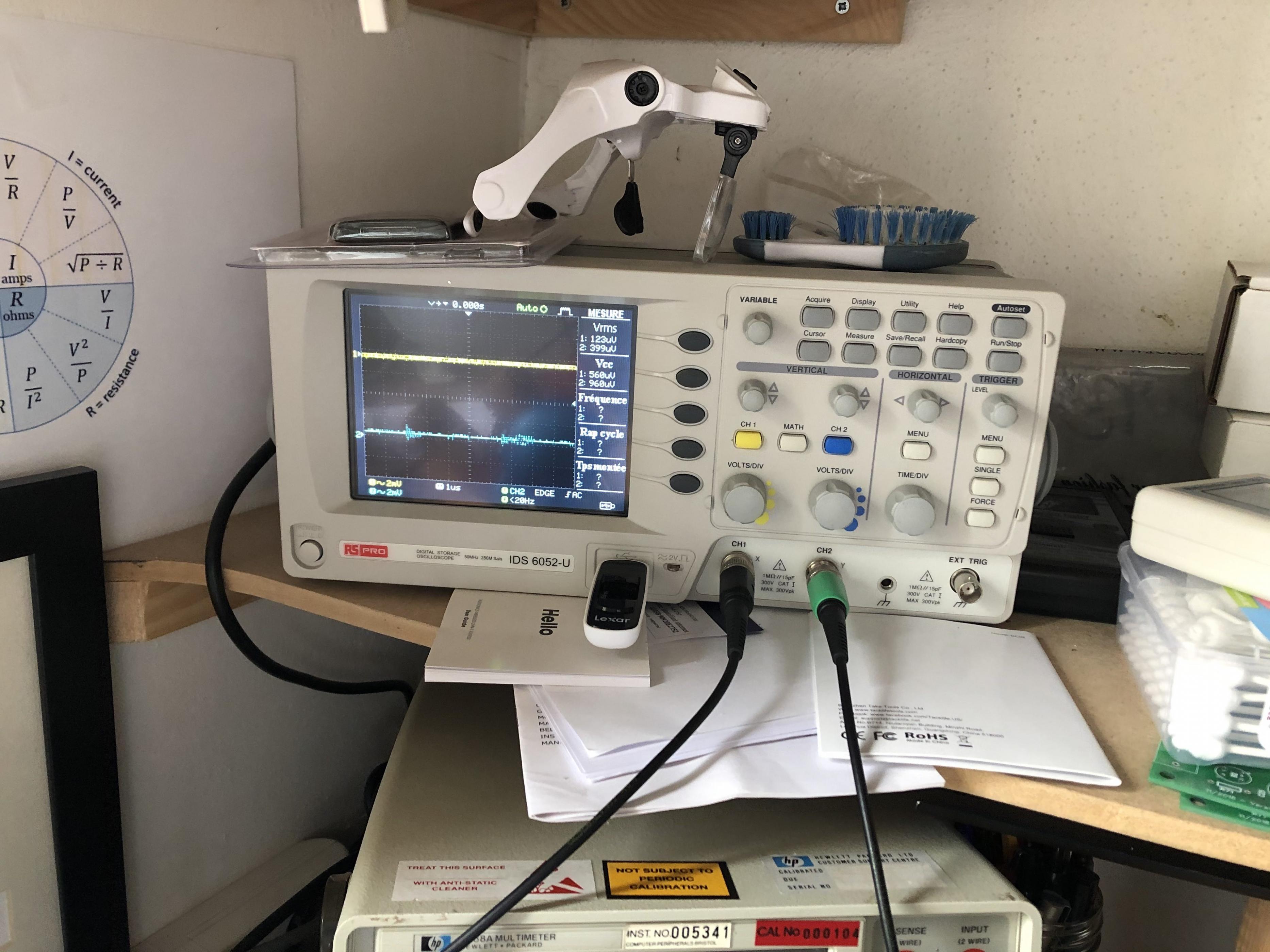

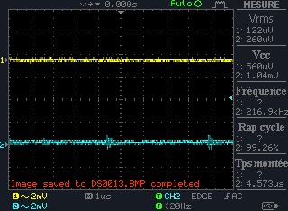

Yes the probe look the same ( i shut it down just for the Hard copy, i do not remember why). I have more trace....

Seeing same trace noise for probing the shunt PSU when powered on and when off its good. Means nothing significant is added to the measurement loop noise by the PSU itself at this resolution limit. For more resolution remove the probe noses and their ground wires. Put the short coil ground and probe on the Vout connector screws. That will hopefully improve your measurement loop trace noise. If there is a 20MHz bandwidth limit option in the channels menu turn it on too.

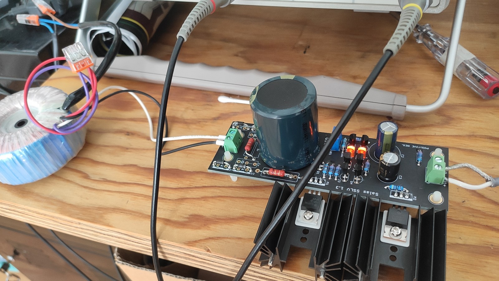

I did the simple outpout resistance measurement that was proposed somewhere here. I wired everything up using a 2x9VAC 50VA toroid and it worked great from the first start. Adjusted output voltage to about 22.5 volts. My BIB runs at 200 mA setting (R1 3R) and my load, an older version of the simplistic riaa, draws exactly 50mA. In this setting my sink for M2 gets well hot, but i can still touch it (for a short while haha). I will rise R1 to 3R6 to drop the CC to 166 mA in order to get cooler temperature on M2s heatsink.
I tried to measure ripple on dc output with my oscilloscope but the only thing i could see was a flat line @ 5mV (with x1 and x10 probe).
