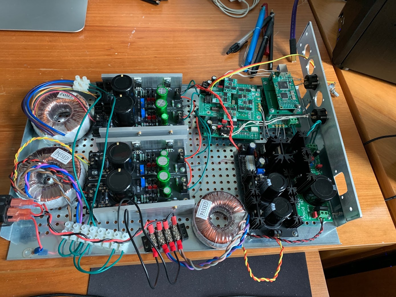

I'm doing a dual mono with UBiB 1.3's for my Aleph J. Separate Pre. It is in a DIY 4U/300 box so floorspace is a little tight. Could I just use 1/4"x 2" Al bar on edge, something like 4'' a side be ok for heat dissipation. Dual Antek 4220's. That's about it in this box. Going to join it with the DCG-3/DCSTB pre. At my experience level I am really just guessing at the topology. I think it is what I am looking for though. Just hoping my ignorance will be audio bliss. 😀

Aleph J is a power amp. Ubibs don't have the juice for power stages, only for their driver stages. Is it for something I did not understand?
By the way, powerful capacitance multipliers for filtering the rails are a popular add on in modern DIY amp builds. They still follow the raw DC level peak power sag, they aren't voltage regulators, just noise/ripple eaters.
Maybe L-Adapters could tackle such an amp as a whole. Stabilized rail power amps were always rare and expensive. At least twice as complicated. Extra dissipation from the power regulators is also added. Sometimes four of them are used in a stereo amp to minimize crosstalk. Reliability suffers with complexity too, not only the the pocket and thermal budgets.

I'm getting higher temps now on one +/- set of Ultrabibs running at 325mA and 15v. M2 on the +/- boards are getting up to 70-75c. This is hot, but still seems well below their max temp. Is that okay long term? The other set running at 200mA are about 10-15c cooler.
Q2 on the L adapter is getting up to 70c it seems at 5v and the DAC is drawing maybe 500mA (possibly higher with higher res files). My AC voltage is measuring 125V on the mains, 18.5 on my transformer with 15v secondaries and 10.8v on a transformer with 9v secondaries. This seems high and might be contributing.
Those small aluminum bars you now got as UBiB sinks are not forever. When you will fix the build prefer the perforated bottom plate as a cooler and temps will drop significantly on the power semis. Be careful with their insulation then. No tab should show continuity to the plate. Meanwhile evaluate your settings to not run more than 150mA spare current above loading consumption in the shunts. Highish secondaries surely contribute heat to UBiB M1s and to the L-A's Q2 pass transistor.

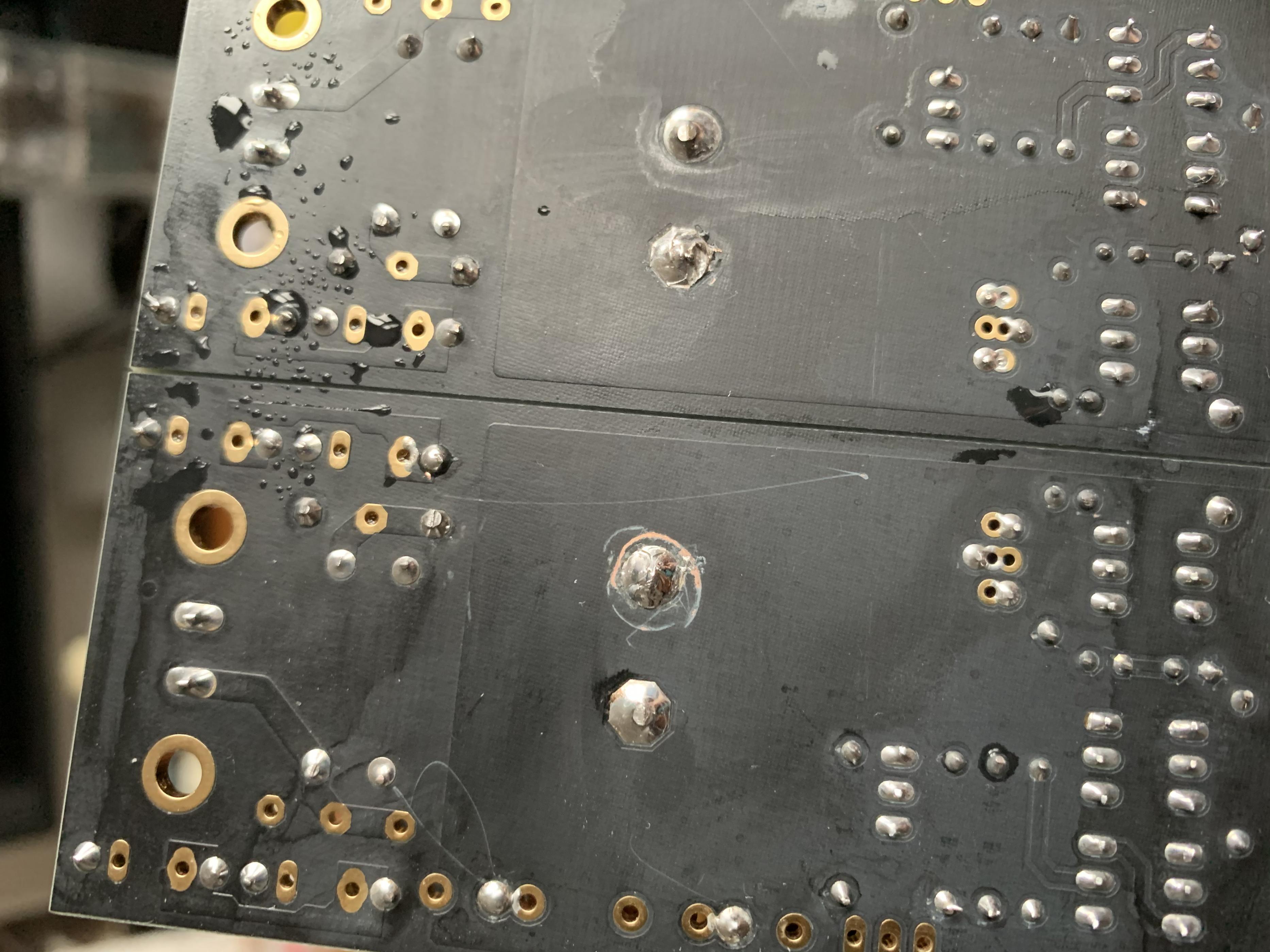

I scratched the pcb mask on the left side around the capacitor pin. It looks like there may be a solder bridge between the pcb underneath and the capacitor pin solder pad. Should I try to remove the solder or would this be the same copper plane the capacitor pin is soldered to?

pretty sure that pad is part of the ground plane, use multimeter to double check.I scratched the pcb mask on the left side around the capacitor pin. It looks like there may be a solder bridge between the pcb underneath and the capacitor pin solder pad. Should I try to remove the solder or would this be the same copper plane the capacitor pin is soldered to?
