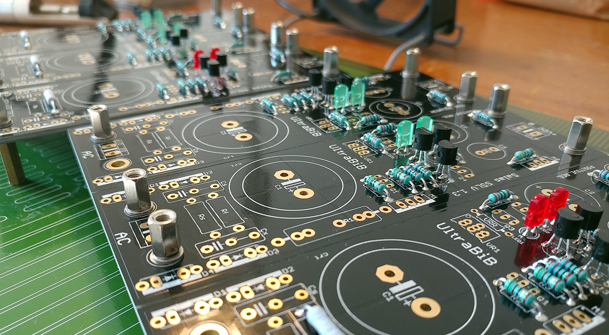

Salas, I just powered up a positive ultrabib for the first time. I cannot adjust vout with VR1 - it is measuring 4.91vout. M1 is warm but M2 is not giving off any heat. Both LEDs are illuminated. Any suggestions?
After rechecking all semis are the right ones at the right places see if Q2 Q3 actually give 0.61V Vbe and M2 few volts Vgs. Also retouch Q2 Q3 C2 joints.

Confirmed all semiconductors are in the correct place and I re-flowed Q2, Q3 and C2. Still no change.
M2 measures 3.58v (between two outside pins)
Q2 and Q3 measure .625v (middle and right pin when facing the flat "face")
It's a bit tough to measure now that it's soldered, but at one extreme I'm measuring approx. 75ohms and when turned the other way it reads about .4. When I turn back 5 or so turns I'm reading 72.5. I used these 10k variable resistors.

But you only got 4.91V output that doesn't change at all with the trimmer right? What transformer you use? What is your target Vout? How many mA CCS you can calculate by drop on R1 divided by its Ohms? Is the output free or loaded with something?
Correct, vout doesn't change. I'm using a 50va 2x15v toroid. I get 15vout on the other secondary with a different power supply. My target vout for the ultrabib is 15v and 200mA CCA. Right now I have a 3ohm resistor at r1. The 4.91v is unloaded, when I use a 20ohm resistor I have as a load, this drops about 1v to 3.9v.
When there is ~0.6V as to be expected across R1 you have CCS of 0.6V/3Ω=200mA. Loading 4.91V/20Ω=245mA. So the drop to 3.9V is correct due to current limiting.
When all bias voltages seem proper could it be your vrr is a 75Ω resistor instead of 75k by mistake?
After double checking, yes you are correct! Thanks.
