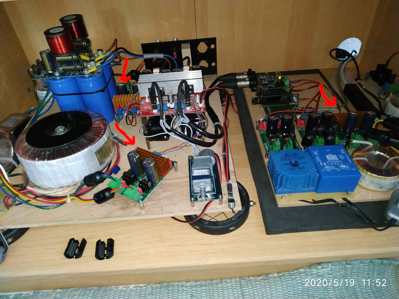

It will be more as day and night 🙂I'm curious about comparing this LT3045 setup with the UltraBIB. I will let you know the result 🙂
I replaced all LT3045 PSUs (2..6 paralleled) in my DAM1941 DAC. I never look back.
Thanks for your information, I'm looking forward to receive the parcel and build up the UltaBIB. In my setup I will replace 3x pos, 3x neg rails of LT3045 located in the DAC and in the AMP.. It would be amazing if i got some SQ improvements in all that places 🙂
Did you have done some specific changes in the UltraBIB or let say just stock build with recommended parts ?
Nothing special, I use Ohmite (1.2R and 1.8R WW AG5) resistors as R1.

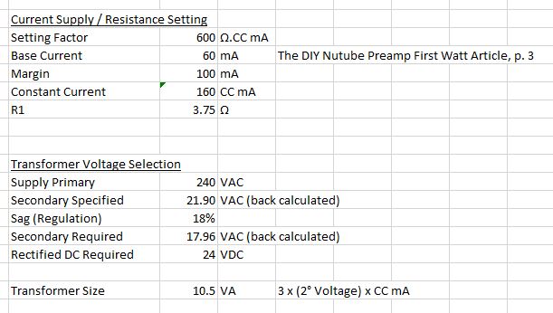

Here's an outline of how I would do it, to suit conditions local to me, while accounting for the advice and supporting info provided by Salas in Post #1.
For a small transformer (I've referred to some vendor data for a toroid), the regulation / sag at load is significant. For the assessment attached, I've not added any margin or other factors.
- Power Supplies
- Salas SSLV1.3 UltraBiB shunt regulator
