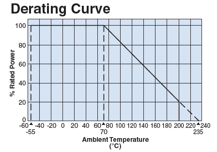

At the moment i look if it is stable and check the heat. The fets do not get that warm, can touch everything easily but my resistors (3R3 5W KIWAME) get reaaally hot. i can touch them about 4 seconds...
So, is this a problem? and can i decrease the offset or should i be happy with the results?

Your offset is not objectionable at all. Kiwame is made by OEM. The original part is KOA SPR. Its a +/-350ppm carbon film type, 100% nominal power rated up to 70C ambient. I.e. its well in thermal spec the way you use it at about 1W dissipation and in moderate ambient. Nice proven part although a very low ppm film or wire wound type would be potentially superior.
