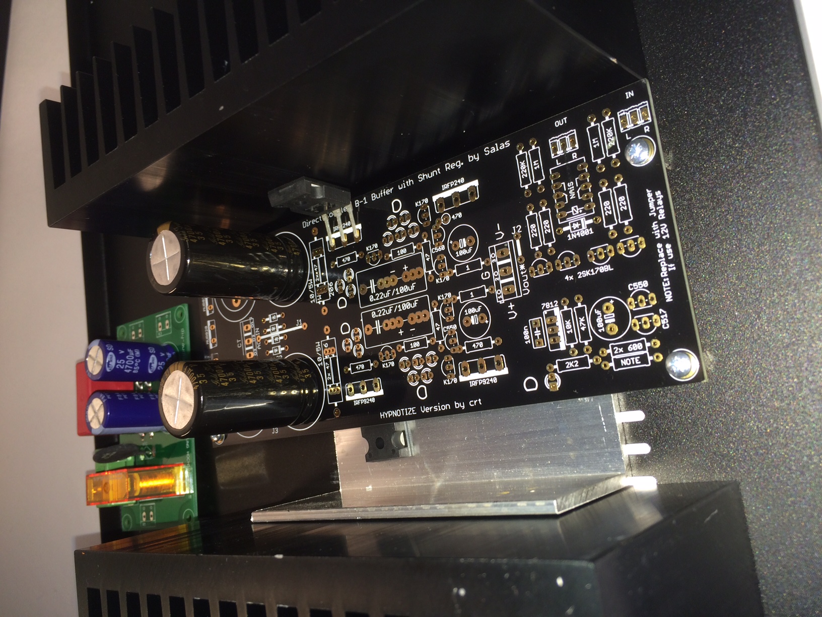

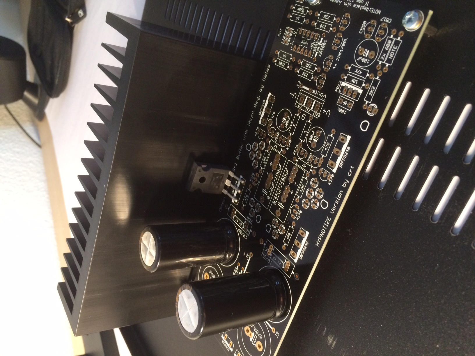

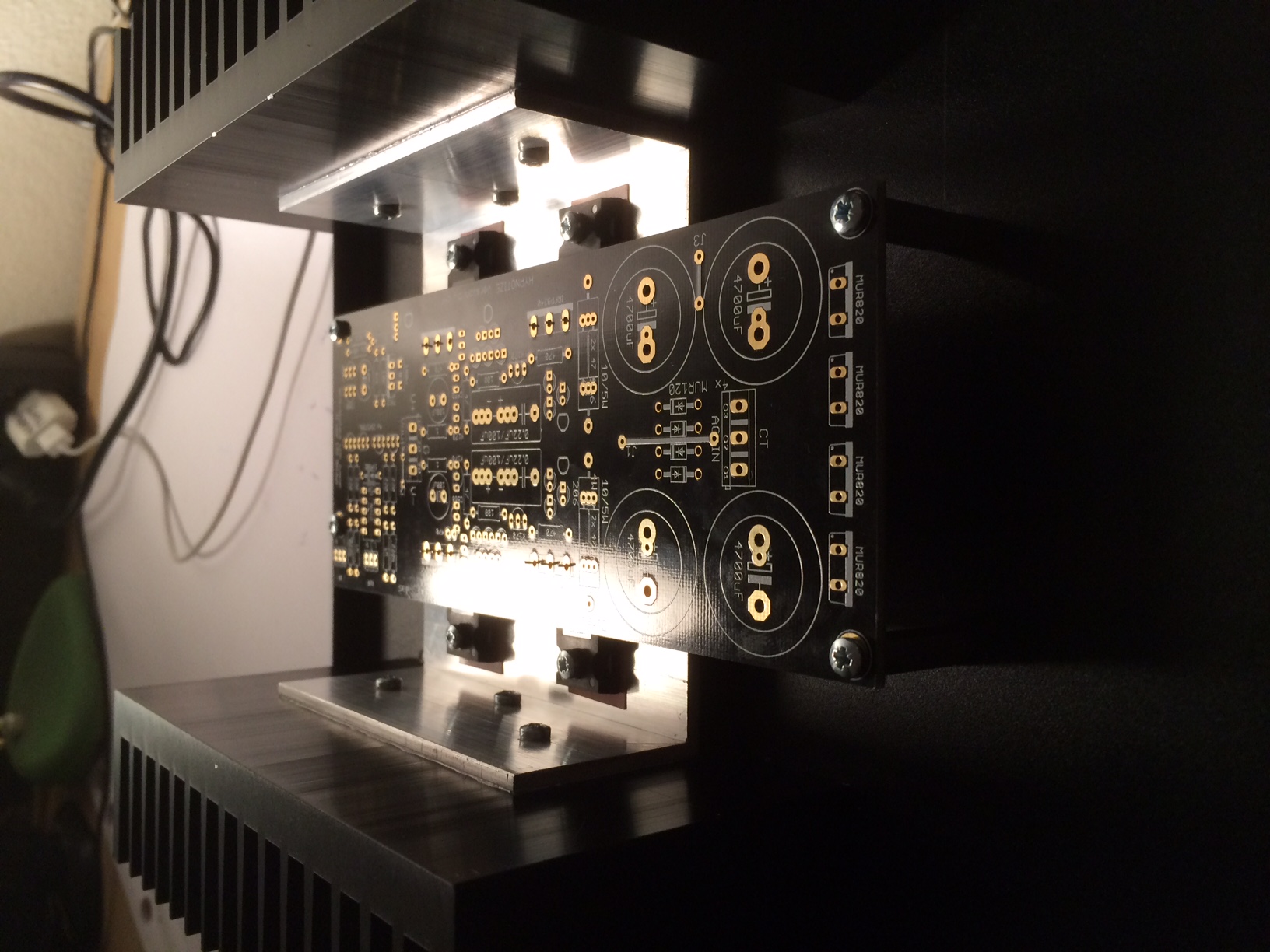

At the moment i am wondering how i should mount my transistors on my heat sink. I am going to build the 600mA version so for that i bought a 0.9K/W heat sink. In a post in this thread it is mentioned that the big electrolytic capacitors (4700uF) should not get to warm to increase their life span.
At the moment i have three different ideas.
1. I use an aluminium L-profile which leads the heat from the mounted IC's to the heat sink. By that the heat sinks are not so close to the capacitors. (first picture left side)
2: I place the heat sink very close to the pcb, by that i don't need the aluminium profile but the heat sink is quite close to the capacitors. (first picture right side)
3: Same as the second version but the heat sink is moved a little bit so that there is more space for the input/output. (second picture)
I would prefer version three, but i am not sure if that will be a problem.
I hope someone can help me! Thanks a lot!
Philip

Solution No1 is best of both worlds for you because I see you got chunky sinks and wide contact area L brackets. I.e. much current ability and good distance can be combined. Only don't forget to use thermal paste between the L and the sink.

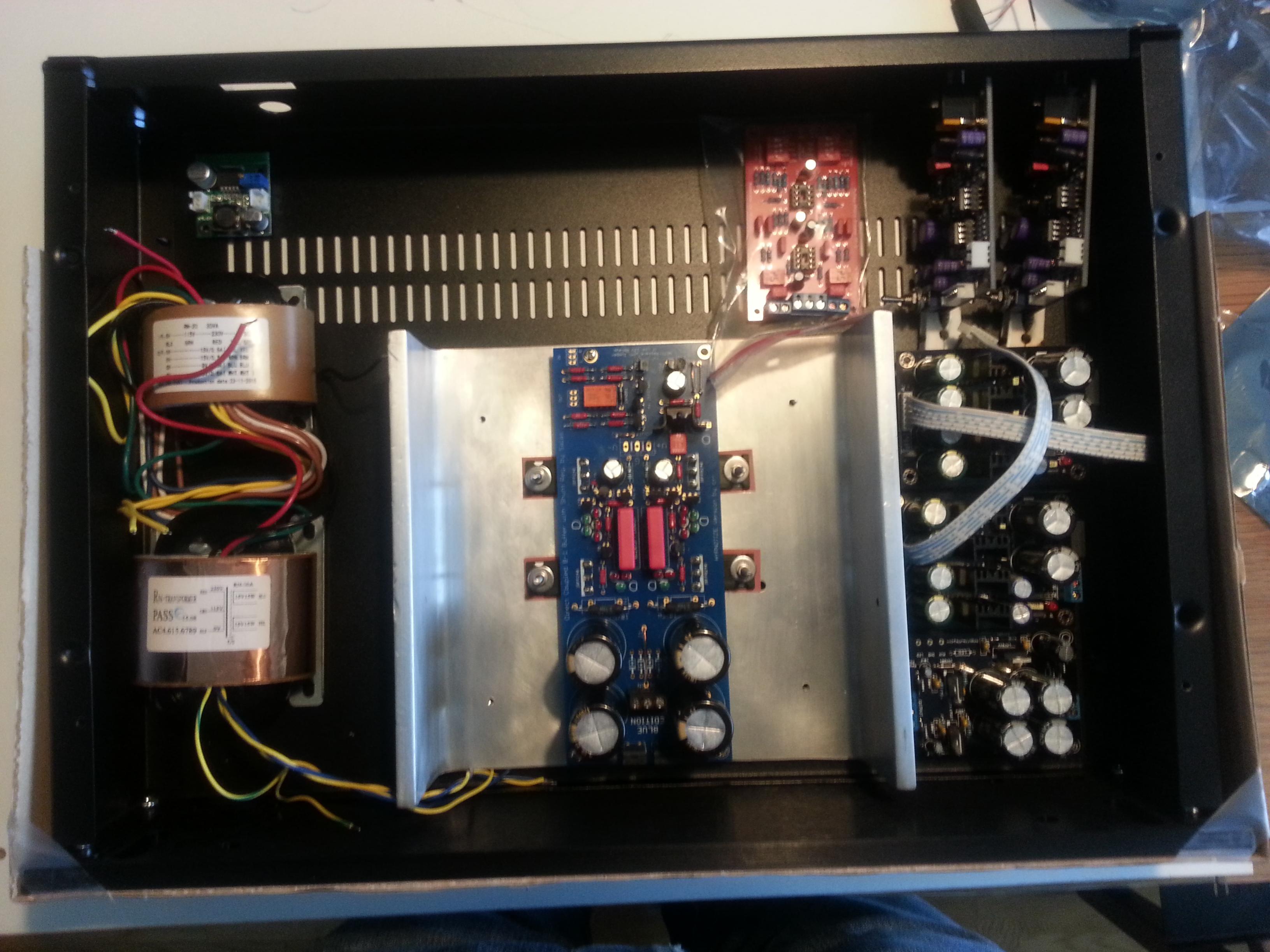

Working on enclosure lay out:
Congrats. Let us know when you finish.
Phil,
the L bracket should not be down at the bottom of the sink for good dissipation.
Move it up.
You can place the edge of the PCB just under the L and mount the transistor from the top side.
This allows you to raise the L a bit higher than using a bottom mounting transistor.
You also get betting cooling if the transistor is close to the vertical face. But be sure the inside of the angle is flat where the transistor mounts. The outside of the angle can be made flat.

Hey Andrew!
I plan to use 2cm bolt spacer for the pcb (so not 1cm as in the pictures) and lift the L about 5 mm, i hope thats enough space below.
What do you mean by
What do you mean by
That there are no scratches on the L brackets? I will be careful and use a heat conductive film for the transistors and a paste for the heatsink/L bracket connection. The space between the transistor and the vertical face is also around 5mm.But be sure the inside of the angle is flat where the transistor mounts.

The inside edges of an angle are usually not exactly flat and some have a very pronounced radius in the "V".Hey Andrew!
What do you mean by
You need to check with a straight edge held up to the light if the area you intend to clamp onto is actually flat.
The outside edges are more likely to be flat and if not can be made flat with some machining/grinding.

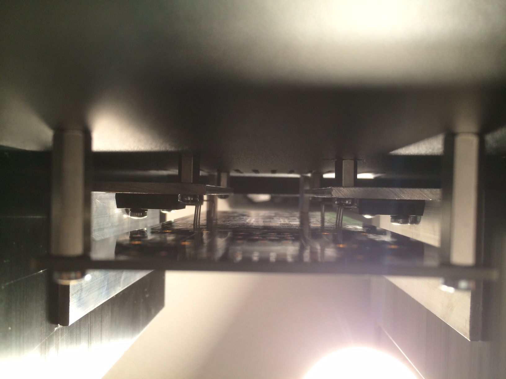

After some drilling work and cutting some threads I saw your post andrew and decided to use a third screw in the middle to press the L-brackets onto the heat sinks... So after a second try and some fun with the heat paste i assembled all together and i think its quite nice now! I hope heat is no problem in the future, also for even for more current (?).
By they way, if i want to hotrod one step further, so 1A version, how many VA should my toroidal have? At the moment i got a 120VA 2x15V, but i am not sure if thats enough for the 1A version. Anyway, i will start with the 600mA version first... (and will check the thread for more information about the 1A version 🙂...)
Here some pictures, maybe someone can use them in the future
