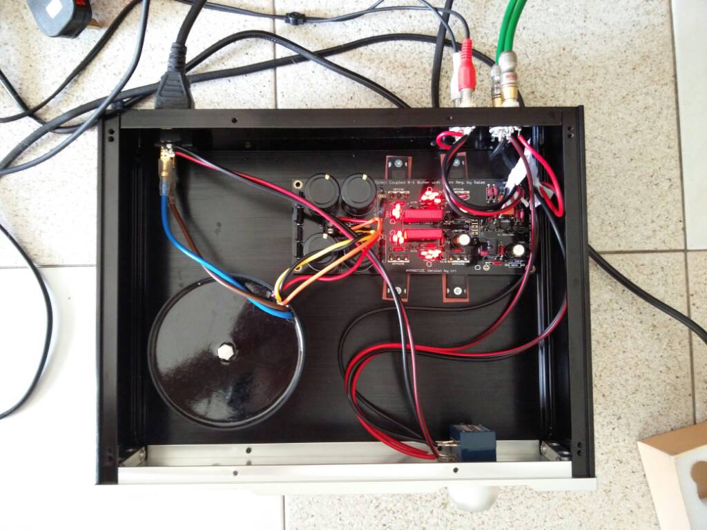

Finally have competed builds of my two dcb1s
The first one is now in the chassis for burn in. With an Alps pot. Would be using it with Maya R2R later on.
The second is powering up. The listening was done on the first one so far. And it sounds pretty nice and detailed. Would run a bit more to give more feedback, which would be positive. Provide feedback here only gives good loops))
Salas, for the design.
Tea-bag for the kit.
Andrew, for the transformer wiring suggestions and being patient to my questions)
So far I did not group d the dcb1 itself. I should use the power output connector to ground it, am I right?
Or another hand I have noticed an interesting effect when listening. It looks like it has clipping sometimes.
Especially on mp3 recordings when they are going very loud.
The effect is rarely present on flat as well, but I guess this is more due to the calmer music I have in flac.
When the recording goes loud I can hear sound like Shsh and than it goes back to normal.
Current set up is
BBB->USB I2S - >PS Audio Digital link II DAC - > DCB1 pre amp - > audiolab 8000a (line in) or J-MO headphone Amp (with volume pot)
Do you think the clipping can happen to the lack of grounding

Gave noticed another interesting effect. When dcb1 is plugged into audio lab line in. When the volume control is in the first 15-20 minutes I can hear a very loud whistle. When I am past that zone the music plays normally.
It works fine with headphone amp though
Sent from my ONE A2003 using Tapatalk
DCB1 has reduced the output resistors from 220r (Pass B1) to 100r.
Usually this gives no stability issues, I seem to remember that Salas gave a warning to check stability, but I might be wrong.
I have never had a problem with the lower value output resistors.
first 15-20 minutes
Are you talking about time from switch ON?
or degrees of rotation of the vol pot?
I am counting the degree of rotation from the mute position
It might be the problem of the audiophile itself as I can here hum even with no input counted at upper volumes on the audiolab itself
From 1K to 220R actually. Its beneficial to output impedance and audible to the better. I had indeed given a directive to check if more resistance is needed in case a whistle is heard. But it proved not so troublesome because we learned about one whistling incident only as far as I remember. It was a member driving long lines to active home studio type monitors. I don't remember if he solved it by installing higher resistors or he changed the cables with less capacitive type in the end.
