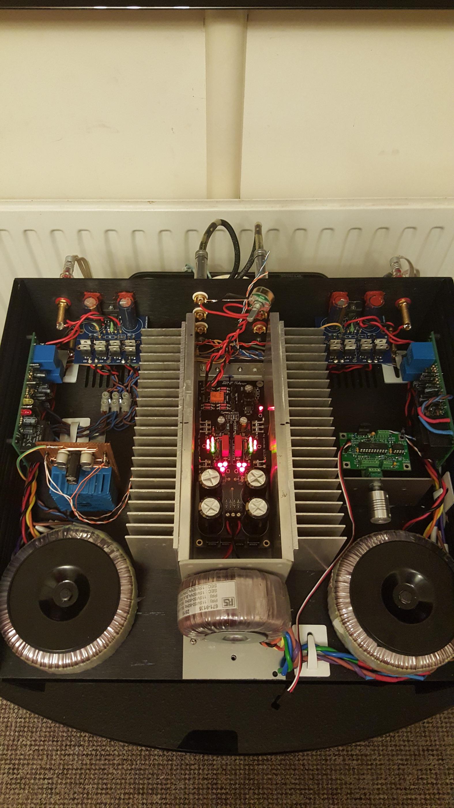

Just wanted to thank Salas and TeaBag, specially Teabag for sending me some more transistors F.O.C. Excellent service and highly recommended if a recommendation was ever needed. 🙂
DC Offset is now -2mv on each channel, coupling this to my DC Coupled 3875's produce no problems so very happy camper here, over the coming weeks I will be testing to see if the buffer is required, the 3 pin sockets supplied make it very easy to bypass the DCB1 for comparison. I am just going to run my AV front channels through it for now which gets used for tv every day until i get time to do some serious listening, oh and to finish the build.
Salas, I did install a second set of 2.5ohm resistors, these get quite hot, i can hold them for about ten seconds before it hurts, I will have to measure the temp, I do have a quiet voice in my head saying, are they to hot to be so close to those psu caps? the heat sinks on the other hand are doing a grand job, the fets dont even feel very warm.
Is there a way to install the resistors on the all encompassing sink (insulated from it) and use extensions to the PCB?
Theres always a way, I could strip it down, drill and tap the angle bar then solder links, I dont even think the resistors need isolating but i would check, do you think the extra heat will shorten the life of the lytics because thats what i am thinking. Will having long ish cables in this position have any other detrimental effect? Maybe a lessor of 2 evils. Probably a good opportunity to fit 2 more feet because the case is sagging under the weight of the DCB1. 🙂
Measure the temperature on those nearby electrolytics first. There is a rule of thumb to derive their useful life from their ratings. Each 10C less than the max specified doubles their life expectancy. I.e. If there is a 1000 hours 85C spec it translates to 16000 hours at 45C. Resistors with ceramic back don't need isolation and simple continuity check from back to their leads will confirm.
