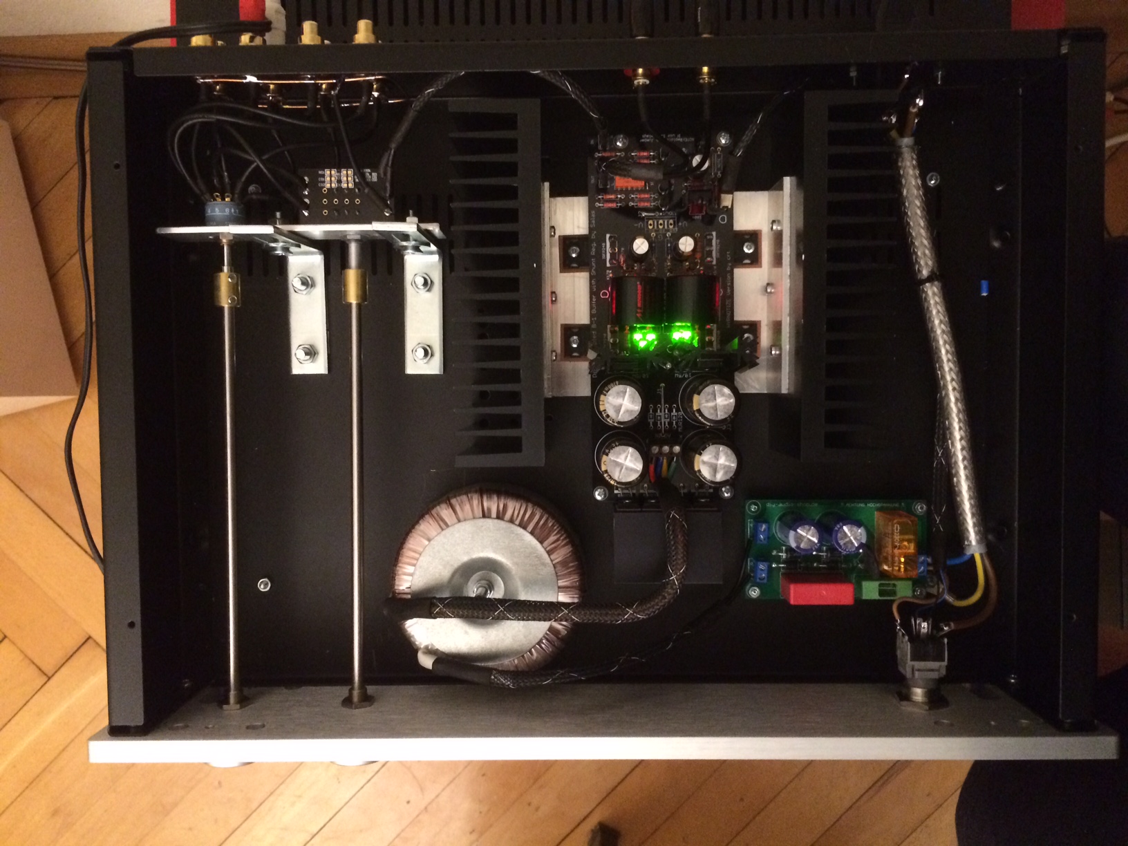

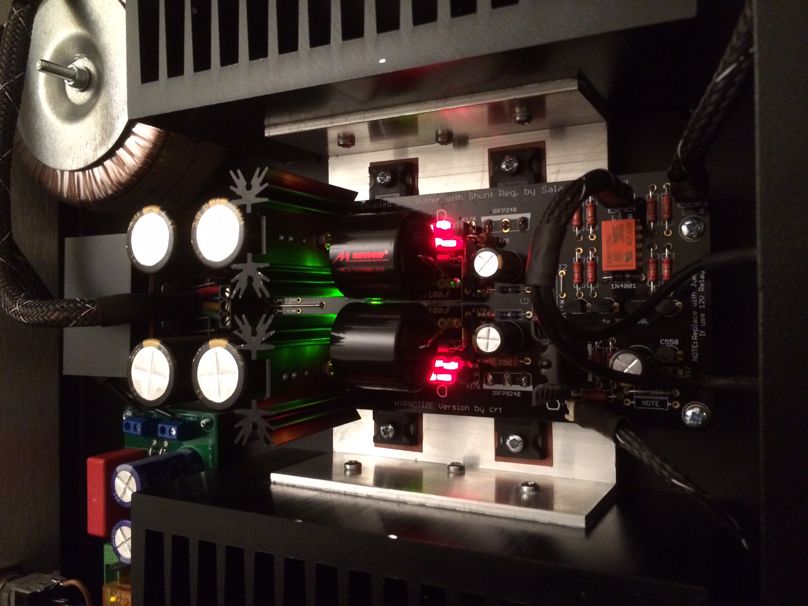

After a long time, i finally found some time to finish my DCB1 and share some pictures here. It took me so long as i ordered a bunch of new resistors and did quite a lot of testing. As often mentioned in this thread, heat plays quite a big role for hotroding the amp so thats why I also want to share my experiences for future builds:
1.) Do the hotroding step by step by decreasing the resistor and make some temperature measurements INSIDE the case you are going to use. It makes no sense if all the stuff gets just warm as the hot air can get away but creates an melting furnace afterwards...
2.) already mentioned quite often: if you go down to such a small value use a parallel wiring (3-4 resistors maybe?).
3.) If you want to use just one (like i did, the caddock MP930) then either buy a big one that can handle the heat or use a sink

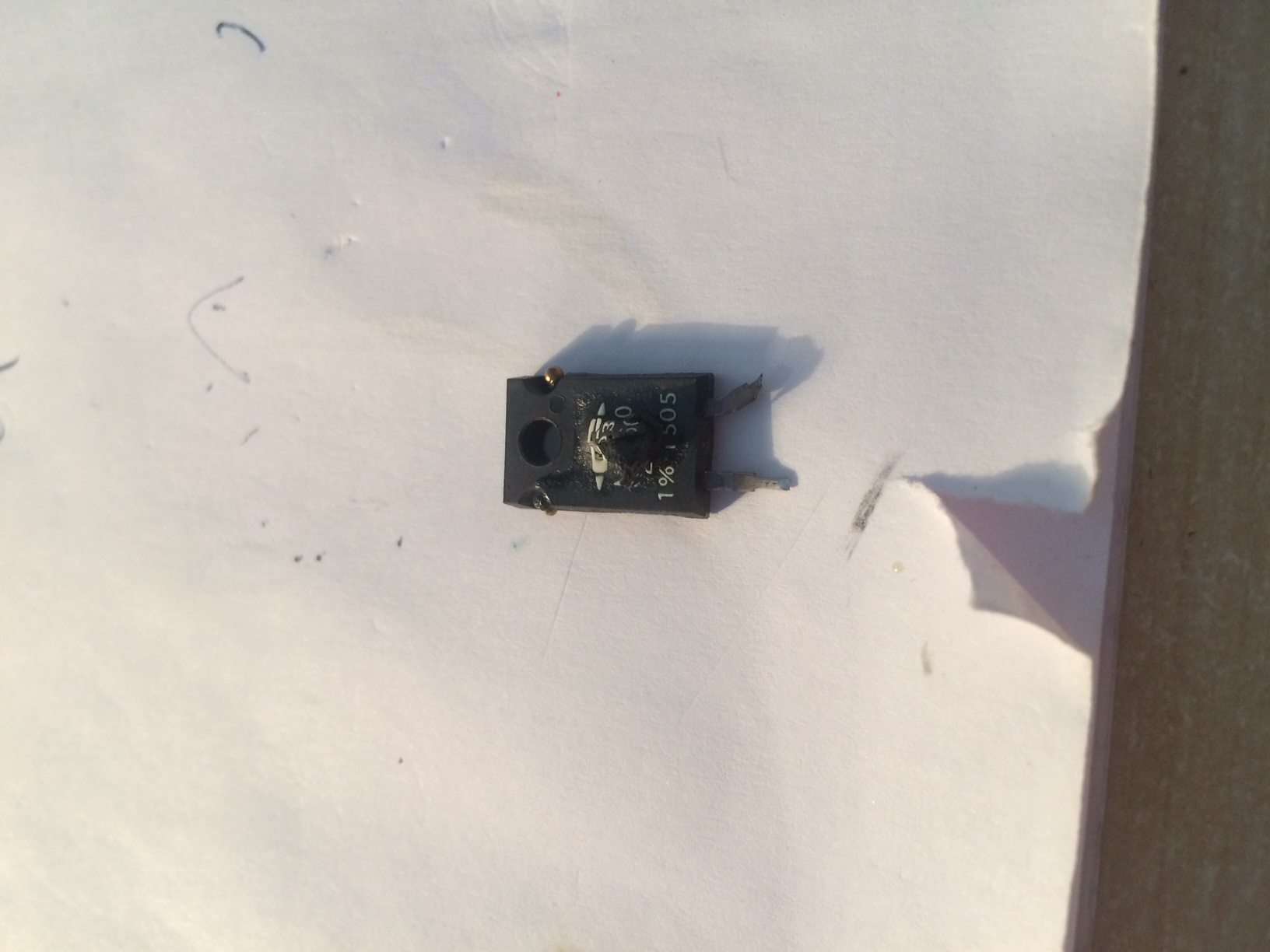

4.) Finally something i had to experience: check if the sinks are mounted strong enough... 🙁🙁🙁 After the first test everything looked fine and i wanted to do some final measurements until I took a closer look on my resistor...
The screw got loosen so the heat was not transported correctly... After buying new resistors I realized that due to the broken resistor also one of the leds blew up...
Anyway, I finally finished my DCB1 and i love it!!!

Quite an eventful but well done DCB1 in the end. Congratulations.
What comprises the rest of the system it plays in?
For how much hot-rod current you finally opted in that box? What is the volume pot and what is those control knobs diameter by the way?
Same Questions here, oh and is that a soft start you are using?
R.
The resistor that blew up was a 2.5R Caddock, reduced to 3R in the end. (it worked with the 2.5 but it was still really hot, and i do not want to get into troubles during summer 😎...)
Vref is at 1619mA and 1685mV resulting in 539mA and 561mA.
The offset lies at 1.1 and 0.1mV (what i am really happy about!)
Diameter of the knobs is 30mm and yes, thats a softstart and DC-filter circuit 🙂: http://http://www.diy-audio-shop.de/produkt/dc-filter-mit-softstart/
For the moment I use an SymAsym as poweramp and the new M-DAC+ from Audiolab as input. The speaker is built by my own (its an Elip2 from http://www.lautsprecherbau.de)
