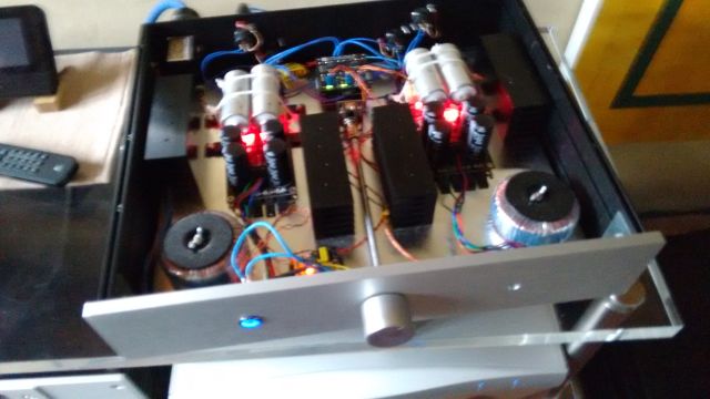

I finished my balanced dcb1 some time ago, but never posted a picture - but here it is.
I made a balanced version (two boards) with a stepped volume control sold by earfanatic on diyaudio (I think he does not sell them anymore) which includes a remote control. I used naked resistors on the output and Russian teflon FT3 as bypass caps. Signal-cabling is Neotech silver.
The boards are on a thick aluminium plate (about 1.5cm) and some heatsinks are installed on the plate as well, hotrodding is at level 2 (600mA). This all goes to about 35 degrees when in operation.
Sound is glorious ... much better than what I expected.
Thanks Salas and all to make this possible and for all your help on the forum.

Thank you very much and congratulations! I know that dual DCB1s balanced configuration and specialized passive components choice can be an expensive enough thing to build but repeated positive feedback including yours persists that is well worth it. So I wish you many years of happy listening sessions with it. What comprises the rest of your system by the way?I finished my balanced dcb1 some time ago, but never posted a picture - but here it is.

Thanks Salas for the nice words.
I attach a picture of the rest of my system. I just finished building a beta24 power amp from amb.org, this one also sounds glorious. DAC is a dcs debussy with a puccinini clock. Speakers are gallo reference 3.5 and most signal cabling is Neotech silver. Musicsever is based on mpdpup and a USB isloation card by SOTM, powered by two diy linear power supplies. The diy pre- and poweramp replaces a Pass INT150, the sound of the separates is just plain better. 😀
