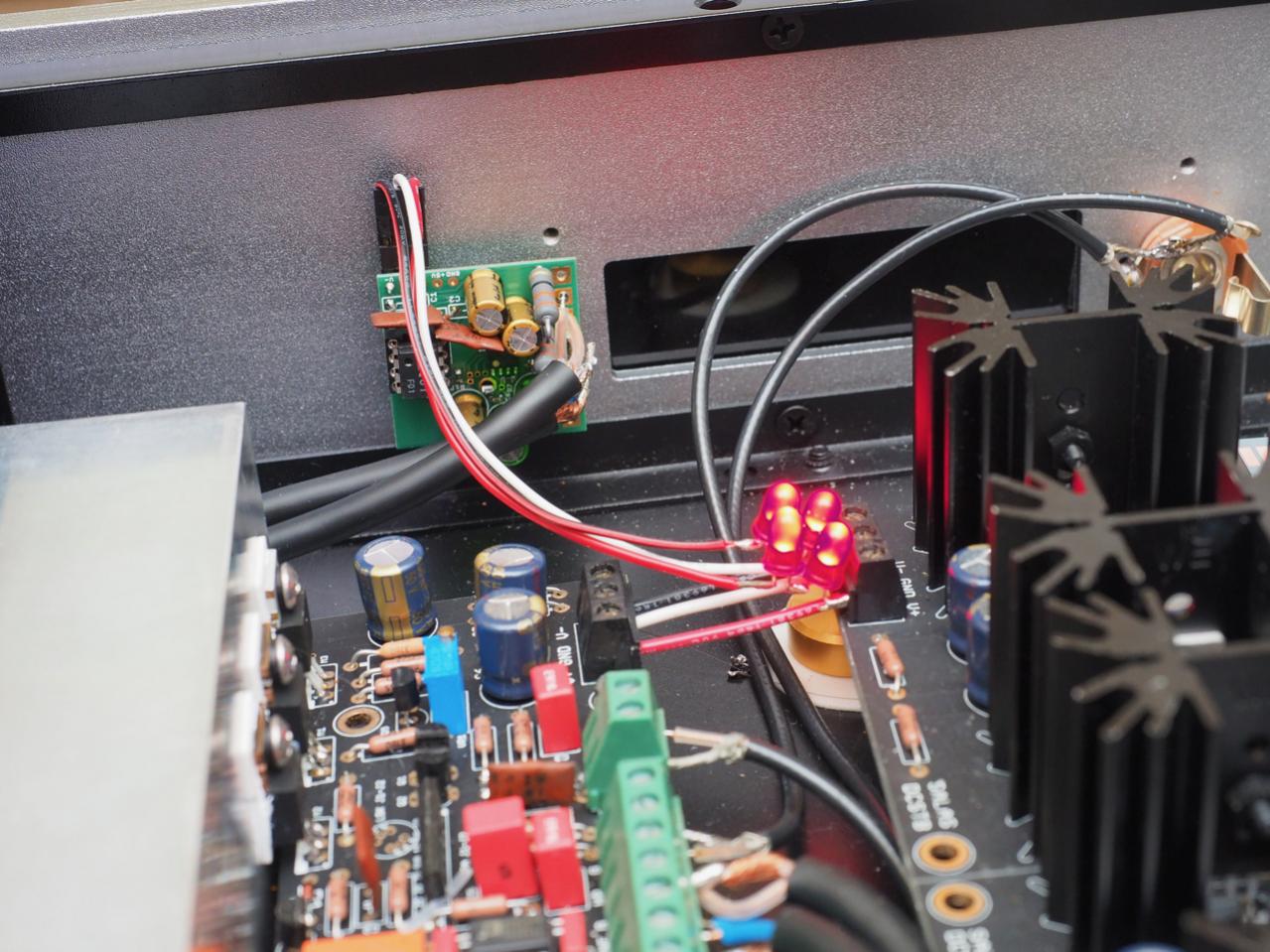

Hey Salas, I got this Muses Volume control from one forum member: http://www.diyaudio.com/forums/swap-meet/309320-muses-volume-attenuator-kit.html
https://www.dropbox.com/s/qt4uxrzfmxoo8n7/Muses Volume Control English.pdf?dl=0
I am planing to use it with the preamp. Do you think it is ok? I never had any experience with such setup, it requires +/- 15V PSU so I am planing to use some simple LM regulator psu. How Critical do you think is quality of PSU for such volume control and another thing, what do I do with grounds of preamp and Muses PSU? Thank you.

I just use the power from one channel of the DCSTB and connect with 2 red leds to drop few volts.

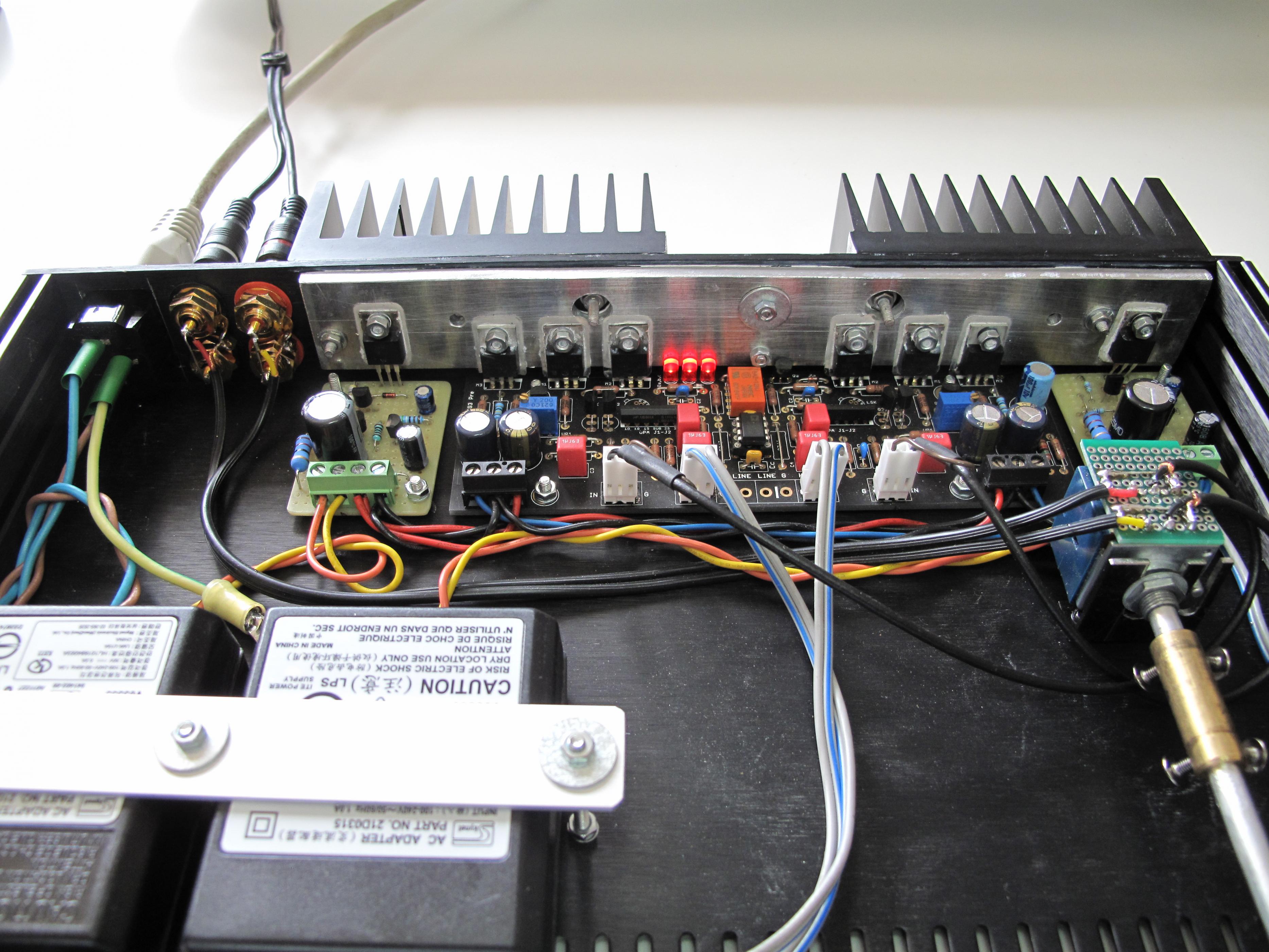

Seanwu thanks for replying to PKI since I have no practical experience with the MUSES. By the way how is your sound now after enough time with the DCG3+MUSES and can you post a build's picture for PKI so he can see the MUSES grounds wiring in the whole preamp configuration?
Attach your pics.............
ups...looks there's something wrong with photobuckit...will try to fix it...but pictures are not important...

Yes, pictures would be nice! I will be comparing two volume controls in the preamp: that Muses and r-2r relay based one to chose which one i like better.
I am just not sure if there is any benefit of using separate PSU for volume controllers or it is useless and overkill.

As a newbie, I just use the easiest way to do it.
Thanks Salas for the good design and detailed document. Also thank Tea for the quality kit parts.

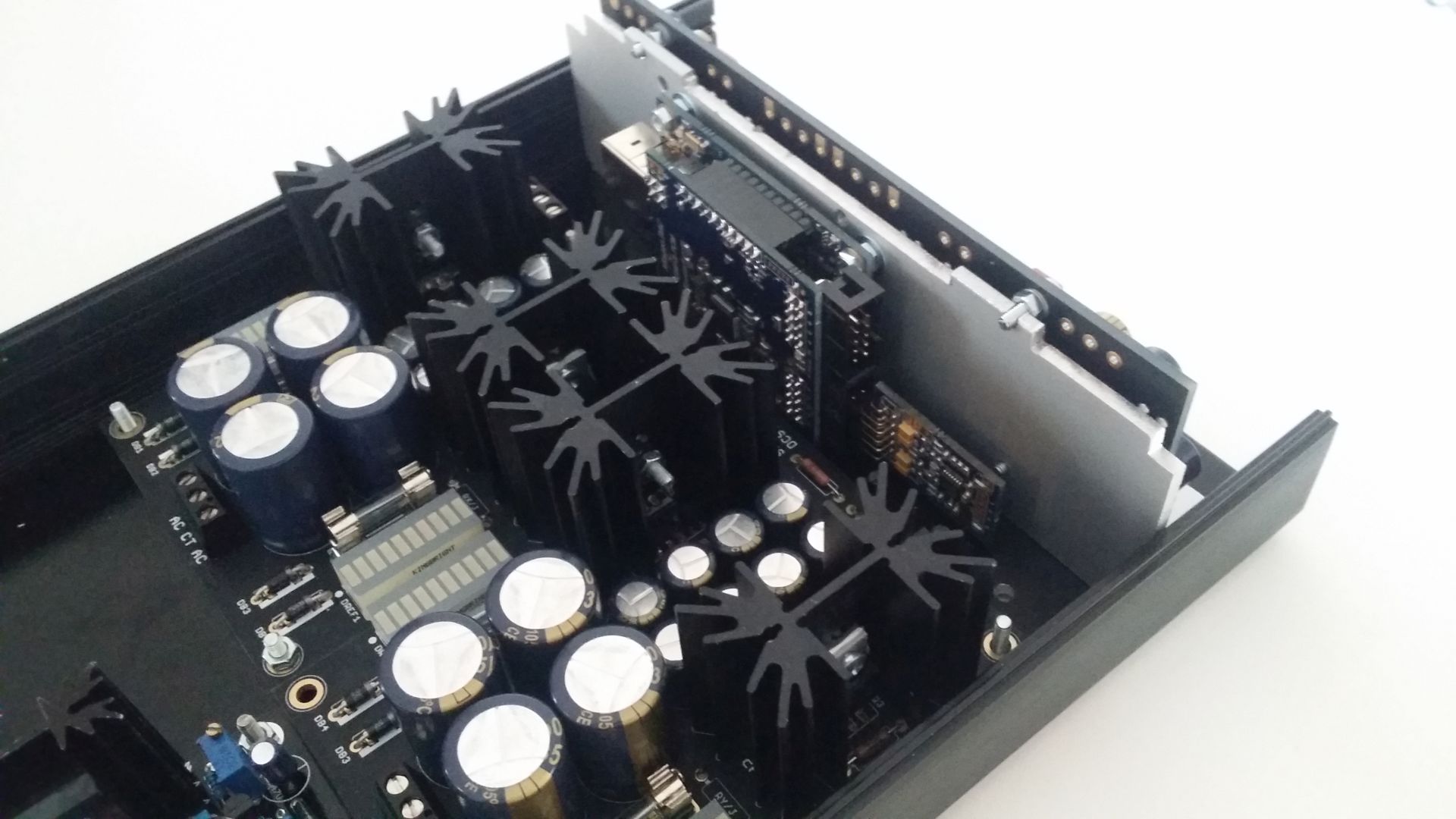

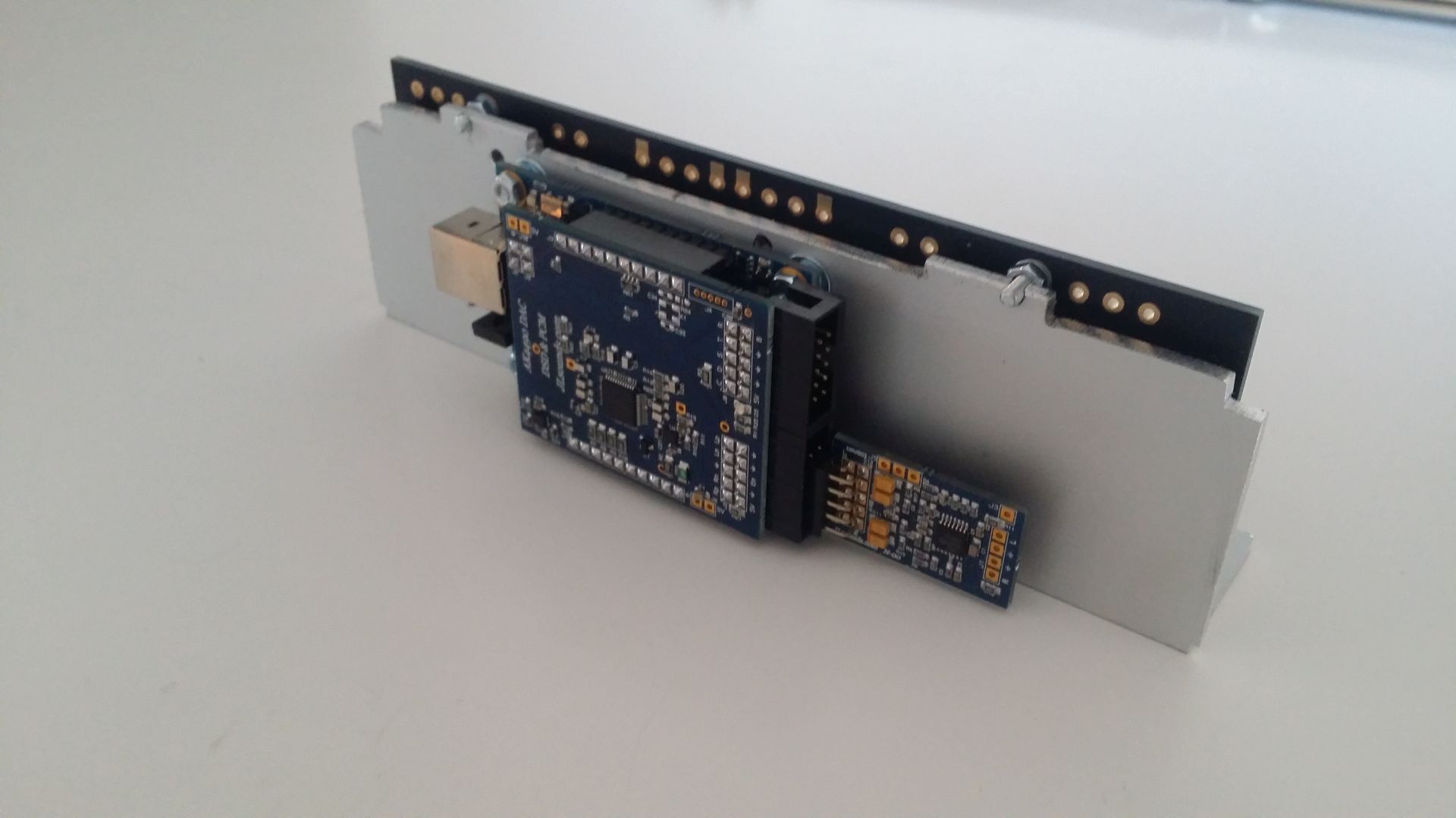

Attaches are the pictures of my build. Hope it helps.

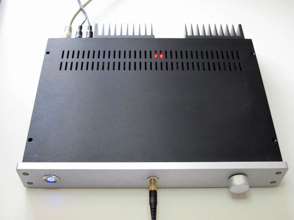

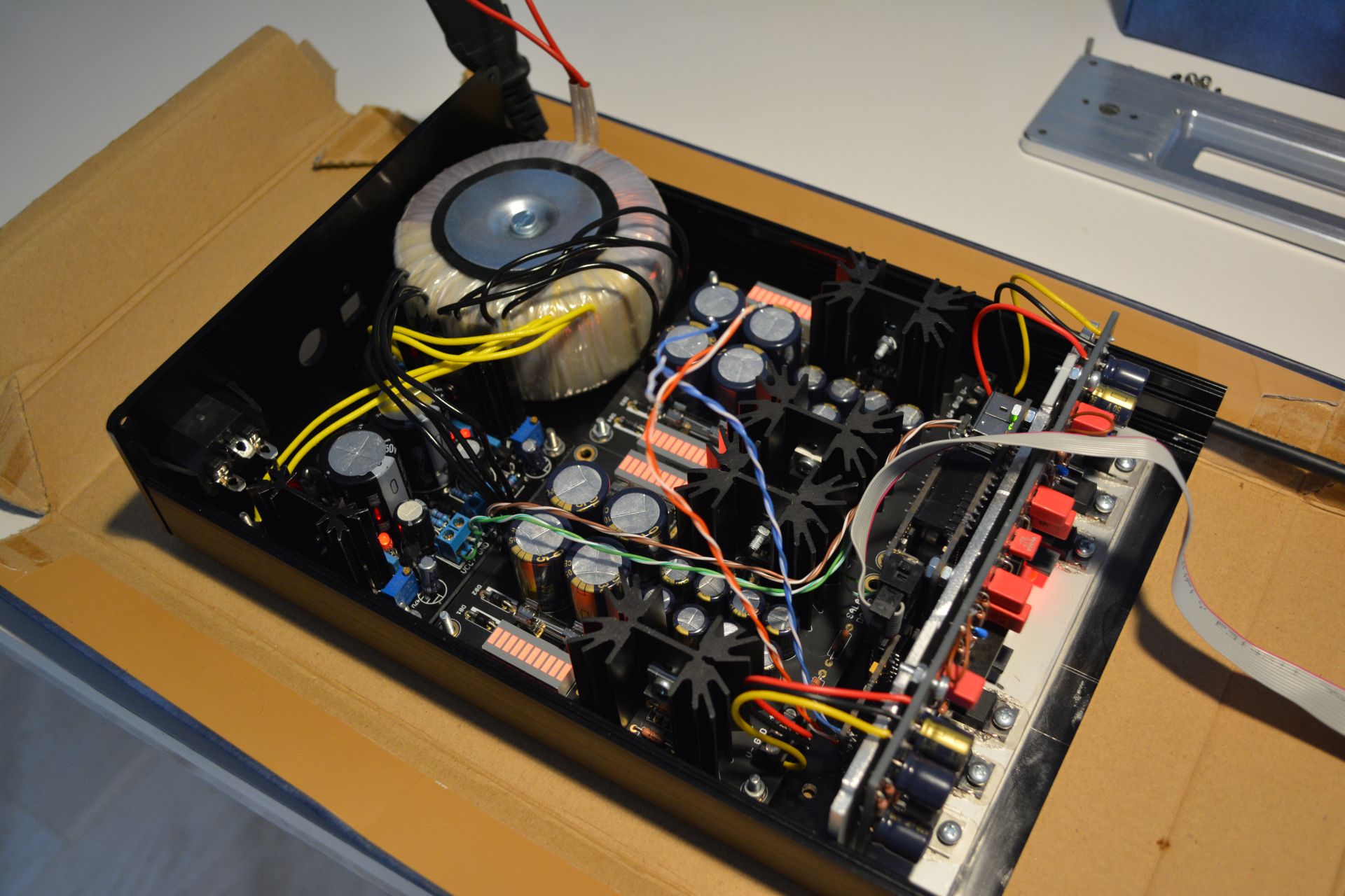

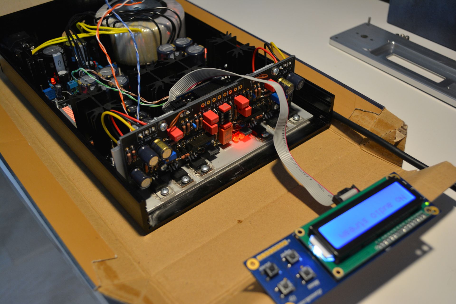

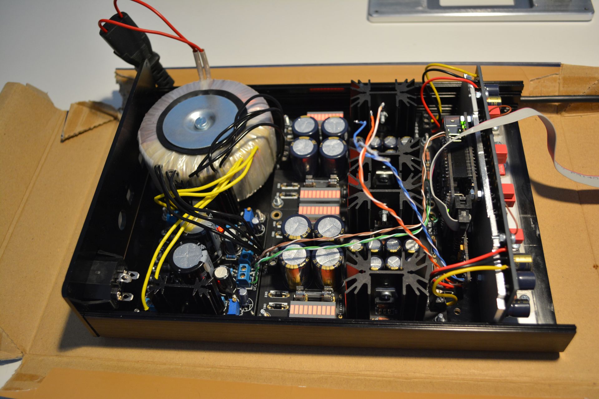

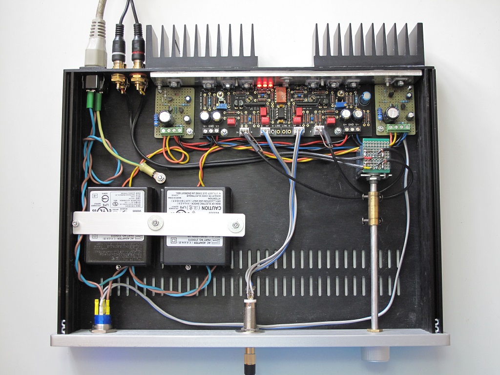

DCG3 finally boxed...
Some pics of my DCG3 finished today. It took a while, board was ordered on the first GB end 2016...
It use two old SMPS cartridge each providing 30V followed by two linear regulator TL431 based, that allowed using of a small form factor box : a Modushop Galaxy 40mm height.
It sounds very good, thanks Salas and TeaBag !
That's the most compact build shown this far. Congrats. What headphones you use?
Thanks,
An AKG K240 MKII

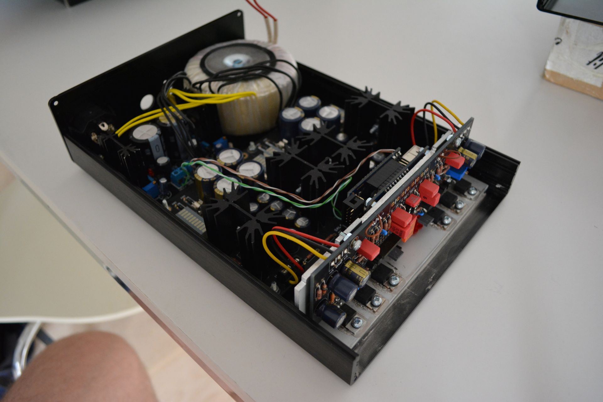

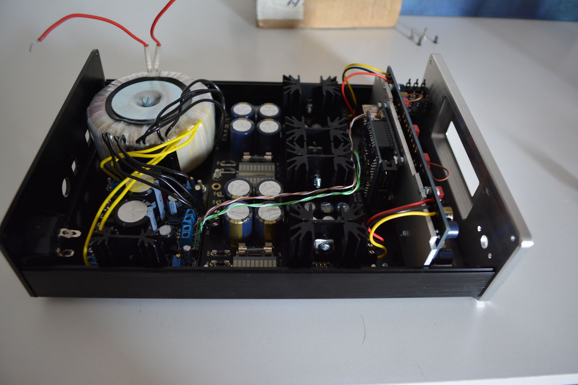

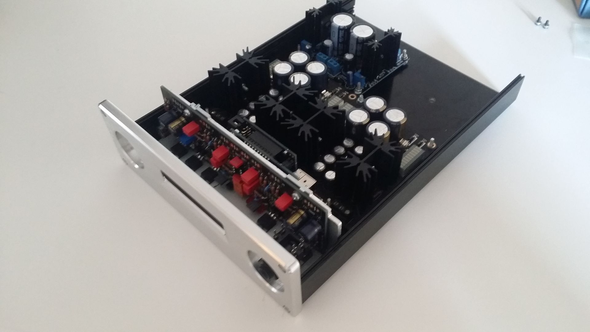

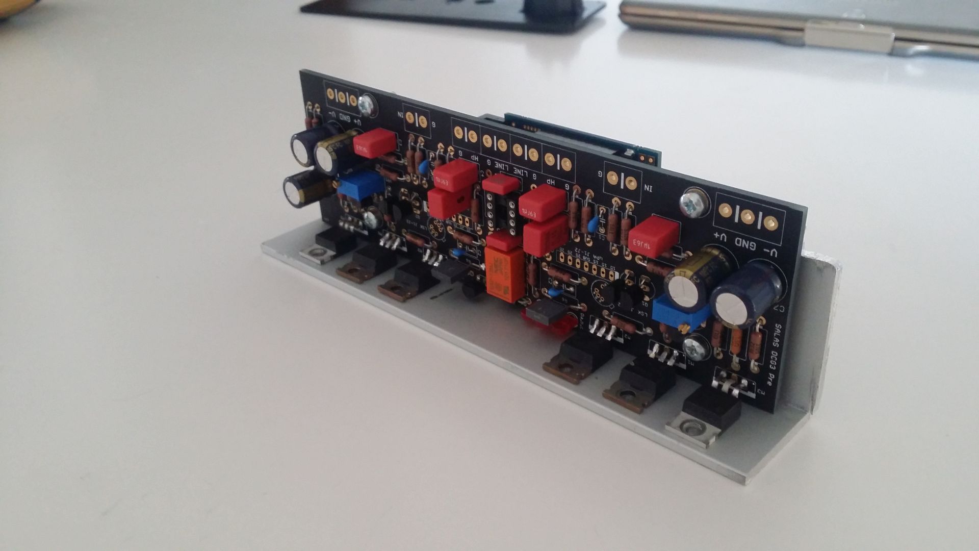

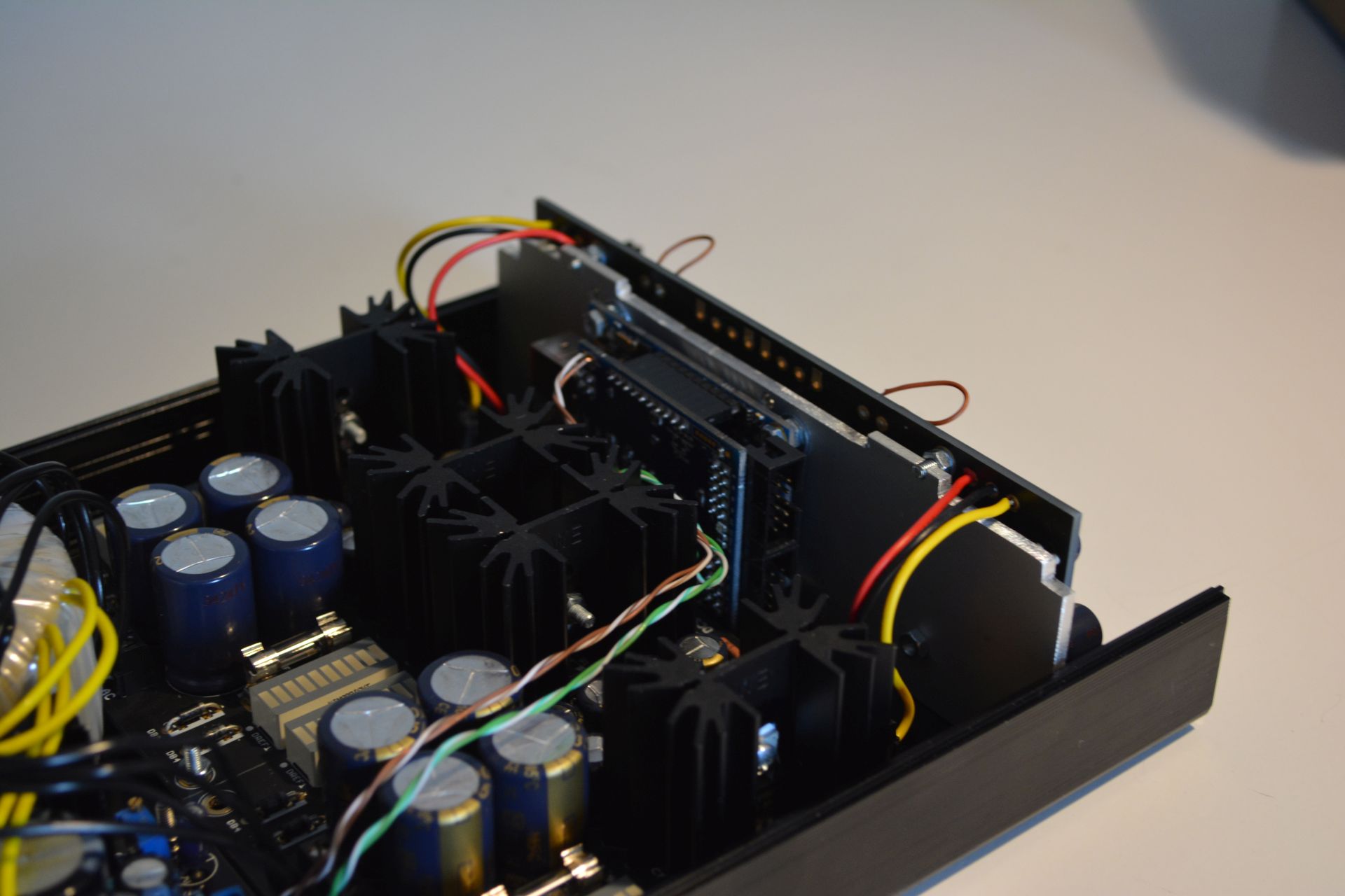

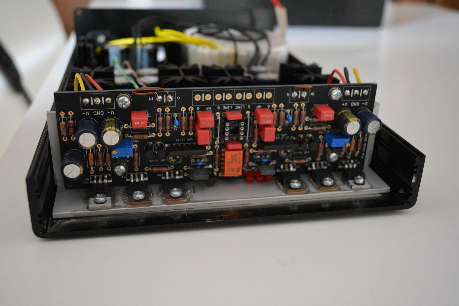

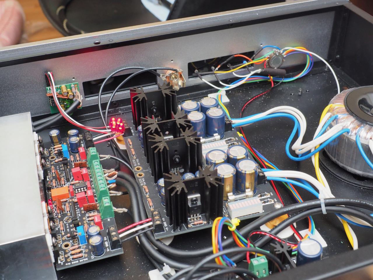

On saturday I finally receive Chines aluminum case...
It turn out to be a little small as I didn't have all components in my hand when I was ordering the case...
so...it's compact...low or no heat dissipation...maybe it will melt down 😀
will see, will it do the trick 😀
so this is Jlsounds USB/I2S/AK4490 DAC with Salas DCG3 combo 😀
still in progress...
was thinking to go with jfets K170 but the layout is not design for them, so I would have to band their legs, which is a little complicated
so at the and I'm going with ''stock' version 😀
I have a little desbalanced voltage on power supply on one channel, but Salas say not to worry about it..so I will not...( one side have 18.30 on +/- but the other one have like 18.21 and 18.39 V)...I'm not shure is it 18 or 17V without the load...
So, here are some pictures of work in progress, will get back and report how it sound, once I finish it

I've been always fascinated by small crowded boxes. To my eyes this is an excellent build! I think heat dissipation is marginally OK.
