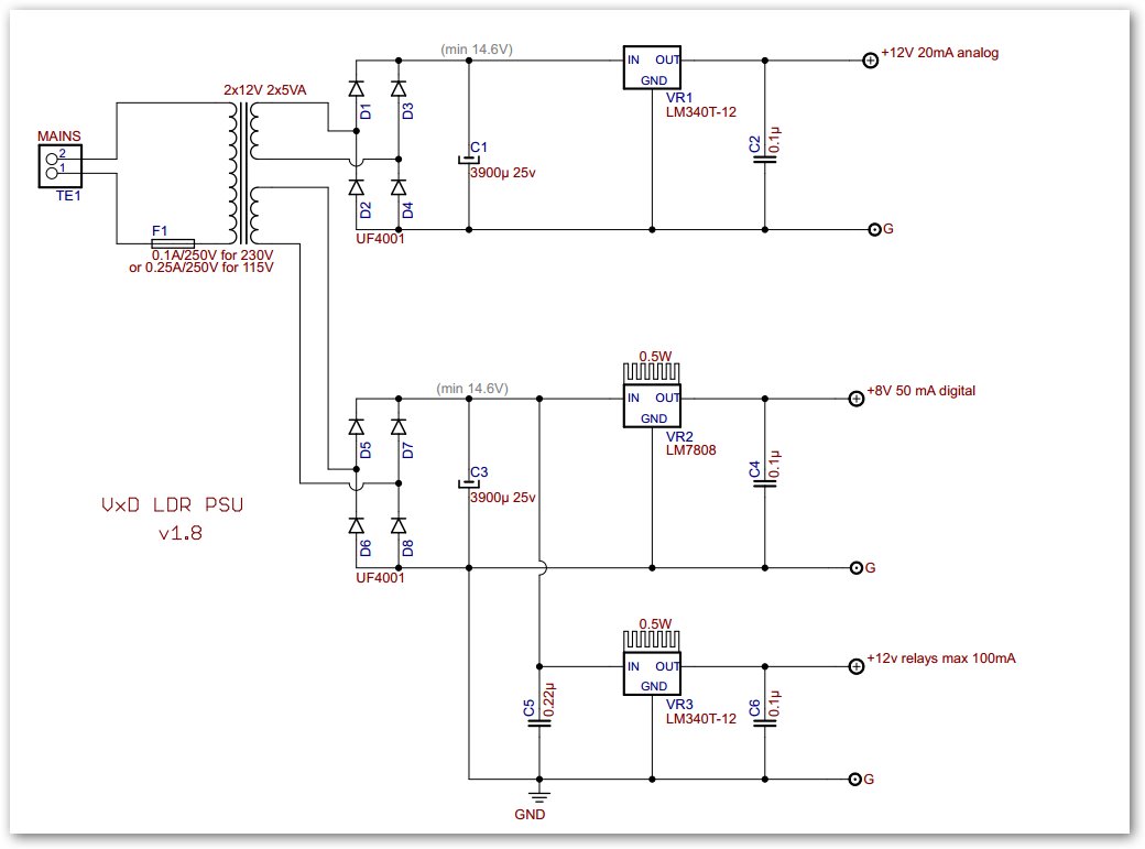

Please a question concerning the power supply 17,5V. dual DCSTB (if groupbuy has leftover 😛), could be further cascoded to reach 12v. and even 8v. To power together with Salas DCG3 preamp, an http://www.diyaudio.com/forums/analog-line-level/278667-arduino-based-ldr-volume-source-selection-controller.html
I would like to use: LT3045-M Ultralow-noise (0.8µVRMS) LDO linear regulator 0V-15V - 500mA (1V Step)
Instead of their original matching power supply, I thing also to the expense, has associated low quality and high noise transformer and regulators, please see attachment :
Yes you can cascade (chain) further lower voltage regulators from the DCSTB's output to feed various subsystems. Or from its raw DC nodes. DCG3 itself needs around +/-17V to function properly. Don't change that. Things to watch are not to draw too much additional current for subsystems overloading the given sinks (they are good for up to 150-170mA per polarity but you can use taller ones if you must draw 200-250mA /polarity) and to use TO-220 type rectifier diodes in the DCSTB's raw DC section so not to overload smaller ones. There are alternative pads for such diodes already. If the fuses will kick, uprate them.
Another simpler thing you could do instead of adding further regulators for subsystems since DCSTB is already a low noise and low impedance voltage referenced Sziklai pair capacitance multiplier, is to drop the needed voltages from its output with simple RC cells tailored for each subsystem. Sometimes passive filtering for voltage drop is all you need. Surely benign for self noise at least.
Totally separate subsystems PSU as in your drawing is of course a very good solution regarding their isolation to the main preamp circuit.
