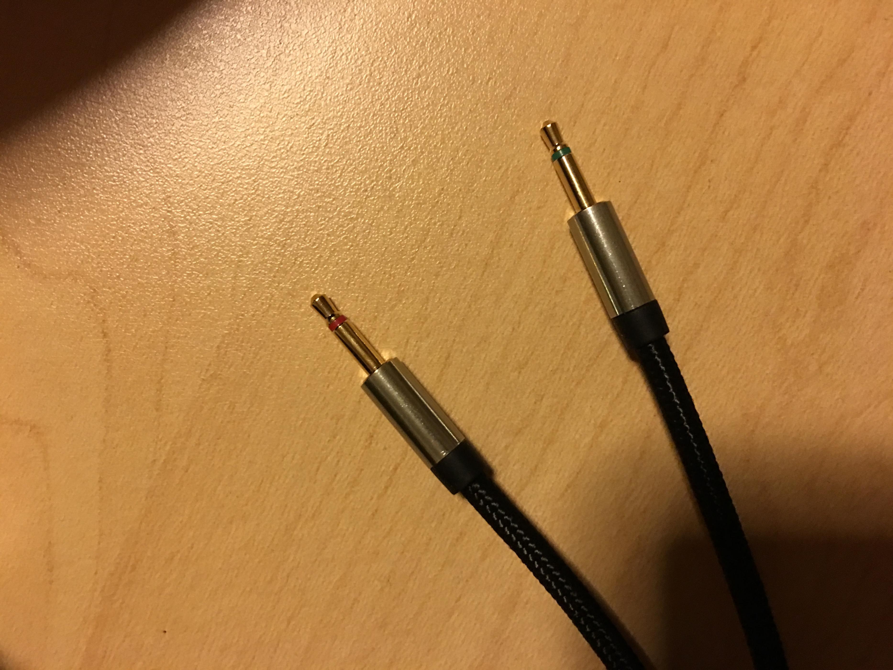

I got Rev2 of Monolith headphones and Monoprice fixed the most of things that people complied about. Please see attached images. Cable is 6FT now and 2,5mm connectors instead of MMCX. I assume they use some type of electropolish with anisotropy etch to fix sharpness of girls. More material removed from edges and less at the thick portion of these bars. It is very smooth now. Some guy already made a video about Rev2: https://www.youtube.com/watch?v=YE3Zu6vjZzU
