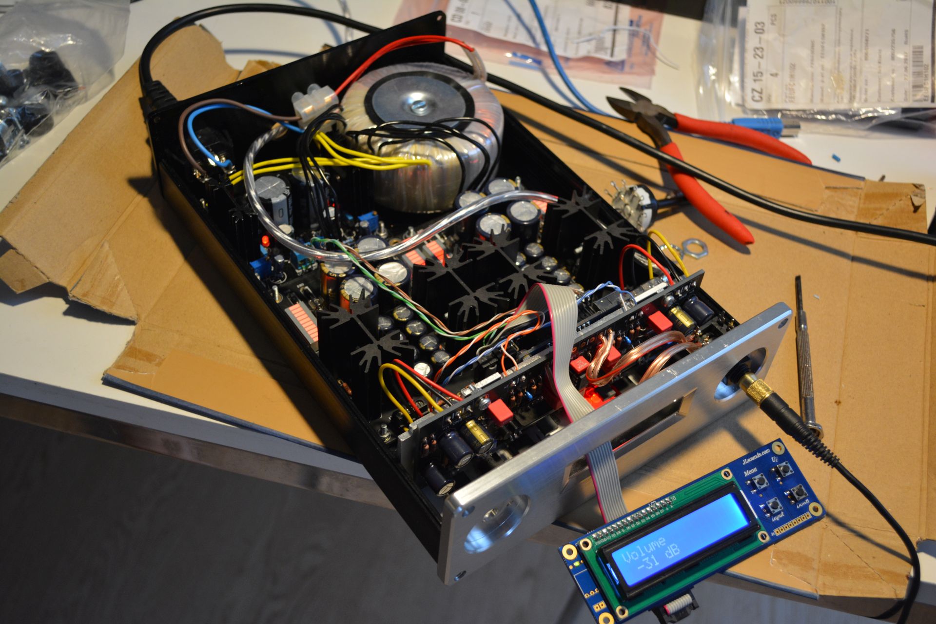

Interesting compact combo. BTW matched 2SK170BL pairs can alternatively go in the UPA pads too. There are DGS-SGD designations on the silkscreen to guide. No need to bend pins if there will be no thermal coupling. They will just face inwards and outwards. The servo tracks DC offset so it can be practically feasible. Don't apply >18V rails when using a servo op-amp that can not accept it. You could check the PSU before connecting to the system with 150 to 200R 5W dummy load resistors but its doubtful that it will lose enough output because it has low output impedance. If its because the LEDS and/or JFET CCS tolerances in the PSU went enthusiastic try higher source degeneration resistors. R1 & R2 in DCSTB are 33R. Try 100R. Less current will run through the LEDS to tame their combined VF.On saturday I finally receive Chines aluminum case...
It turn out to be a little small as I didn't have all components in my hand when I was ordering the case...
so...it's compact...low or no heat dissipation...maybe it will melt down 😀
will see, will it do the trick 😀
so this is Jlsounds USB/I2S/AK4490 DAC with Salas DCG3 combo 😀
still in progress...
was thinking to go with jfets K170 but the layout is not design for them, so I would have to band their legs, which is a little complicated
so at the and I'm going with ''stock' version 😀
I have a little desbalanced voltage on power supply on one channel, but Salas say not to worry about it..so I will not...( one side have 18.30 on +/- but the other one have like 18.21 and 18.39 V)...I'm not shure is it 18 or 17V without the load...
So, here are some pictures of work in progress, will get back and report how it sound, once I finish it

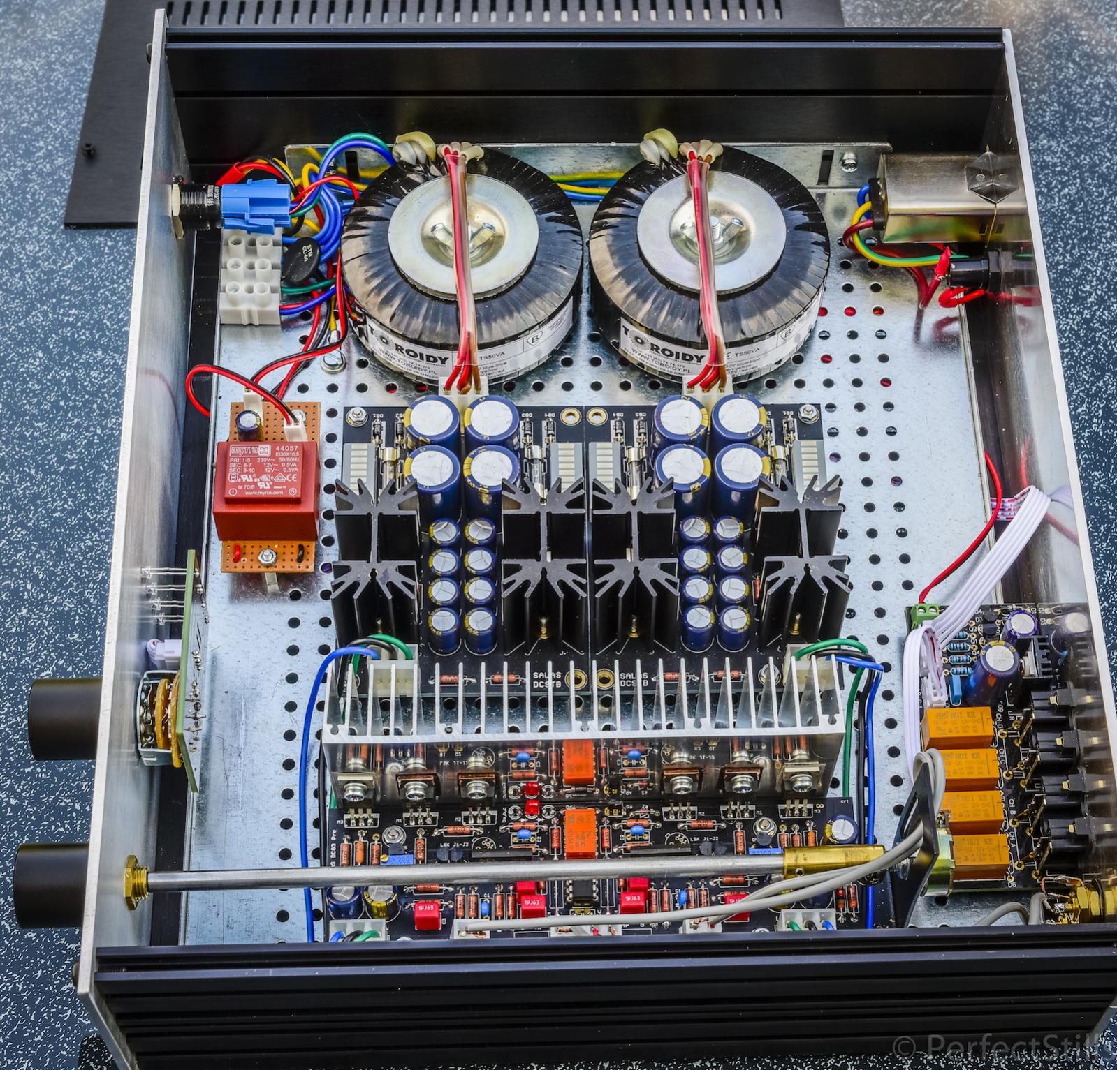

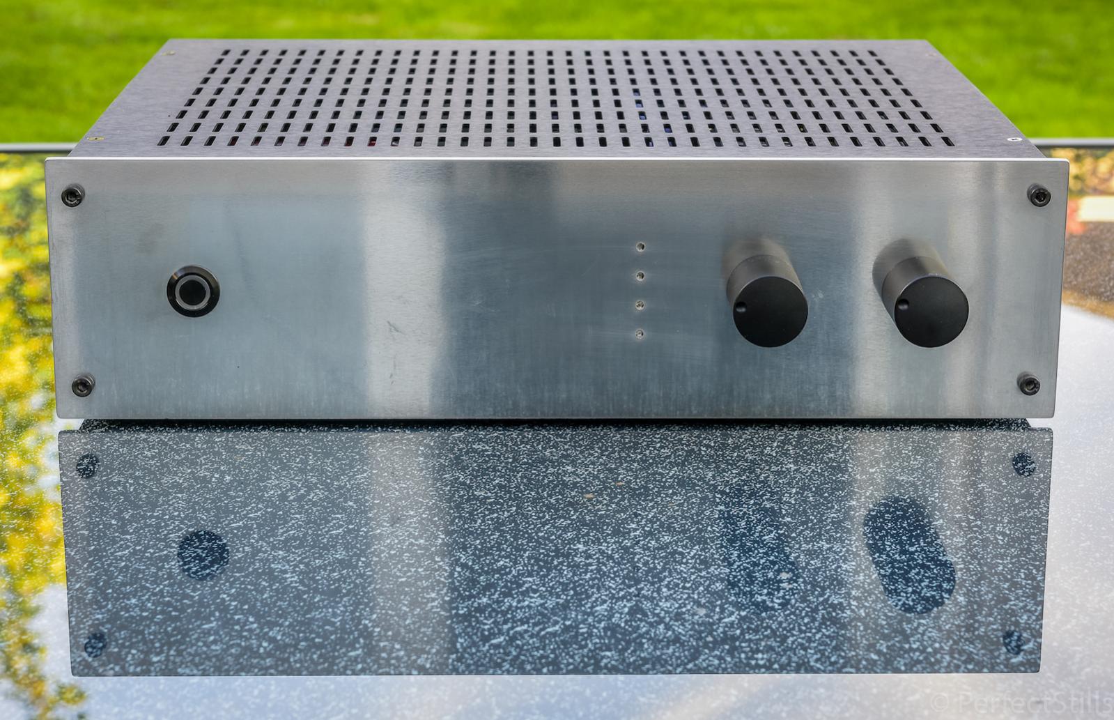

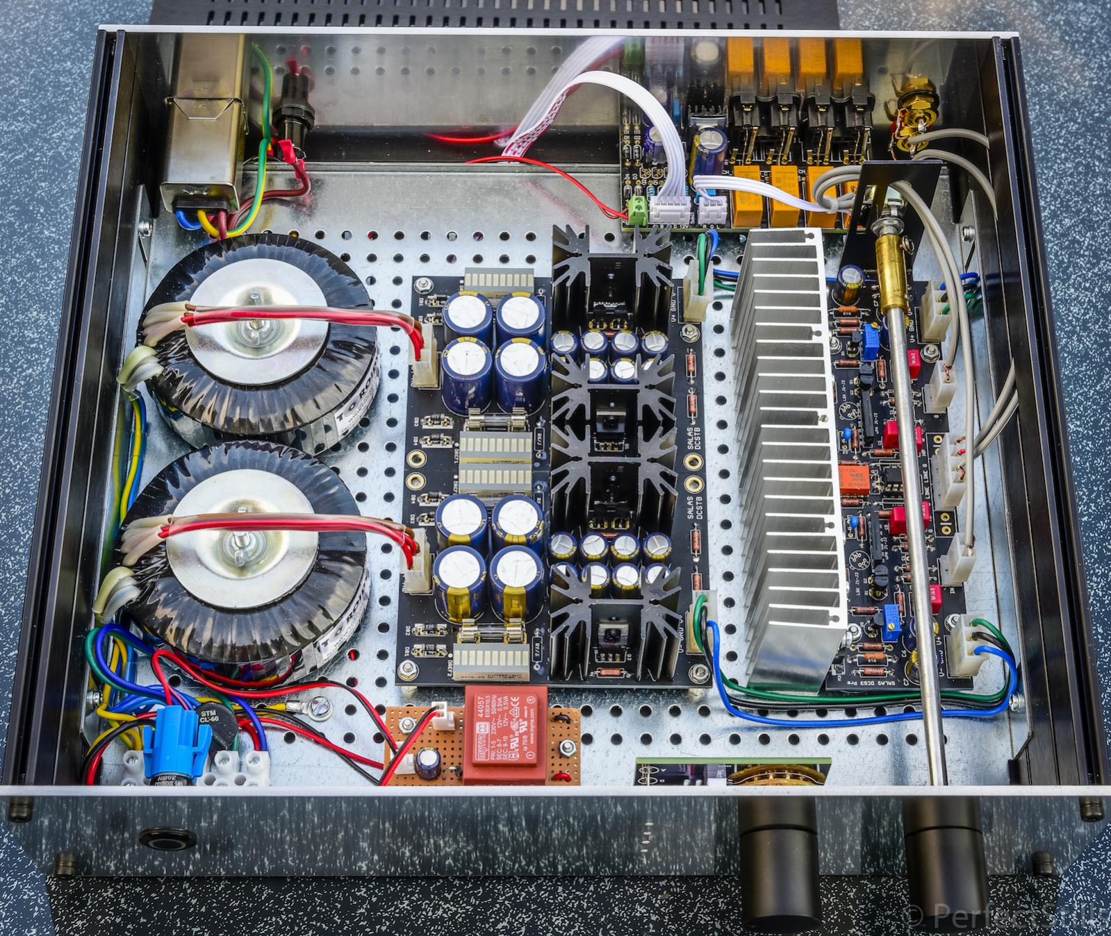

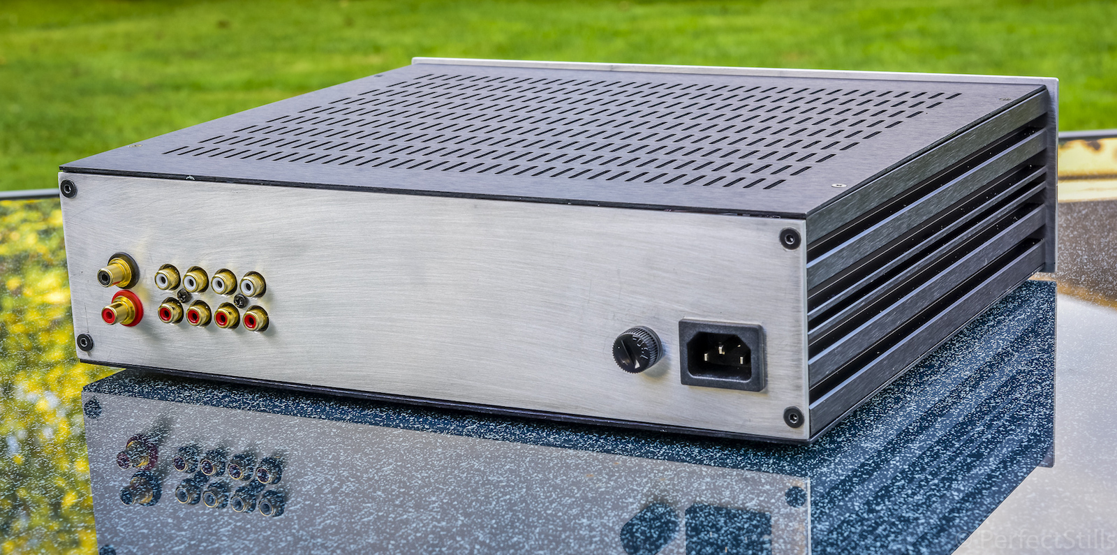

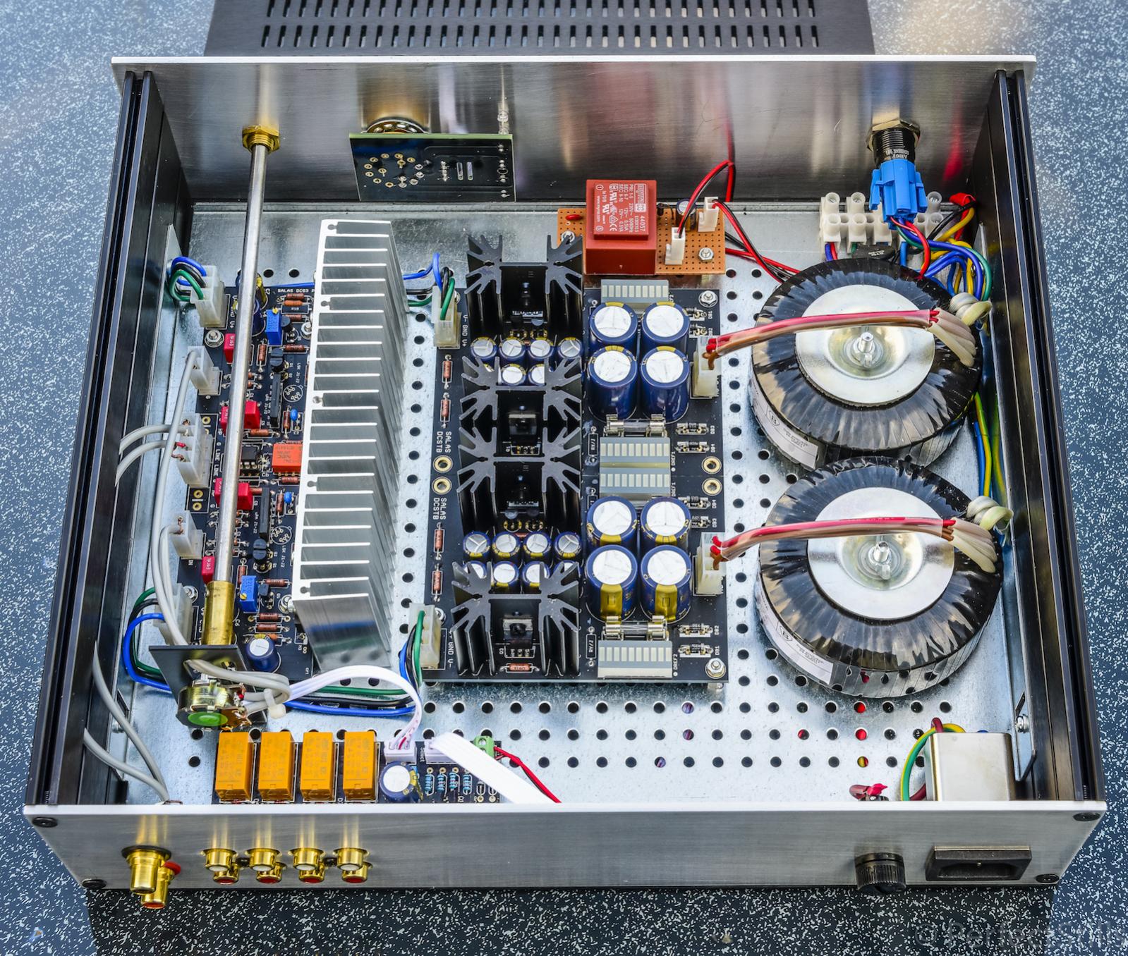

Just finished a DCG3 Build in a Galaxy Enclosure!
The sound is quite incredible - I've never heard anything quite like it!
A very big Thank You to Salas for sharing such an amazing piece of work, and to Tea for putting it into a kit that fits together like a jigsaw!
If you are still just thinking of building one then please take my advice and do it, you will be amazed too!

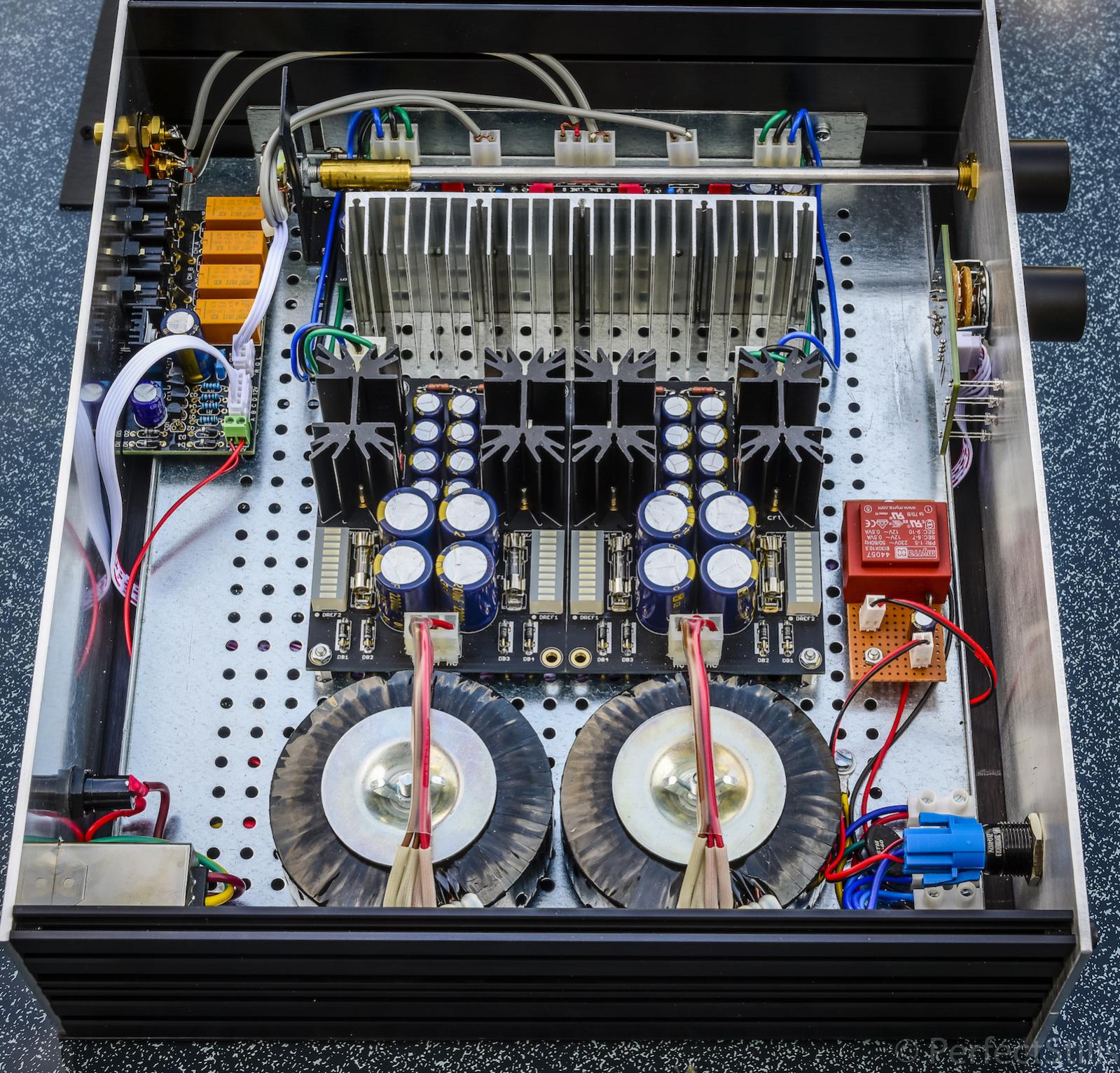

Congratulations.
Very sturdy and well ventilated. Your really built it like a tank. Alpha pot carbon (?) can be quite pleasing also.
Nice to know that you like the outcome so much.
The voltage on PCB, under load is 17,20V so I hope it will last 😀
I didn't notice that SK170 could go into UPA place...now it's too late as everything is soldered and I just wanna close the case and listen music 😀
no more modifications 😀
still have to modify front place to accept some rotary off/on switch
and have to disolder LCD from display board as it cant fit on front plate of the case...it will take some time to that...

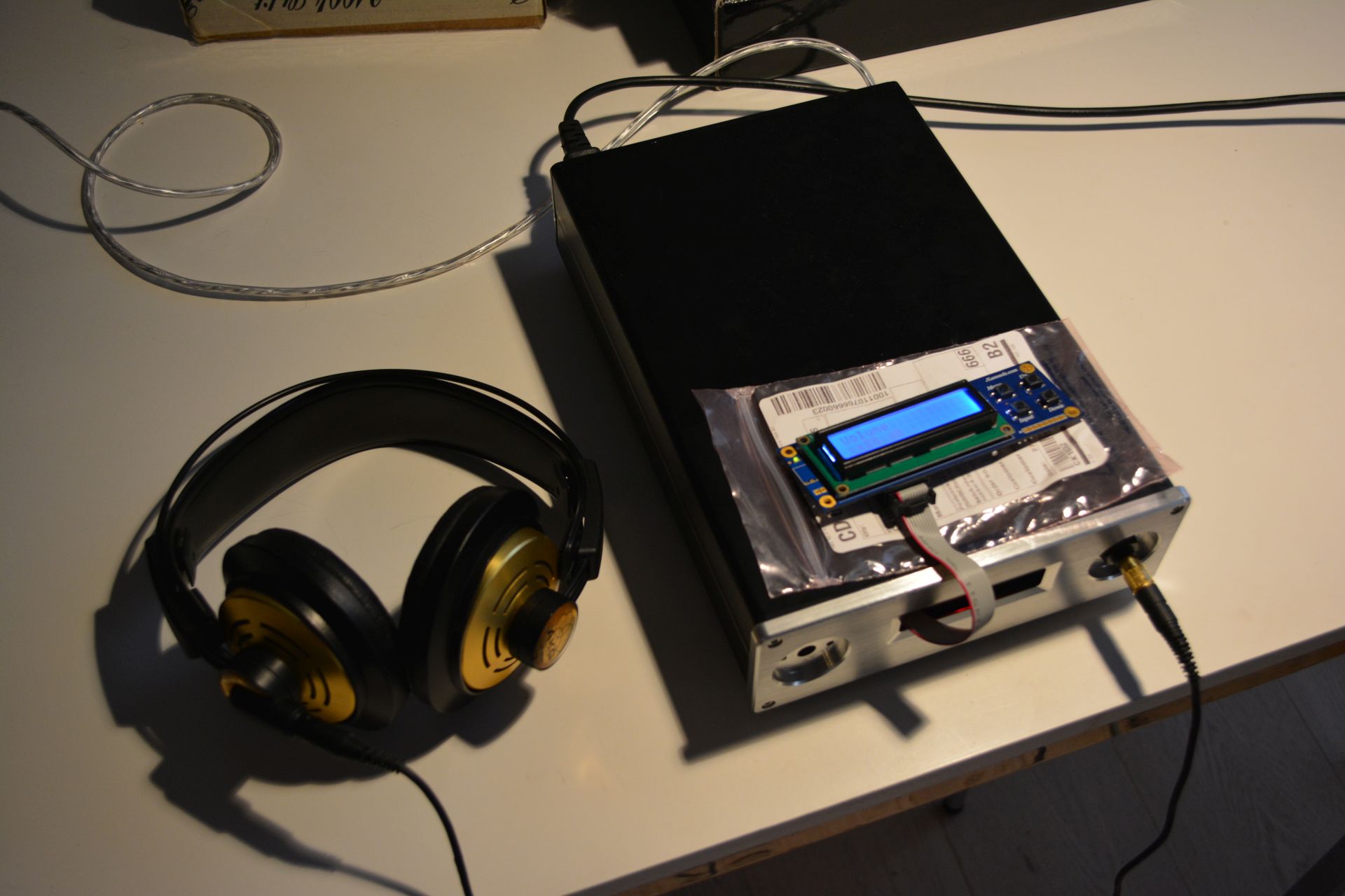

one more picture before I place top cover 😀
the case is around 170x280x55mm, so preaty compact...
no noise, no hummm...
for now 😀
Toroid is 4x18V 1.3A
and 2x6V 1.3A
