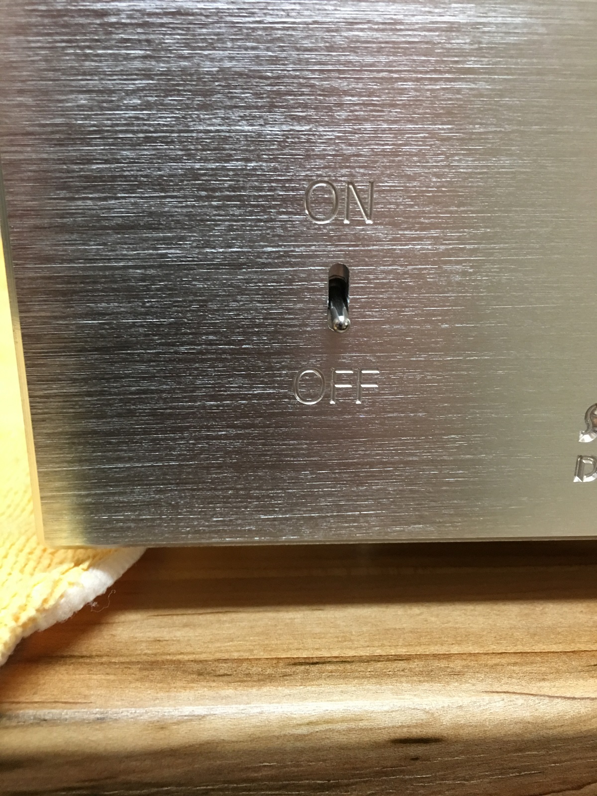

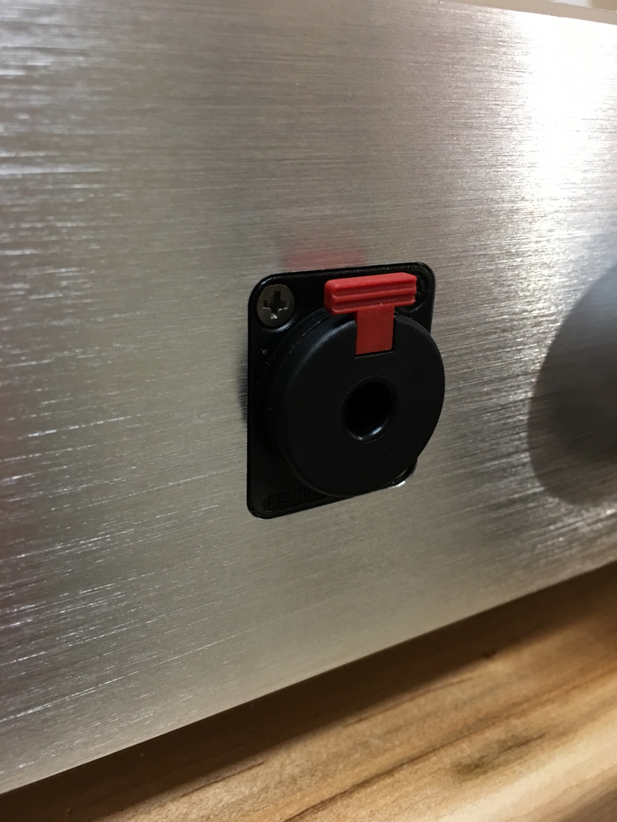

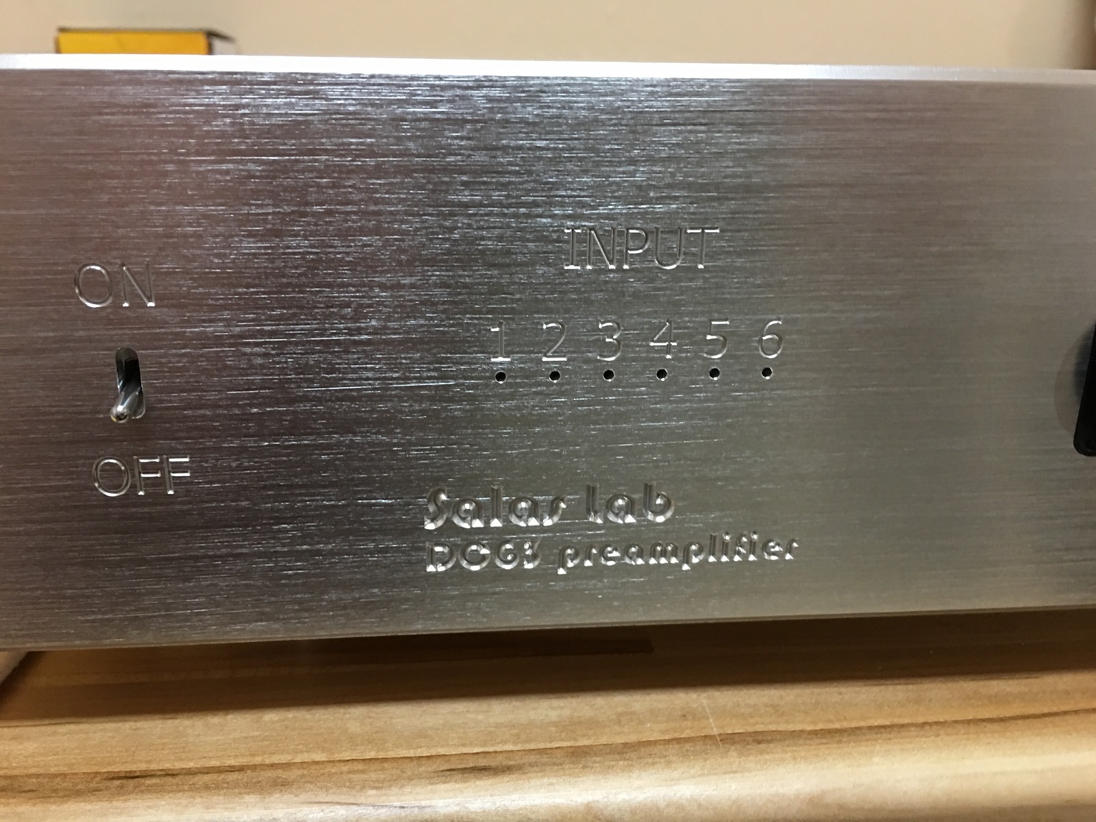

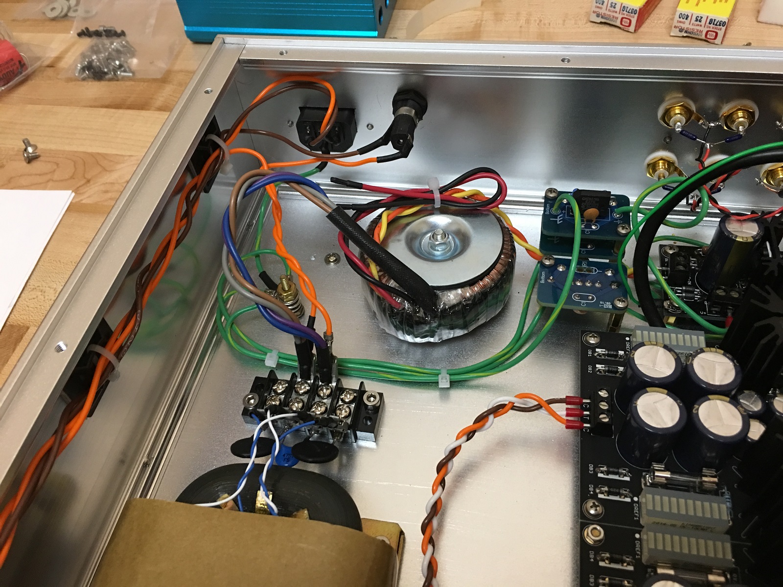

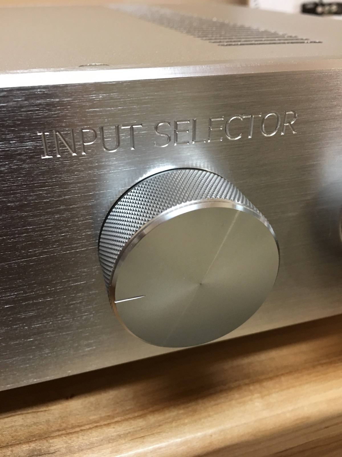

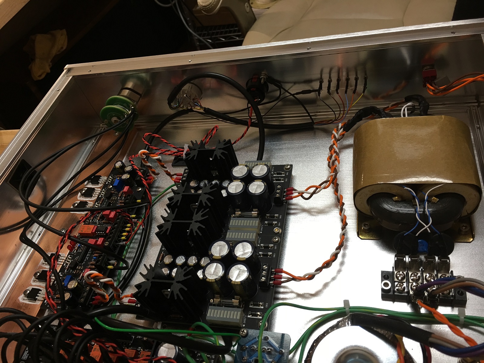

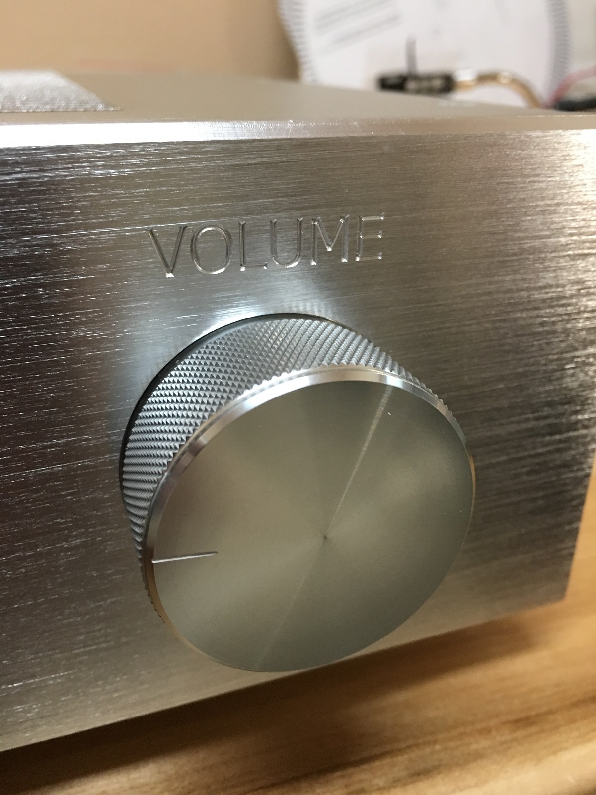

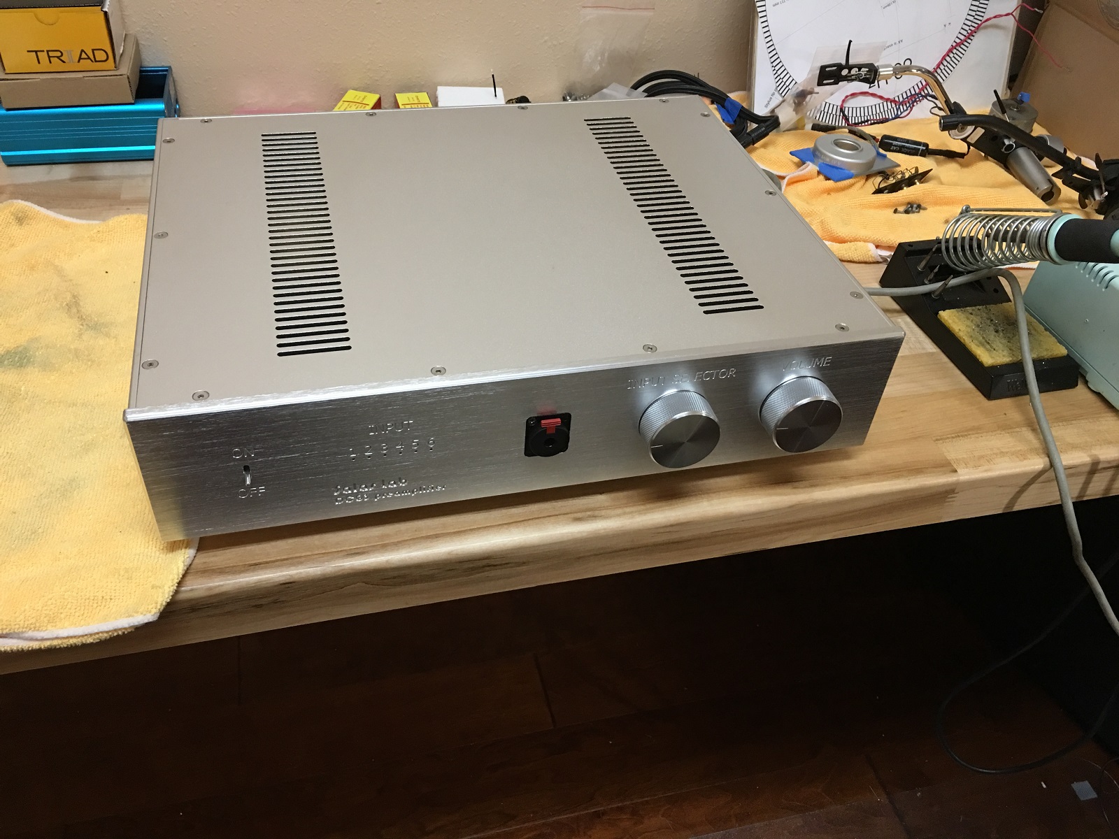

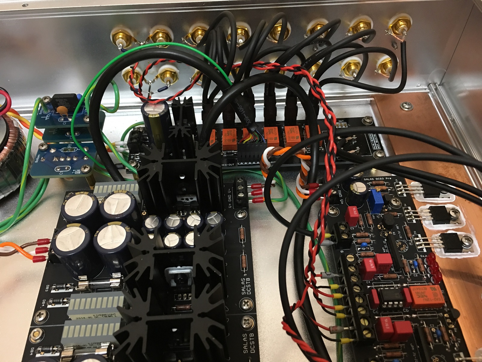

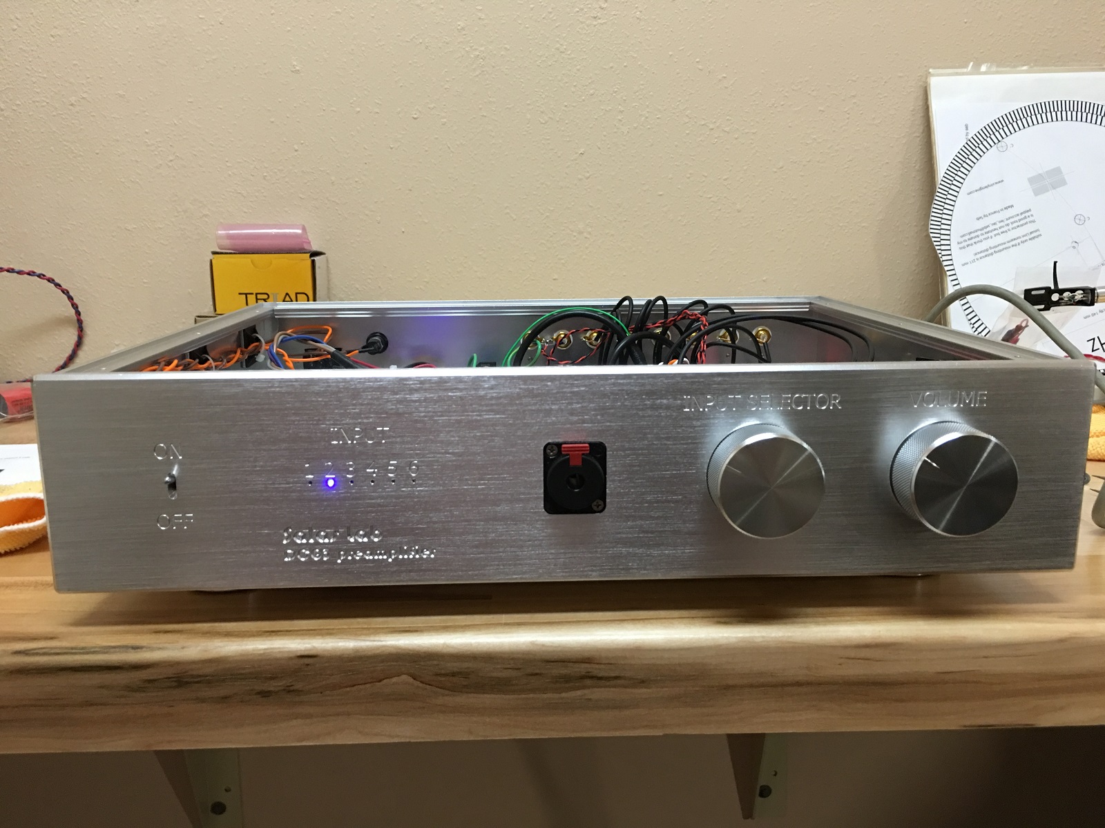

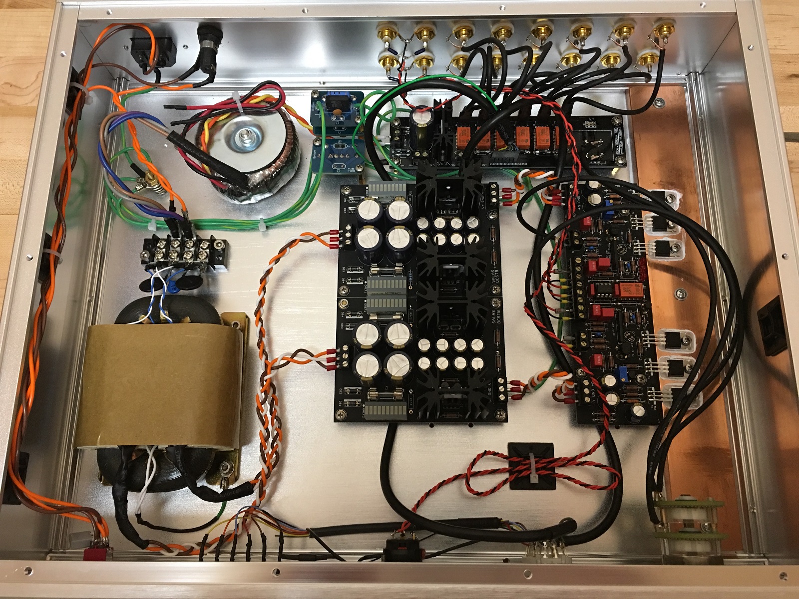

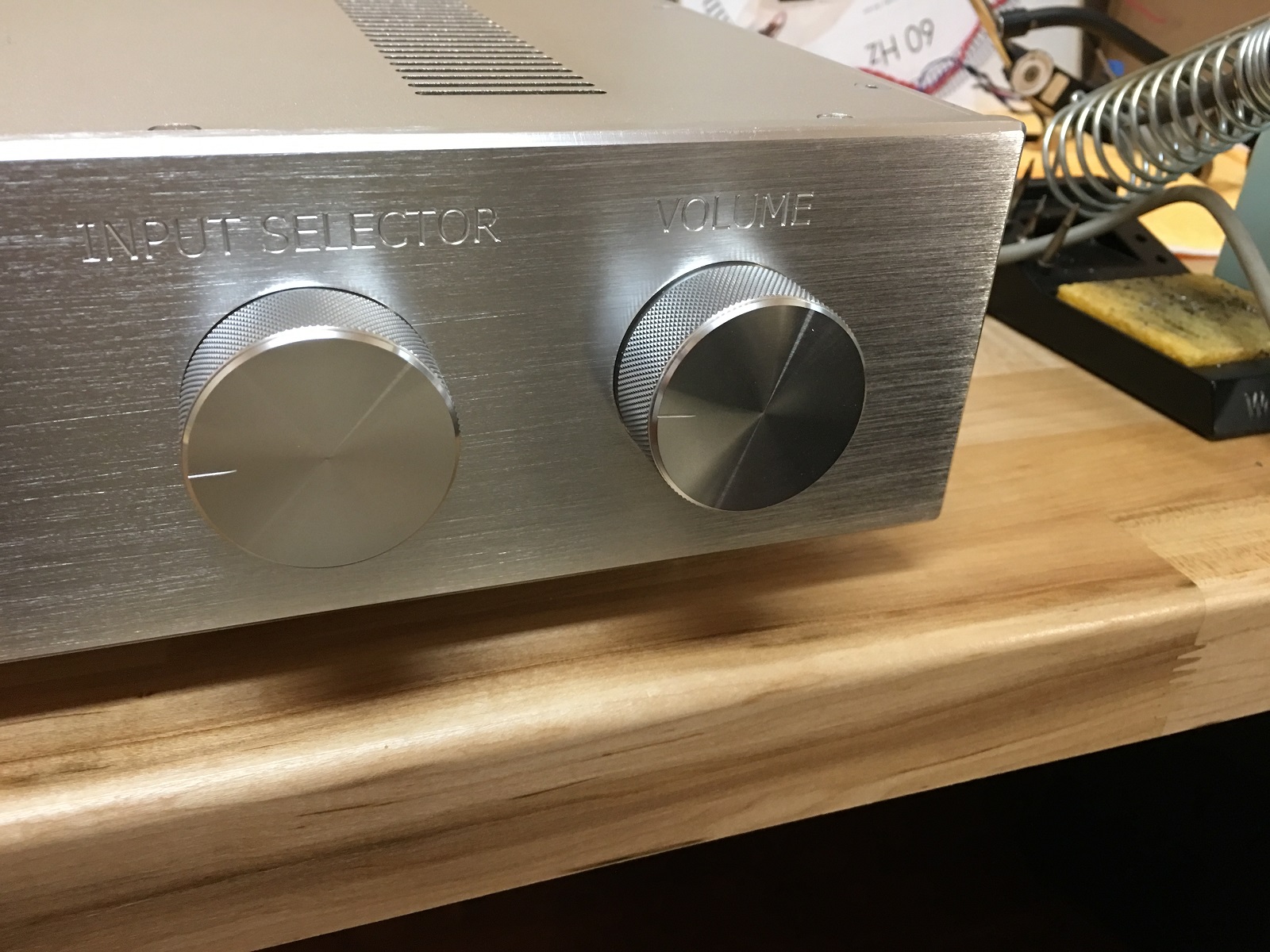

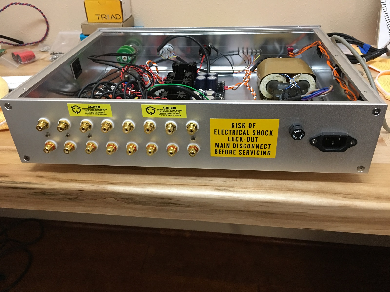

Ah, the detail benefits of a custom CNC chassis. Very good. I am also a lab now I see 🙂
The cabling could have been a little shorter even. Mogami? Did you listen to the pre for more hours since first tests?
I was sure that you must have a LAB in my house now! 🙂
Yes, I use Mogami 2330 and to be honest I thought I'll go for cupping links at the beginning. Unfortunately, never implemented that since I newer used that method in my past. So,skipped it that time too. I might go to short these coaxes by half soon, but I would like to test the whole thing for more time now. Will run it for 40 hours or close to see how it's behave after initial burn in.
Soldering the wires is better, more robust and reliable, no need for periodic inspection to tighten connectors screws etc. But its also true its a small pain to rework soldered wires in a finished build. Pin terminated ends undo themselves more difficultly than finger twisted non tinned ends. Many of yours have pins and are only soldered to the jacks and pot so its easier to desolder and shorten from those ends than to cut from the other ends and terminate with pins again. Since you made a spacious and sturdy CNC box that everything is securely mounted inside, any rework can be done handily if ever. The 2330 is 35pF/Ft so its not a very big deal being somewhat longer than needed when there is no obvious issue to address, but less is more in general 🙂

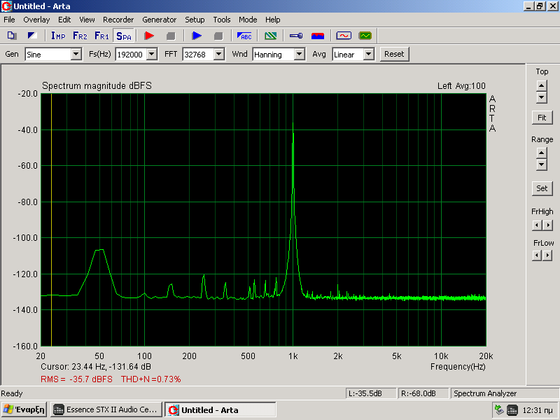

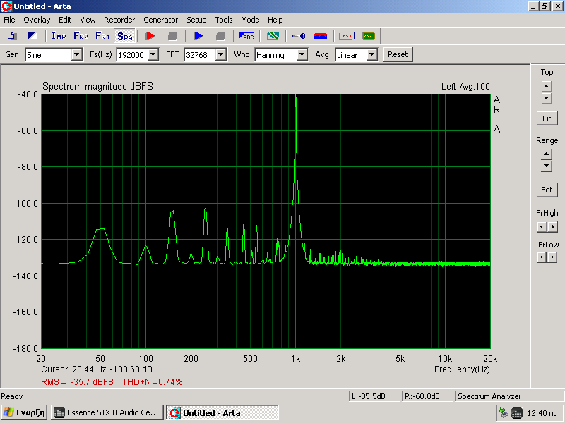

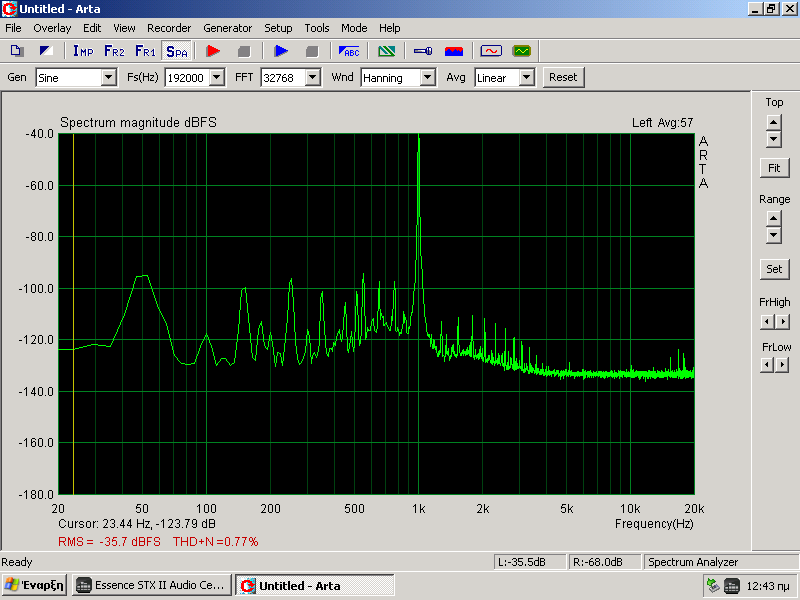

My "measurement set up" basicaly is my audio PC. Output signal is estimated at some 15mV pp. It has a PCI sound card that has been modified with output in mind. Now I'm doing some work on the input also. First pic is a ground loop and second EMI induced by transformers installed inside the PC. I gradualy address these issues. For DCG3 I've used shielded toroidals. The problem is that indeed I measure it in SE mode at the moment. I'm thinking to build P. Millett's or J. Didden's interface. Ground isolation and some gain.We'll see.Good to know. RFI or a measurement artefact it should have been. If you will select 48kHz 131072 24bit in ARTA and push its signal gen several dB up it will show you even better results. You could try push the 50Hz and its harmonics a bit lower in the build if its because of mains wiring inside or outside crossing with signal cables. Could be due to a trafo's field of course. From nearby equipment even. Or a measurement loop issue if its done SE while your preamp is doubled up balanced. That would not be the case when connected to the balanced hi-fi system. Some external cards have ground lift DIP switch even.
Set 48k Sampling (Fs) and highest FFT rate in ARTA. Also go to its audio device menu and select 24 bit wave. Make sure that the windows audio device driver is in sync set at 48K too. Run it again.
Look again into audio device and calibration menus in ARTA. Go to its generator's menu and up its output. Its impossible that a sound card can't give hundreds of mV at least. Usually much more.
With all that noise in your PC you can't see anything cleanly isolated for a DUT but try with the above settings to make it run at its best. Loop the card from in to out with only a cable without a DUT first so to know its base best. So to can roughly mentally exclude its de facto harmonic noises and learn its own contribution in distortion spikes at several levels.
I set ARTA according your recomendations. The difference is that peaks are now sharper. I'll leave it like this for reference.
Unfortunately - or not 🙂 - the particular sound card cannot give high output. In fact it seems completely unsuitable for performing measurements. The real reason I'm trying all this is because I want to run speakers measurements through my audio system chain. I'll know if it is possible when I remove those noisy trafos.
