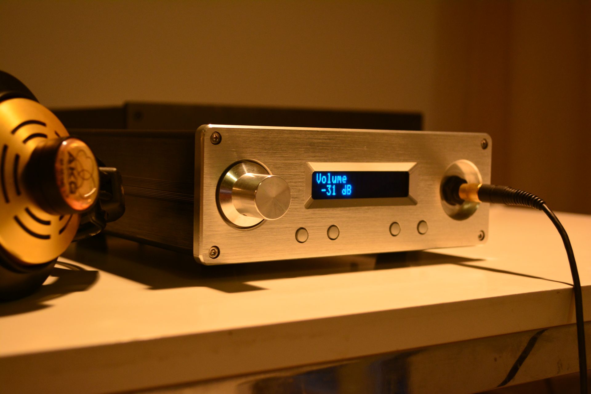

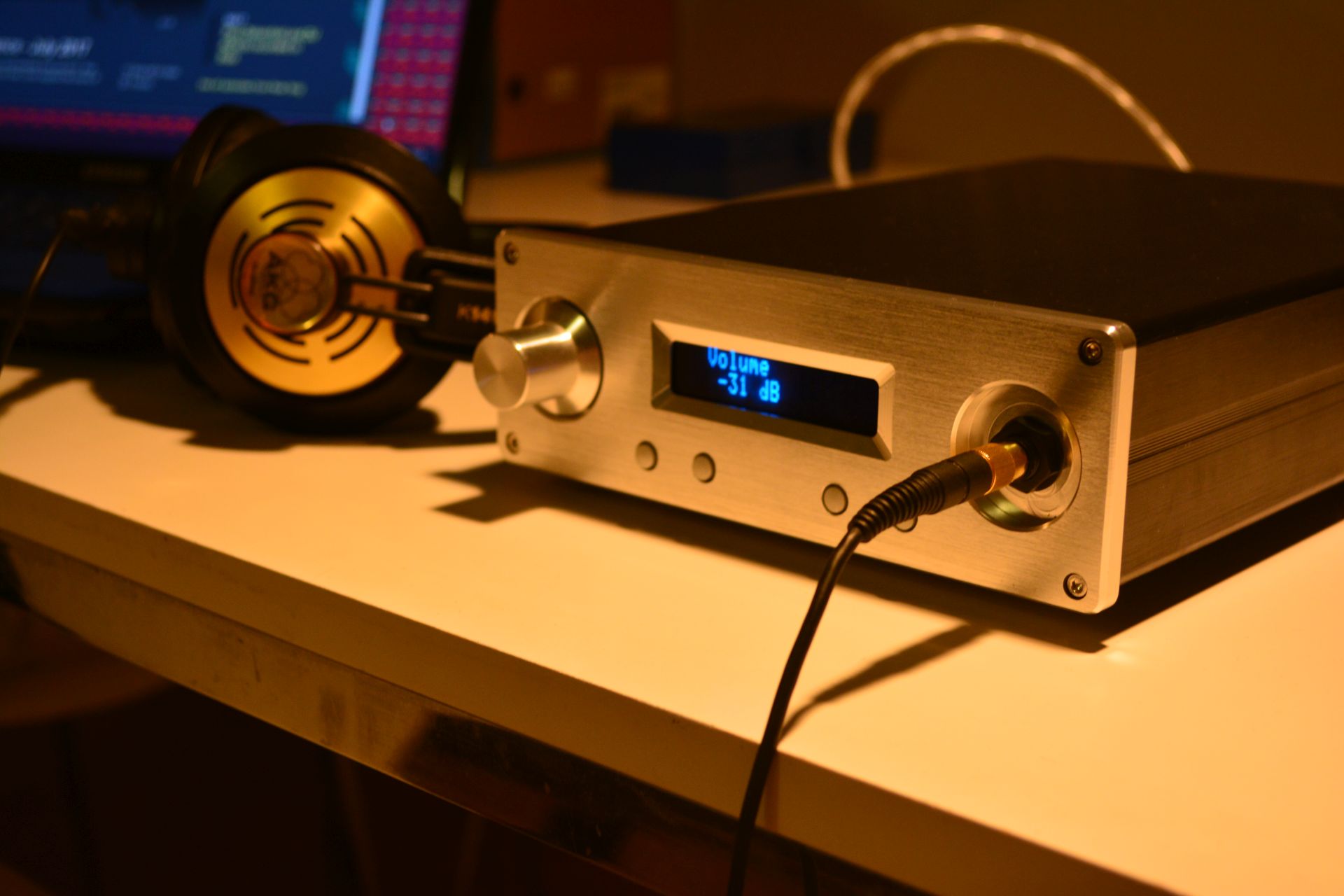

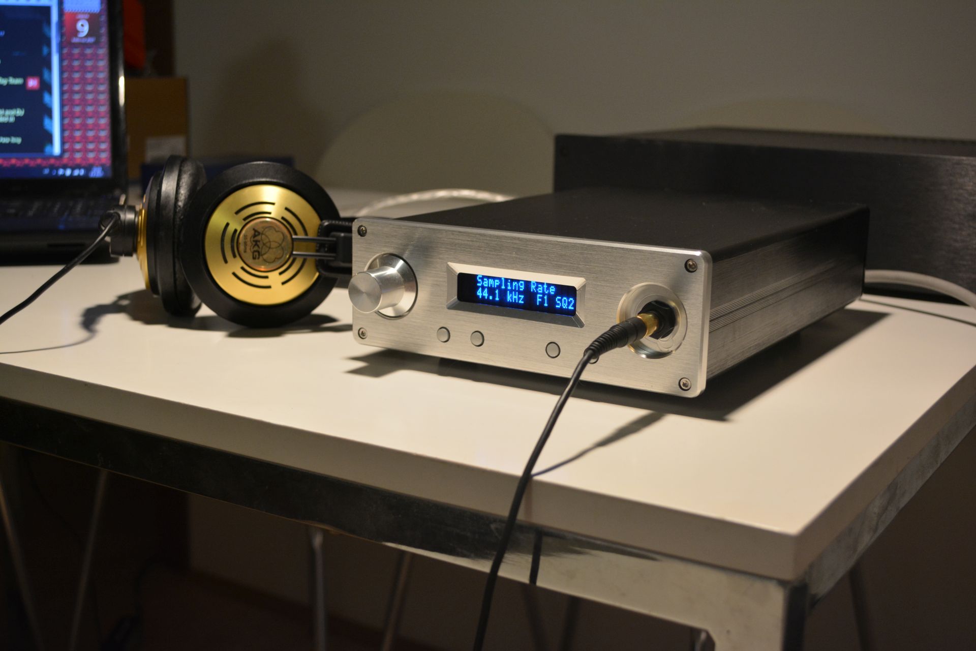

and final pictures
have installed buttons for volume and menu controls of DAC (I'm using internal volume control of AK4490)
It looks like I have some ''smudge'' on the glass in front of new installed VFD display...but who cares 😀
I think that's it...no more taking it apart 😀

Stunning!!!

Excellent DAC/AMP aesthetic result. Are you happy with the tonal synergy of those two?
