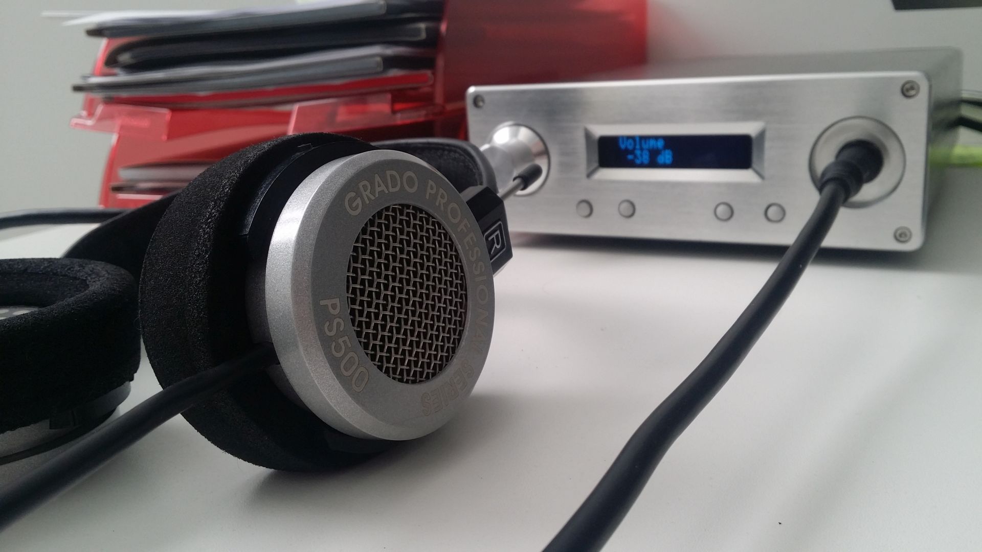

This combo was with GRADO PS500 in mind, which I use on work 😀
The sound I describe was with Grado
but as I mention it's nothing to warry about...maybe I just get used to buummy sound of PC soundcards
AKG was only for home tasting (I bearly use them, much more like the sound of grado over them (even SR60) 😀
For heat...will give it a thought...but I'm happy for now

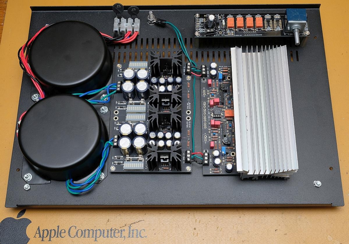

Those are Antek AS-0518 toroids with some cans I found on ebay. Like these 1PC 105*45mm Metal Shield Plate Black Toroid Transformer Cover Chassis | eBay
Antek doesn't offer one for their 50va toroids.

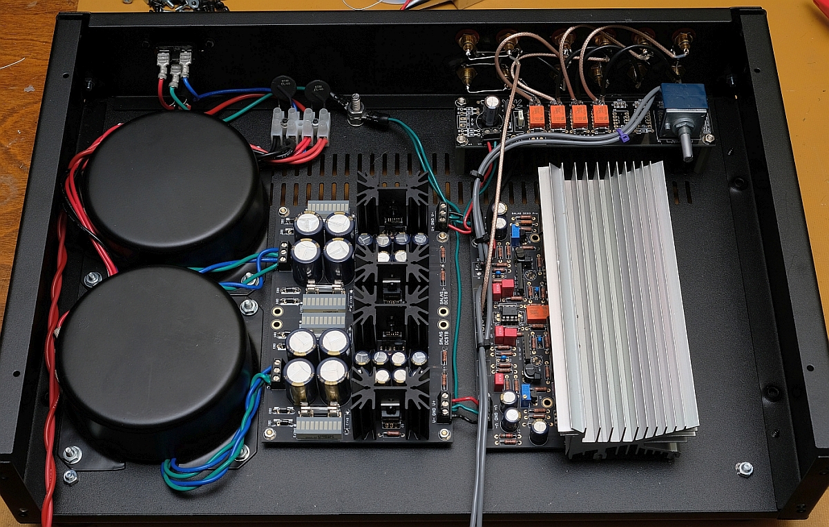

Well drats. Drilling the holes for pot, switch, selector and headphone jack and botched a couple of holes and broke a bit in one of the small ones needed for securing the Neutrik headphone jack. This is the 10mm front on the Pesante case. Not able to drill through the hardened steel of the bit. To further add to my suffering the Modushop factory is closed for holiday this month. Oh well, next month for completion.
I have it working without the front playing through two Pass F4 amps in mono-balanced mode. Very nice. I need to listen a lot more. I also have the Pass BA3 pre, Bruno Putzey pre and Doug Self pre and will want to compare them.
All in all, very nice. Thank you Salas for bringing forth this design to the world and Mike for spending I don't know how many hours putting the boards and parts together for sale.
Acrylic or similar plastic makes a great temporary front panel, and a bit easier to drill. Most any hardware store will have sheets of it and can usually cut to size at least approximately. If you have a router you can flush trim with the botched 10mm piece as template for smooth/clear edges. If you go the plastic route careful drilling near the edges or it'll chip out.
BK
BK
You are welcome. When it already works steadily without hum and buzz and sounds clear its the one major building step well done. Congrats for that. For mechanically finishing it, there's nothing more you can do than wait for a new front panel or go acrylic as BK said. Bad luck for now. Do your listening sessions to run it in and roll to best op-amp for your system or de-ring the trafos with Quasimodo, or change bias to higher and listen to it if you use the lower bias, doing useful small tunings that will keep you interested while waiting to box it up properly in other words.

The big heat sink drpro's using made me wonder whether I need to use one or can get away mounting directly to the side of the chassis - it's a HiFi2000 Galaxy (not the Dissipante) which has some heatsinking:
Galaxy Maggiorato
Any thoughts on suitability? I like the idea of the heatsink being the side of the chassis for maximum ambient benefit, or should I find a heatsink to fit internally to be sure?

Thanks BK and Salas for the kind words. From watching other builds I think you could go either way Simon. I found a pair of these sinks online that included suitable clips meaning no drilling/tapping of holes. I'll make a photo later today.
With an aluminum bar interface between the Mosfets and this ribbed side panel/sink it will do well for 100mA bias level at least. The bar will add mass and contact area. The side panel is then in direct contact with the room air and that helps. Use thermal paste between bar and panel.
