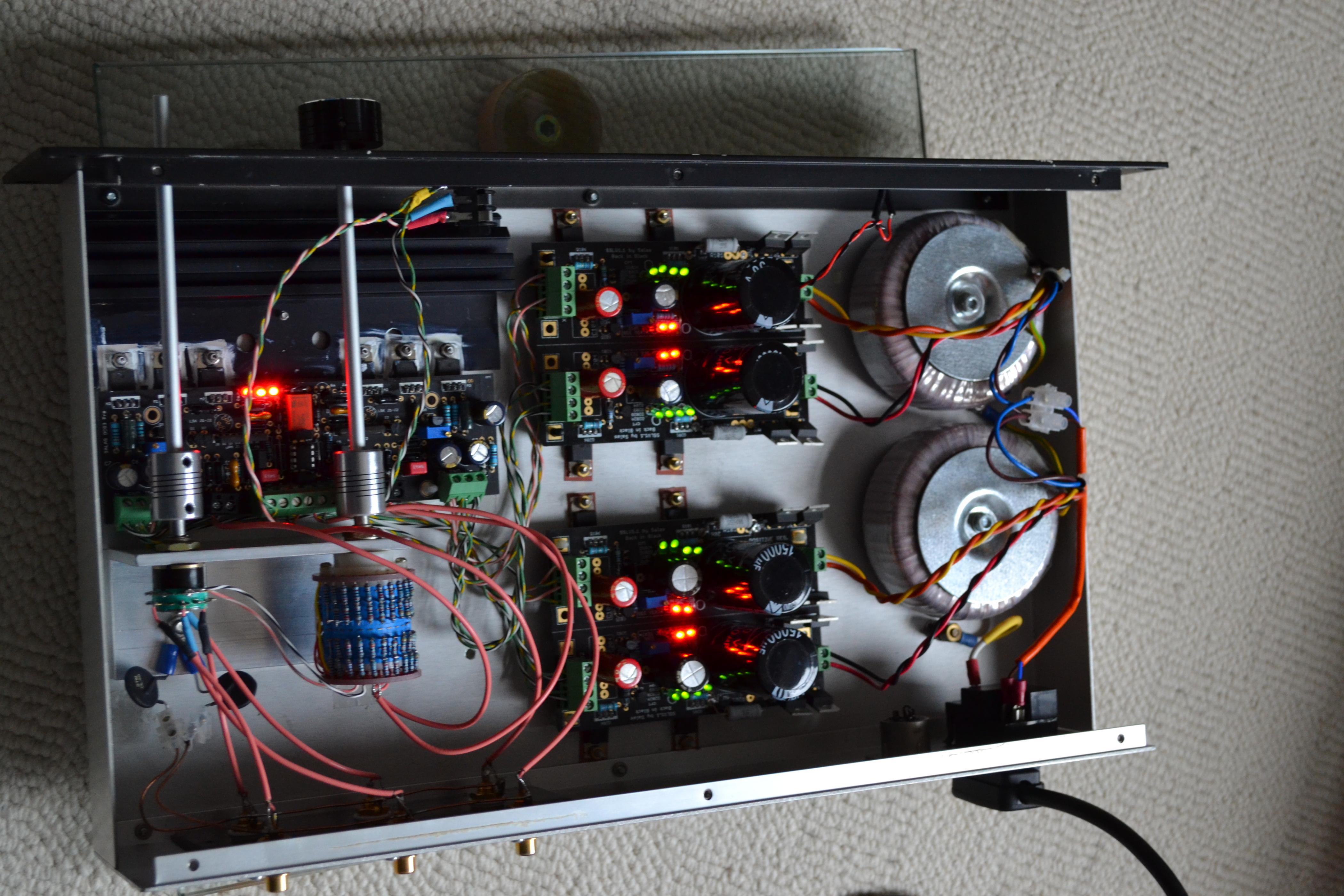

I am currently going through a pair of Jensen transformers to achieve balance out from the DCG3 to drive a pair of F4 amps. I also have built a Pass BA3 preamp which has a bit more voltage swing than the DCG3. I would say you would be quite happy with the DCG3 driving your F4. I also have a Pass F6 that I want to use with the DCG3.
Had a bit of mechanical problems drilling the front of the case which came from the DIY shop. I have a work around and once that is done then I will move the DCG3 to the room with the F6.
I had my wife take a listen as her hearing is much better than mine. I have been doing a swap out with the AD823 opamp and a Sparkolabs SS3602 discrete amp. Her preference is the AD823, though I am partial to the SS3602. Both devices sound awesome in the DCG3. Just my take.
David
Did you also up the DCG3 gain to 5X (2K R6) or the particular SE to BAL transformers already add some extra gain? Because F4 is a buffer amp with no gain and it could use 14dB (5X) of line gain with sensitive speakers as Mr. Pass mentions in its manual. Unless you destine it only for use with the F6 which has 5X gain on its own of course.
Maybe the wife has a point in her preference after all because the Sparko is all bipolar while the AD is JFET input and it could be not strictly better than the sophisticated discrete Sparko in general but merely more adequate in this specific place.
Salas I am running 5x gain because of the F4s. Speakers are 90db. I don't think the Jensen's have any gain. I am at work so it will be later before I can check.
Overall everybody has a different response to sound. I respect my wife's ears. Sometimes I want something to sound better or different.
5X active gain is almost all you can squeeze out of a standard rails DCG3 and a 2VRMS source assuming 0dBFS recorded peaks. Since recordings avoid hitting the hard digital roof there is also 6 to 10dB headroom in the good loud enough ones. But if with F6 you will feel there is too much gain on the dial return to 3X.
Have you thought of pinnocchio's suggestion to check the JFET input OPA1642 too? If by any chance it will be to your preference you could save the expensive discrete Sparkos for signal path use in other projects than serving the less influential DC servo job here.

Thank you for your insights. The Sparko was a on the moment purchase. The owner gave a small discount for my purchase. I will add the OPA1642 to my next Mouser or Digikey order. I am still learning!! I have built one of the Pass inspired DIY headphone amps that is running the AD823, so I will give the Sparko an audition in that amp.
David
David
Did you also check if the rails are tame on the scope when using the BIB shunts in full Kelvin with the DCG3?
No as I do not posses a scope. Would I be better off using them without the sense connected?
Normally no. Because longer sense runs being exposed to more "outside world interference" have more chances in picking stuff we always check when we have a scope. When we don't and there is oscillation or noise in various intensities we normally can understand them by strange behavior like voltage instability, weird noises, or the sound has gone noticeably south. Another thing is we just subjectively compare Kelvin mode vs two wire mode and if the former wins all is well. If the latter wins means there could be some more RF or small anomaly with the other mode and we keep the two wire one since there is no scope to see what was it or how to change it.
