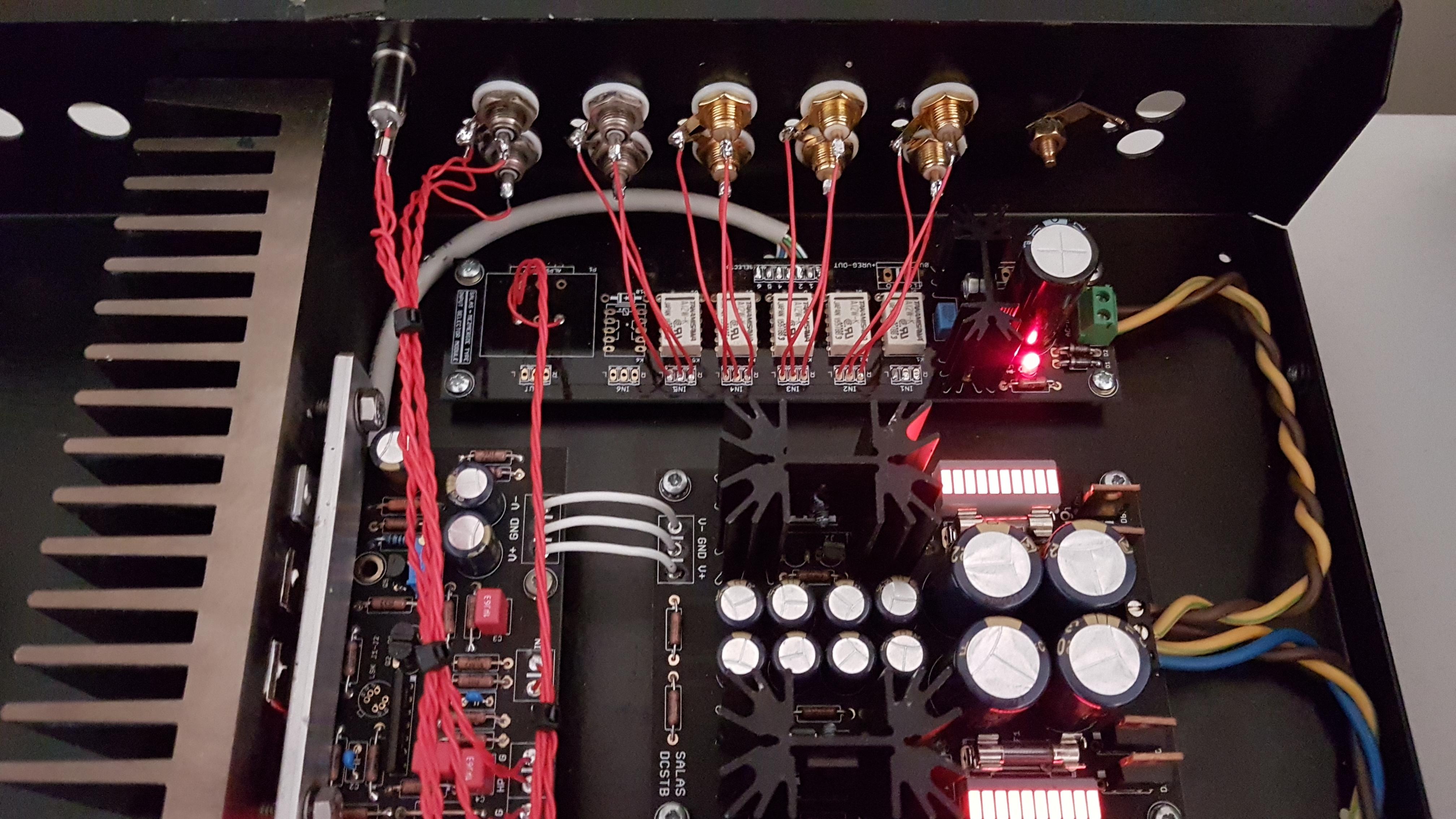

I've read the whole 212 pages of the thread and I don't seem to find again the info regarding the DC input for the I-Select board. Not sure if it was here or in another thread...
What can be removed from the I-select board if a DC is already available? Just the diodes?
+/- 17-18V should be available from the preamp power supply. But, in case, what could be the minimum input DC?
Thanks again!
I have done it like this. Works like a charm

Hello, you are welcome.
Its an input select accessory for any preamp, has a short thread in the GB section with a pdf guide and few clarification answers also. It was introduced separately and wasn't further analyzed here while not being a dedicated part of this preamp.
Some fully populate it for its own PSU and tap from one AC secondary at the DCSTB transformer input connector to power it via its AC input connector. Few even give it a small trafo of its own. Others skip its bridge diodes and populate the rest but with a smaller filter cap like 100uF for local DC bypass and tap raw DC or regulated output DC from DCSTB to power it via its DC input connector.
Read the guide and post #31 in its thread there: GB For Salas I-Select Mesmerize Type input selector and volume control
bambadoo,
Thanks. Yes, AC to AC ;) Will save the pic anyway in case.
But still wondering about the DC bypass :eek:
By the way, why did you skip the 1st relay for the input (right hand side)?
Because of fitment, symmetri and all that :) And needed only 4 inputs. (well in practice only 1 input) Still I have the option for one more input. Drilled holes in the case.
Also I bought 2 i-select boards and only have 10 relays at hand so I thought total 5 relays each board.
Was also thinking av DC input but could not make it "fit" as good as this way.

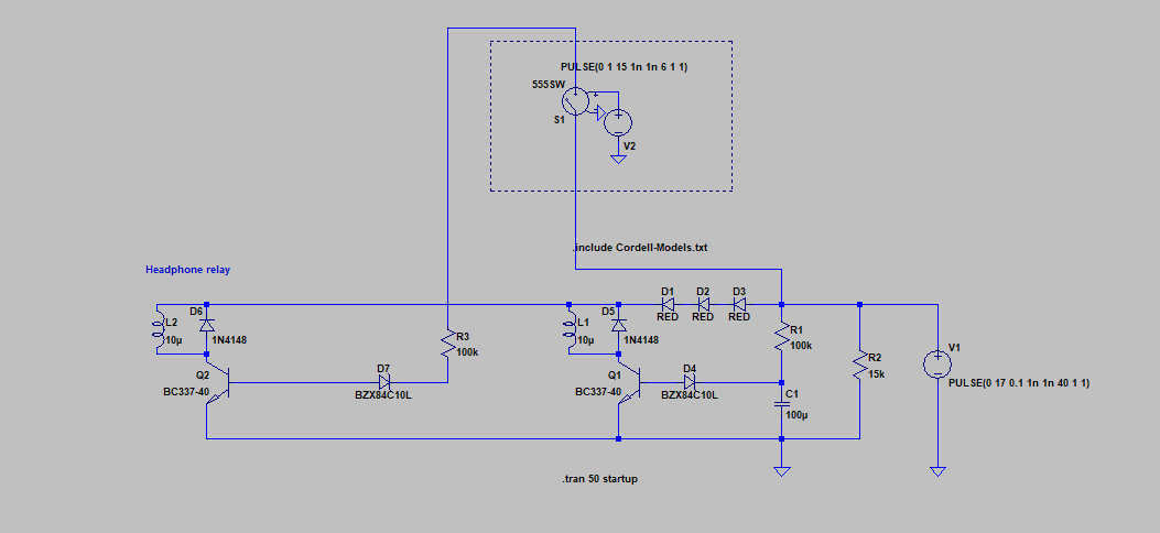

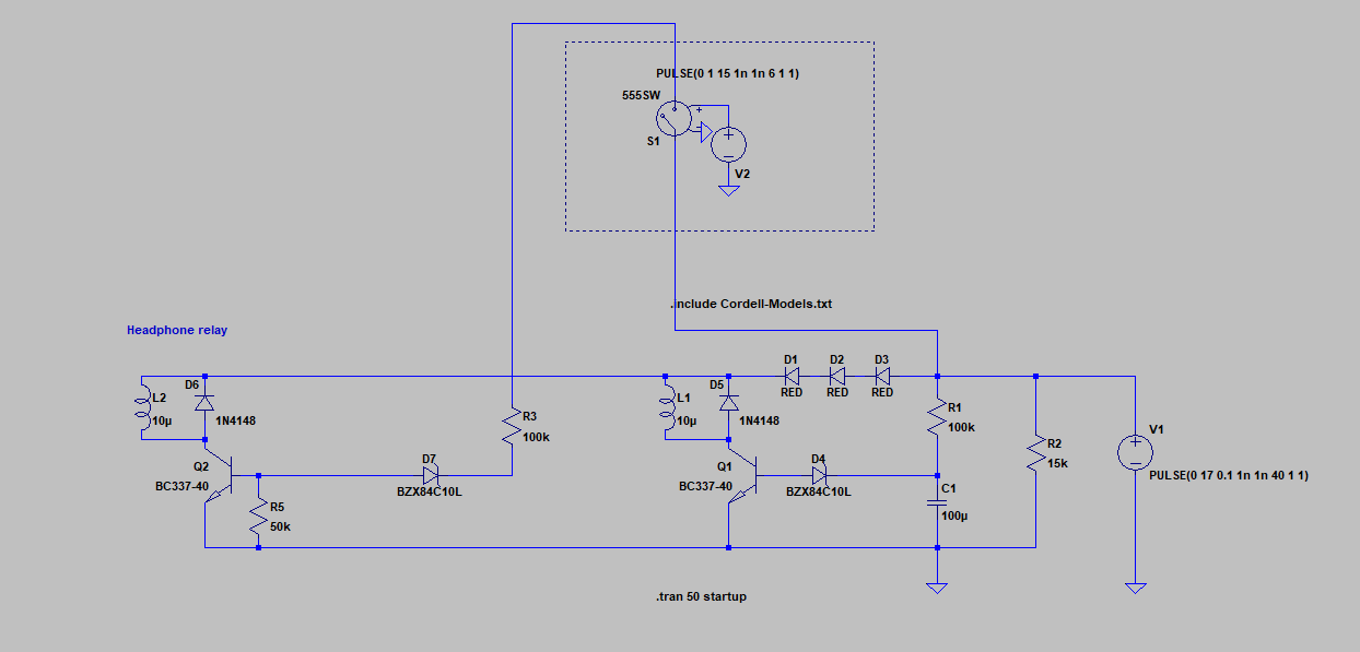

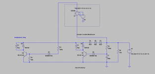

Hi Salas
I would like to use a second relay to switch between outputs (Line / Headphones)
As to not complicate matters I would like to use the existing circuit that powers the delay relay and use a switch to activate a second relay.
I am not sure if the current draw from both relays can be supported by the leds.
I am also not sure if the circuit I am planning to use should work... please advise.

If also you need to have both relays engaged the Leds can reliably support up to their own nominal current (check the spec sheet of the ones you got vs your two relays needs). But usually its one or the other, not line output to amp and speakers playing while listening to headphones.
You don't need to double up on drive circuits. R1 C1 could be common timing delay and you could pull the relays through Q1 using a switch for which one's coil you prefer to engage. A two way for phones/speakers or a three way switch for phones/speakers/both if you must.
The Zener is to create a threshold voltage for Q1's base to open at as the RC is reaching it charging up.
Thank you Salas, I am redrawing the circuit and placing the switch just between the leds and the two coils driven by the same BC. Perfect
so the zener speeds up turn on right ?

The Zener fixes a level that the RC has to reach but that also stands comfortably lower than the remaining B+ after the coil's drop to contain enough voltage space for the transistor to operate. I don't have a sim to post you voltages on nodes because I just put it together on the breadboard back then, made it work, then complemented it to the main circuit.
