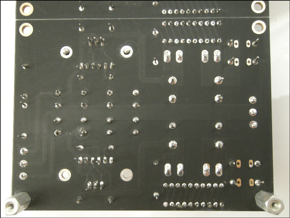

Looking for a little insight, When i connect my DCG3 preamp build directly without a pot, I loose a lot of volume /gain. I am currently using a 15v ac x 2, until the Antek become available. The highs also seem muted when compared to when i connect the source directly to the amp. Has any one else had this experience?
Maybe you experience oscillation when without a pot. Assuming everything else is correct. You shouldn't but its too complex to say offhand for some experimental setup. Try 4.7K series resistors on your DCG3 input connectors for now to buffer the whole input wiring better. Your now trafo is border spec for the DCSTB also. Measure its rails DC when loaded by the DCG3.

Still do try those 4.7k directly on the PCB line in connectors just in case. Some other problem must be at play if no change then. Build level problem. Maybe you misplaced R6 for R7? The rail voltages are sufficient. With more Vin-Vout from 18 VAC trafos there is better performance but your rails are still around 17VDC for a basically correct test. The DCSTB LED packs look bright enough, right?
*Don't place the audio system in danger. Even if not having gen & scope use 300HZ sinewave test signal from some digital device and a DMM in ACV mode to measure in vs out while debugging.

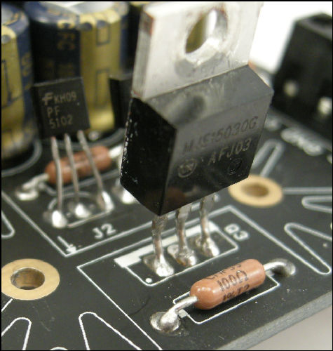

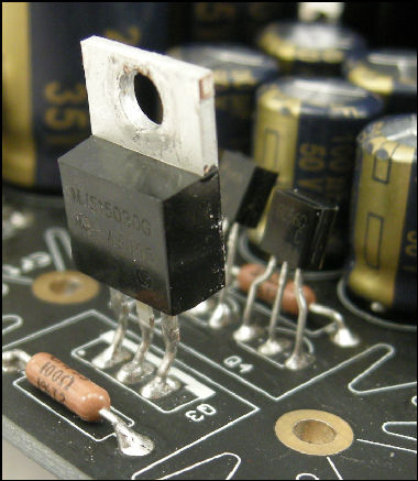

Having a problem with the negative side of my DCSTB power supply. Both the positive and the negative voltage match when I use a Variac up to 15.25 volts PS output voltage – measured across a 150 ohm WW resistor load. The positive side levels off at 17.1 at full wall voltage and the negative side start climbing to 29 volts at wall voltage. This symptom happed using the original parts from the kit.
I replaced the original negative power supply FETs, and transistors parts from the kit I purchased with: Digikey parts: MJE15030GOS-ND, BC560CTACT-ND, PF5102-ND, 754-1176-5-ND
I swapped out the original parts with the above parts and nothing changed – still 29 volts at the negative side output. The parts positions are all correct.
I also replaced the LED bar graphs, both positive and negative with 754=1176-5-ND. The positive LED bar graphs light up at full voltage. The negative bar graphs do not light up. I have checked each LED with a 12V battery and can get light at each LED on the negative side.
I purchased a batch of PF5102 and measured them for Id with M3 Semiconductor Analyzer. They all measure between 5.5 & 8.00. I am using a PF5102 that measures close to 8.00 in the negative PS.
I toothbrush scrub the boards down with 99% alcohol.
I wonder if you have a suggestion how I can tame the negative side of this DCSTB.

In normal operation first they must light up, second their operating current must be comparable to those at the positive side. In that case the mV drop across R2 indicates the current that runs through the negative LED bars. R2 is the J2's degeneration resistor and its value can be even changed to manipulate the current for LEDS VF even when not having a matched to J1 IDSS sample for J2. When the negative bars are dark Q4 is probably out so Q3 is uncontrolled and just passes near Vin. Also can happen if RyJ has too high value by mistake or missing.
Just a hint for further problem solving: See post #829
I had mixed up the Q1/Q3 on the other channel and measured too high voltages.
Also such a misplacement can be the answer if its not due to some part is broken. But in this case the photographs show the proper Q3 type.
Another possible assembly error is to have soldered those dark LED bars the wrong way around.
I should mention, I bought the double power supply option. I have one working DCSTB power supply. Parts position was the first thing that came to mind so I have looked at this after taking a step away - a few times. About the Digikey part BC560CTACT-ND Have I made an error in ordering this specific part?
That part has the correct pin order and correct general spec online. Measure its Vbe. Also Measure R2 and RyJ values.
