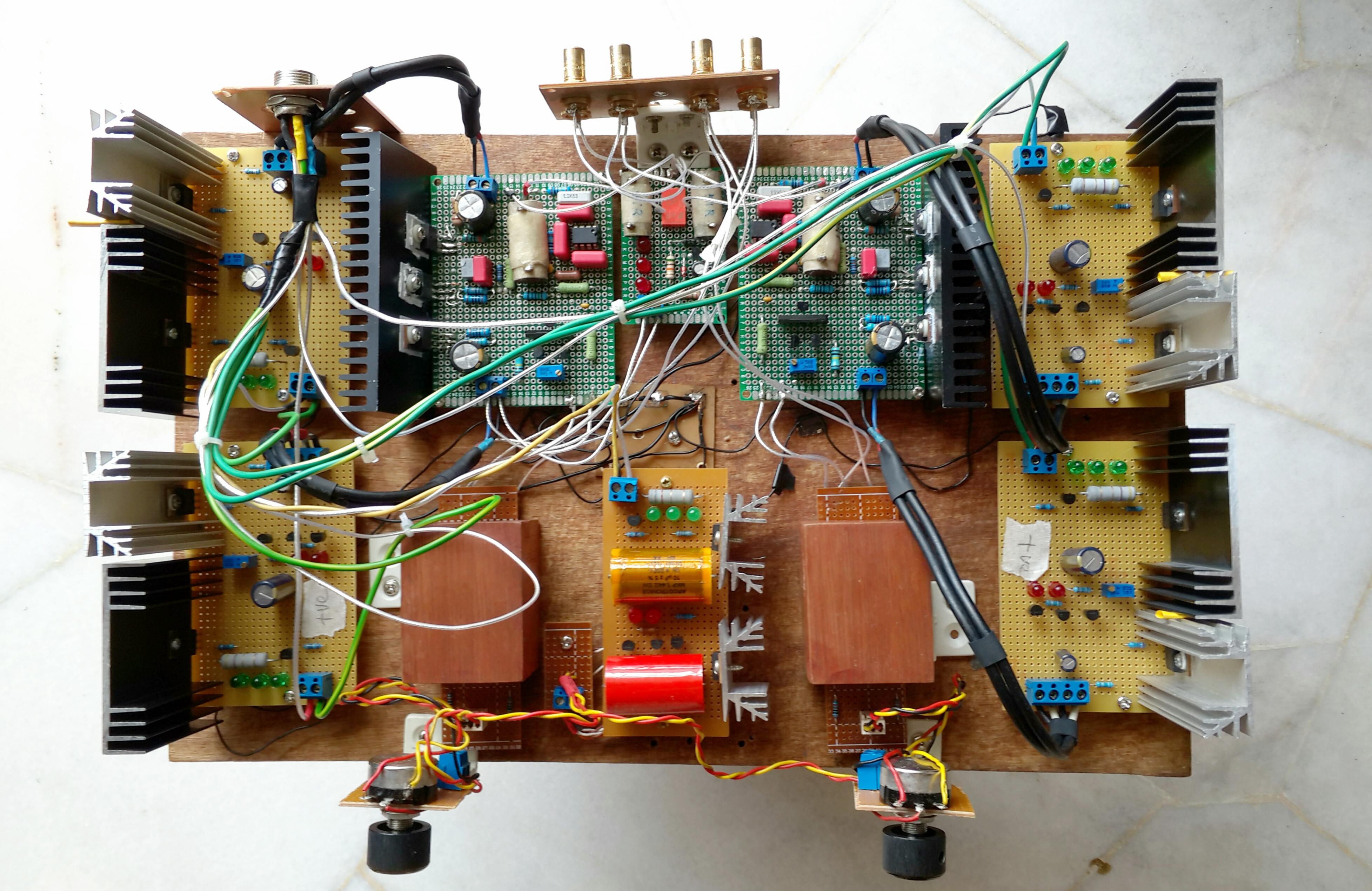

My DCG3 built now with 2 nos +/-17.6V BIBs for true double mono. More refine, smoother, better separation and a wider/deeper soundstage is the initial impression.
That's nice. For double mono PSUs I had only listened with the DCSTB voltage stabilized cap multiplier PSU for size and thermal economy. So including LDR attenuators you have the most intricate DCG3 beta build in DIY town 🙂
It can be done capacitor coupled output too but I don't recommend it. Everything is audible, very simple signal path, very fast circuit. Couplers spoil it.
(build example by V George)

The DCG3 is better without. I put it because I did not had the parts for servo.
