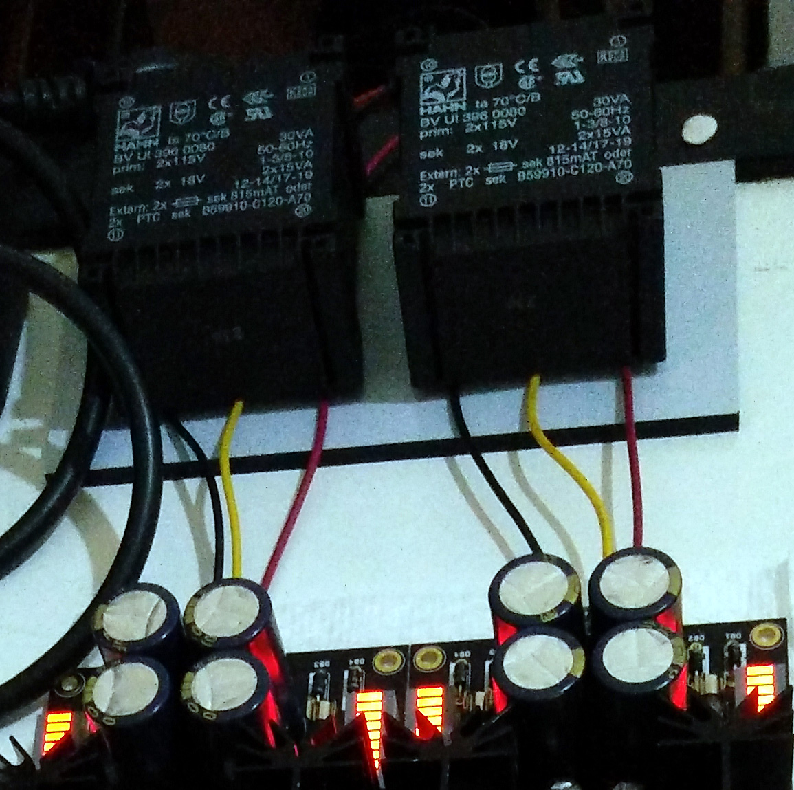

I have used two 30VA 800mA PCB style encapsulated in resin German brand transformers (HAHN) that are split bobbin inside. 800mA makes for 500mA in bridge rectification so its enough in double mono. They save space and don't hum or anything while they are 70C rated but they went 45C and I will specify 50VA in the BOM. The Antek for shielded Toroids and Hammond for frame transformers are very good solutions in the North American market.

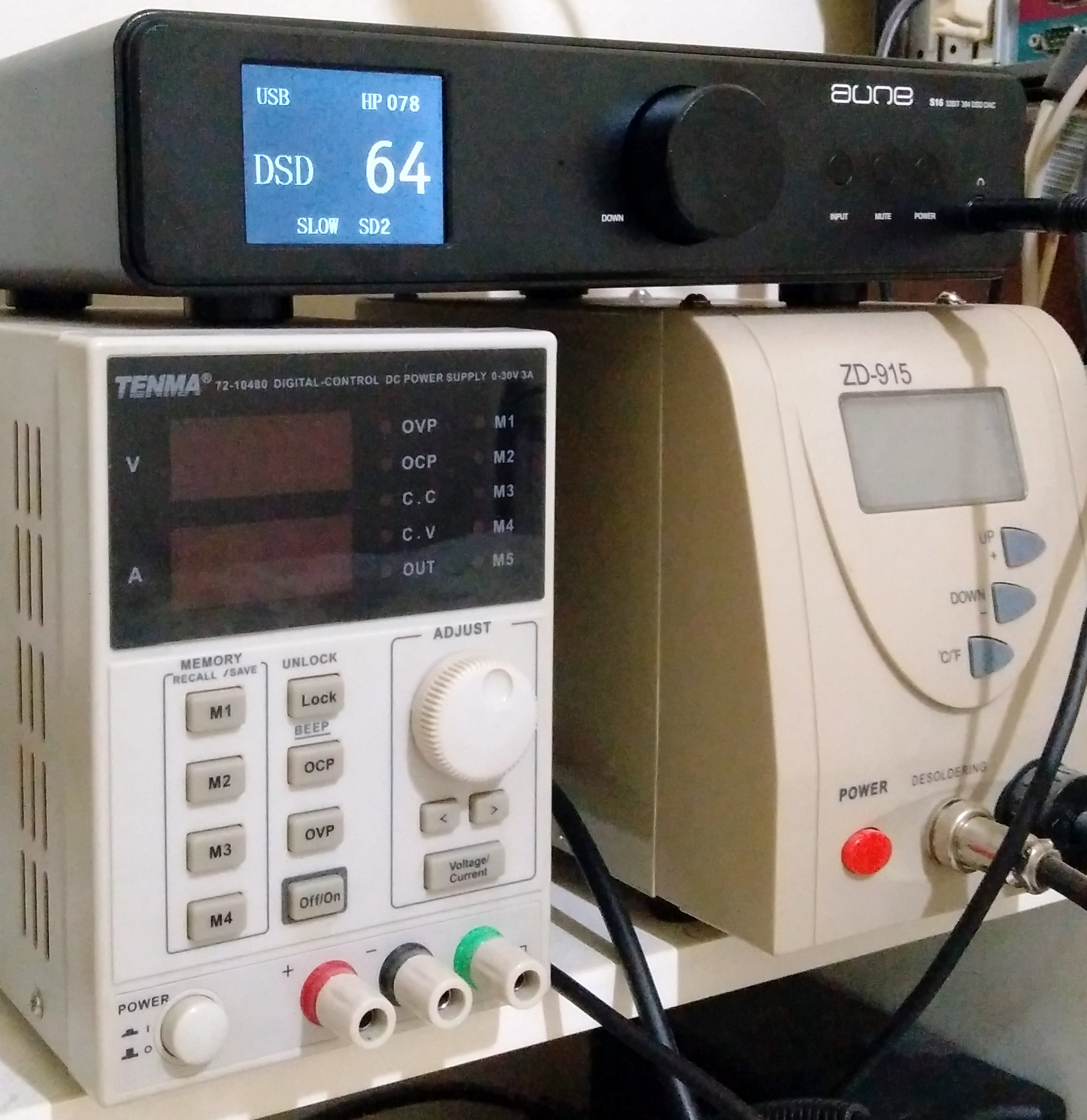

Hello Dim Dim you will soon have the chance to listen in the main system on speakers as well as with your Fostex planar cans again. If you liked it with the lab supply and the sound card I guess you will like it even better with its dedicated psu and the DSD DAC. You may even bring around your Soekris. Its boxed already but not picked up yet. It has a Goldpoint 50K pot for now.

I looked at Tea-Bag's blog about this and noticed in one of the pictures that the transformers look to be the Hammond Split Bobbin 229 type. If this is correct what VA do you recommend.
Jim
Those are the 48VA 34VCT units. They seem overkill in dual mono, but Salas is recommending 50VA, so I would stick with that. I made those boards to fit 24 or 48VA versions of those boards.

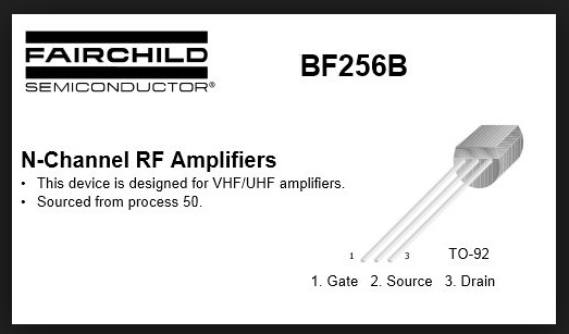

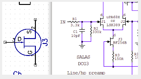

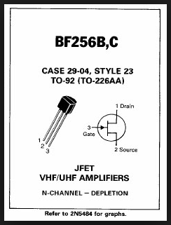

Hi here.
I allway's (or mostly) do my own pcb's... I really like that part of diy Sry. 😛
So in the progress with my pcb program (DipTrace), which i have been using for a lot of years now, i found this diversity of the pinout's of the BF256B.
Can anyone confirm or whatever my findings?
Also it looks like DipTrace are having the pin's wrong (At the gate where the arrow is, the DipTrace say's it the Drain?)
Anyway, there seems to be different pinouts, when reading different datasheet's
Regards; Jesper.
Other guys may run 150mA bias or more so 50VA aren't too exaggerated for cool trafos operation I would think. Can you measure those Hammonds with the Fluke's probe for temperature in your 100mA build some time? They are big and not encapsulated so they must be running at low temperature. Your build maybe draws nearly 20W from the wall right now. Check with a Kill A Watt meter if you got. But don't forget and listen while still plugged on such a meter, its very audibly intruding for some reason. At least those two alike the Kill I used. One I killed measuring a 3kW room heater for long 😀
Both have gate at the end.
Both have source in the middle.
But they are reverse order.
Fair is gsd and the other is dsg
Test your batch to see if you have dsg, or gsd, or some other.
Thanks AndrewT.
I see that now!
But what do you think of the DipTrace having the Drain where the "Gate-arrow" is ??? Funny thing. Am i not right here?
Bit confused i must say 😕
Rgds; Jesper.

Those I got are Fairchild and the Atlas gadget tells me first pin on the left as I face the BF256 is gate
