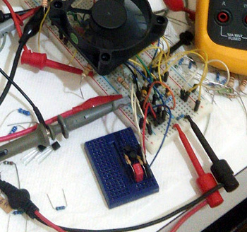

Emitter resistors in the mirror I had tried few values. 10-33-47-68-100R. Leaned to third harmonic and the DC turn on bump jumped high. I did not like it.if you don't approve of source resistors then use emitter resistors in the mirror.
200r on both sides and then a 10r on Q2 side and the 22vr on the Q1 side.
This lets you dial out the offset and lets you see the balance of the LTP.
Big mirror resistors don't harm performance.
* They can be seen on the little blue breadboard in crop detail from the first picture of post#2

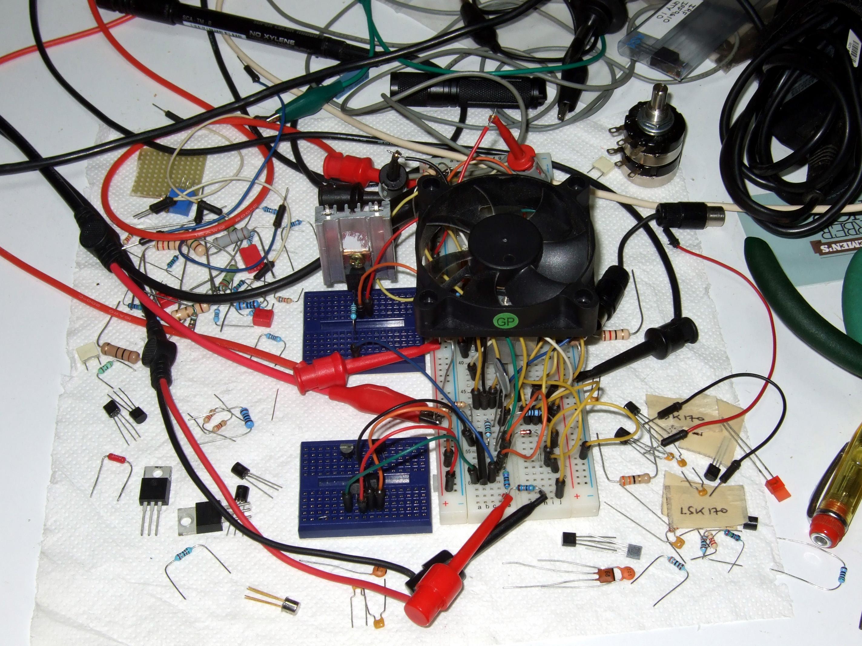

He, I just found a forgotten one in the camera from the development phase. The mirror BJTs and the the second 9610 on daughter boards. There emitter resistors no more. That pic has much stuff. Slim uPA on main board, LSK170s and various Toshibas scattered around, LSK389 TO-71 lying at front left, 1uF C5 rejected at upper left. A Cosmos Tocos test pot at upper right that Tham will like, DN2540s aside left after cascoded and made not much sense, various C1s and C2s from hands on compensation trials, hey even a current regulator diode under the uPA that was evaluated for stability vs the BF looking at us over the "101" ceramic. I mean by blowing on them with the hot air station "scientifically" evaluated.😀

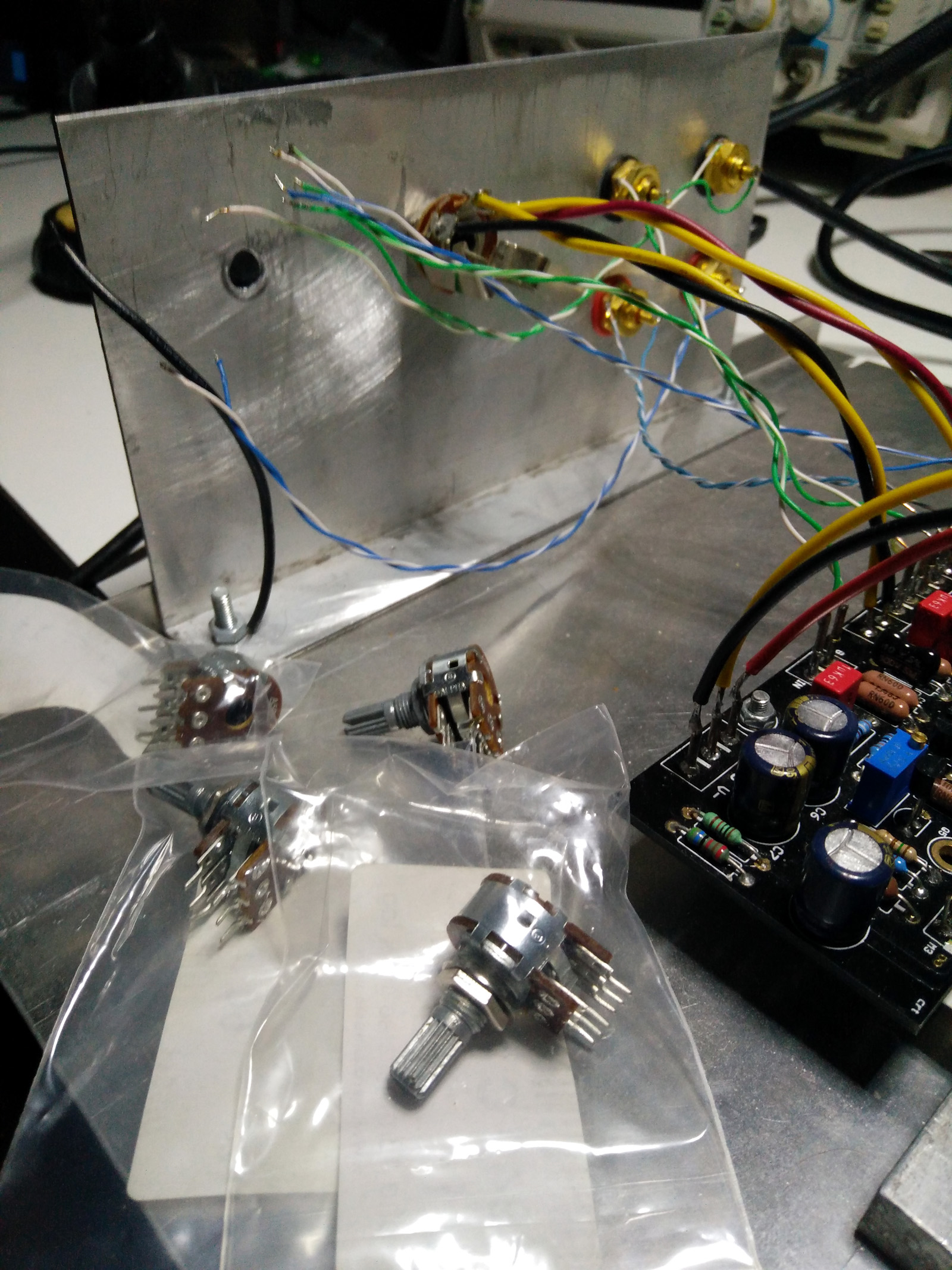

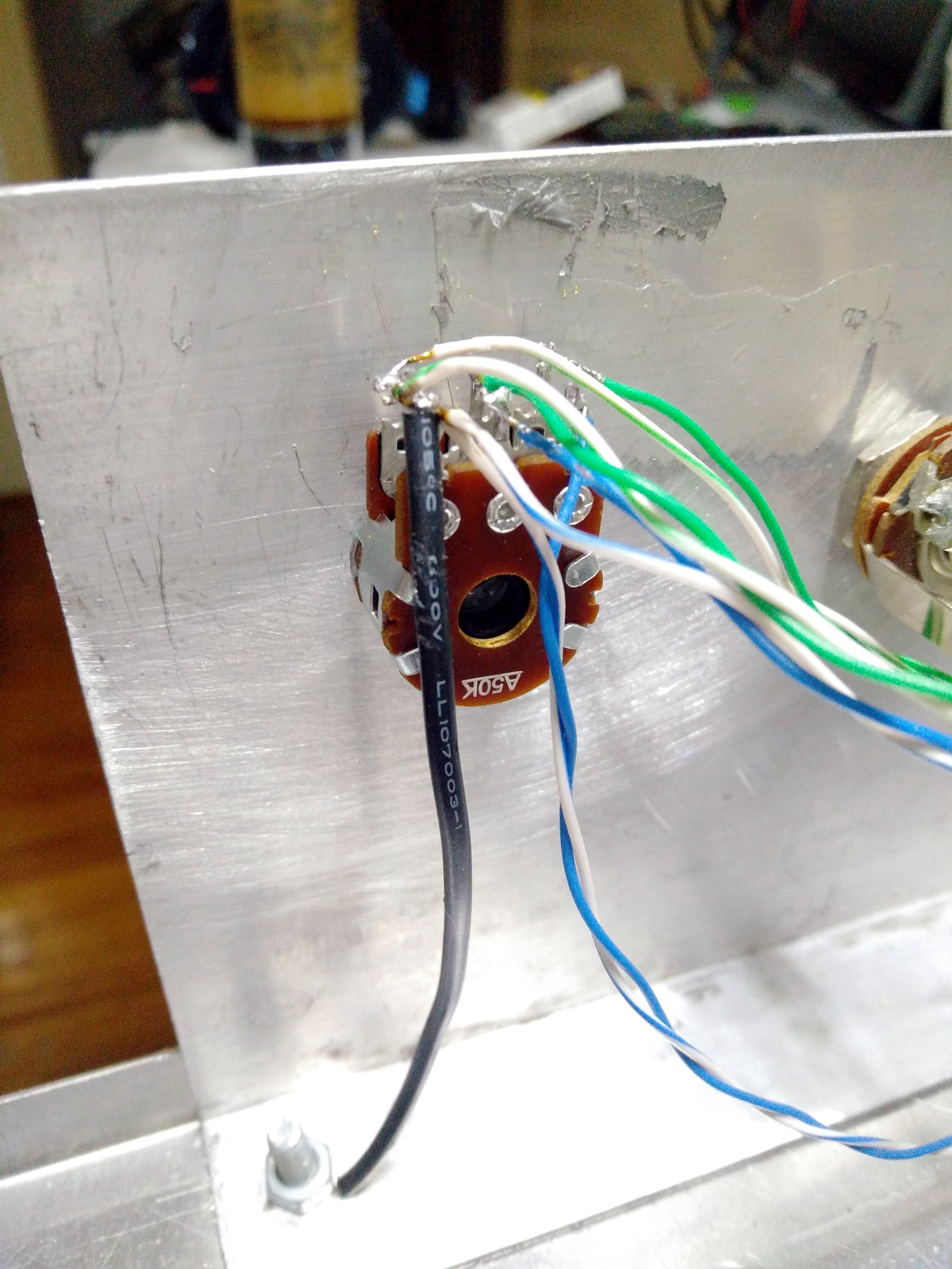

What pot to use? 10K-20K-50K-100K? OK not the extremes. Had it with 20K but how is it with 50K that's smoother for turning up and easier on sources? Well its not bad at all. Nice tone, just a bit rounder. Safer. 🙂
Rounder in tone?
Can you describe that. I have only tried 50K. I am pleased.
Rounder in tone?
Like when I was listening to Carey from Joni Mitchell's Blue in 192K FLAC with the 20K pot it was upfront and pristine but with the 50K one it came across bit less tiresome. A small difference but it could make the song passable without reaching for testing another filter from the DAC's menu. In this video the Appalachian dulcimer is sounding much softer in tone than the one in the record which is much tinnier in comparison. It won't make it soft like that, it will just put it in the recording space hanging a bit better. (https://www.youtube.com/watch?v=A1kcTjtdVE8)
Maybe it has to do with the necessarily narrower resulting bandwidth vs 20K. Then again all 20K or 50K pots won't be the same, but at least I had same cheap ones of various values. Its more of a system matching choice thing each builder has to do for himself.

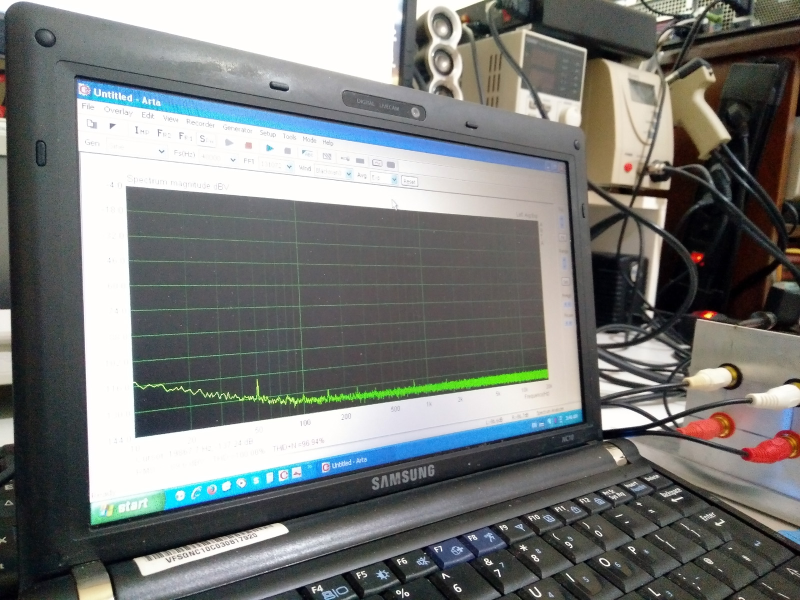

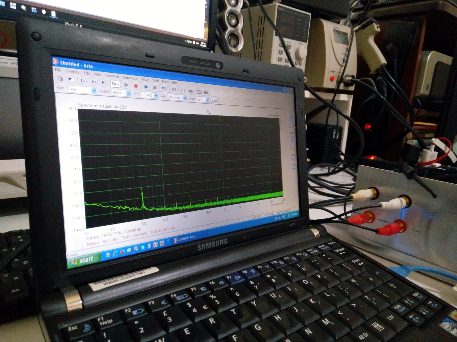

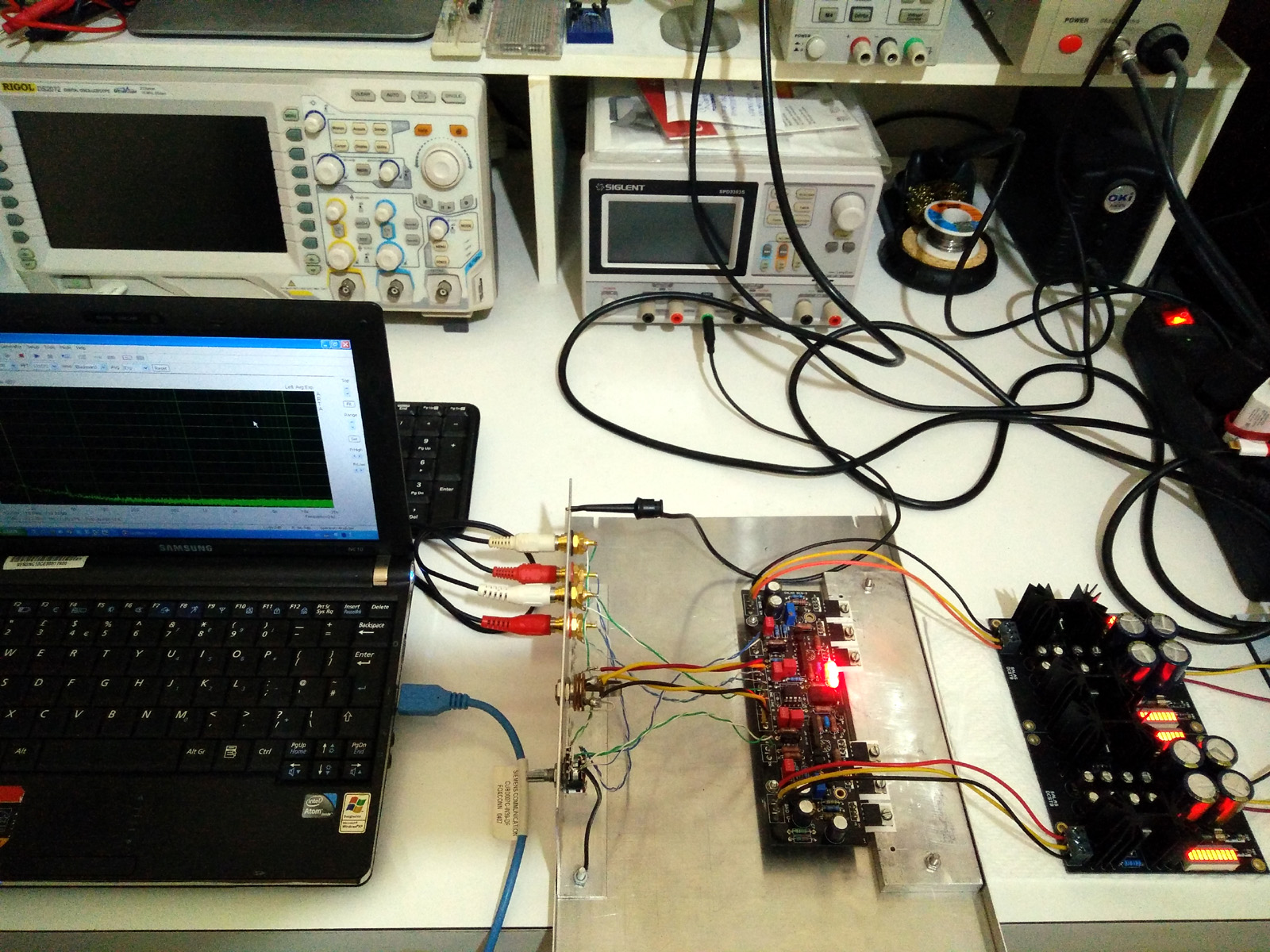

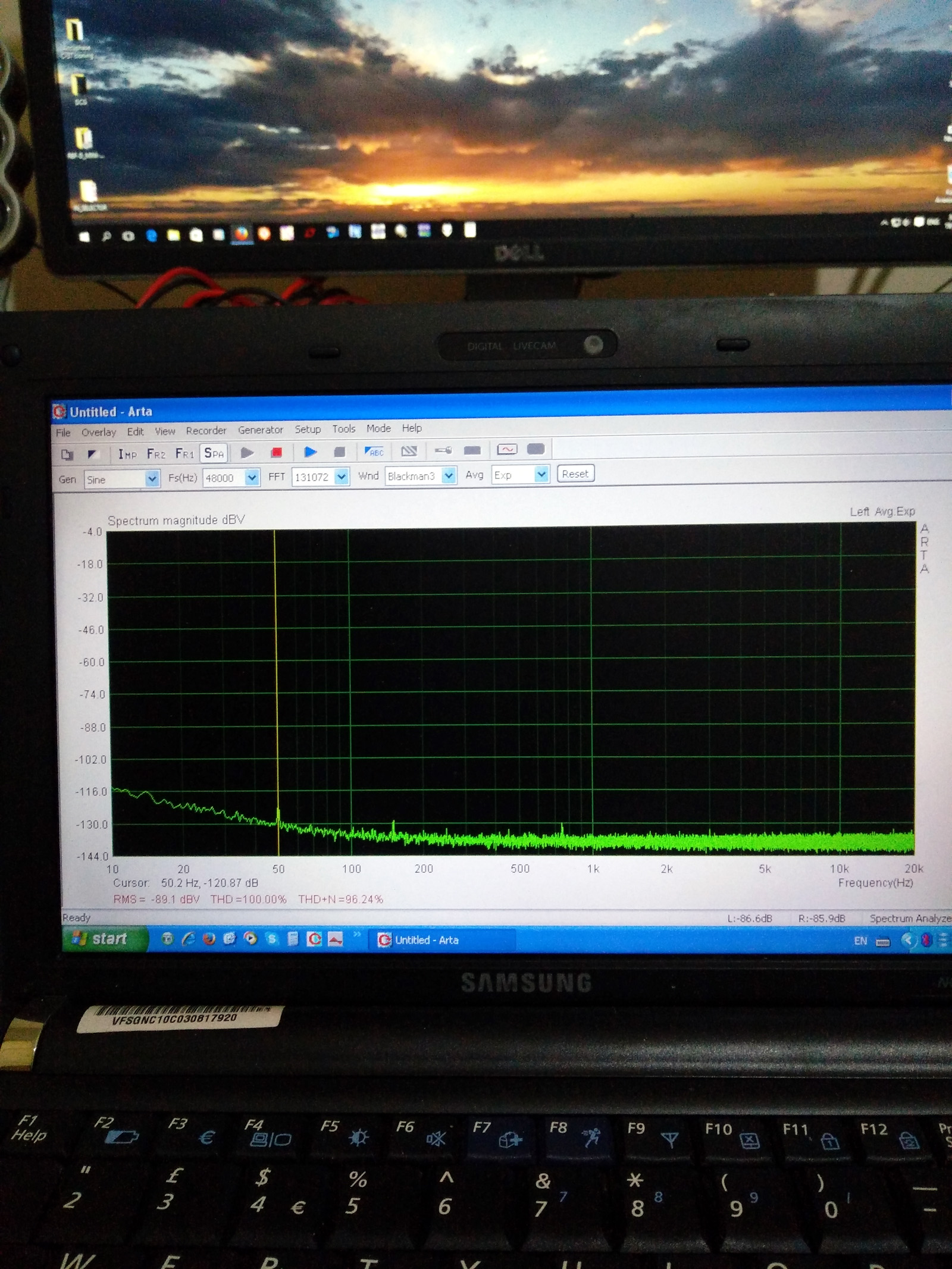

Noise floor pics with the volume pot at max. Even with power cords surrounding, a mains earthing lead to the preamp's chassis can do a decent job of chasing some hum field gremlins though. Long lead and going around through the bench PSU's route to mains is poor practice nonetheless. But at -121dB 50 HZ hum and -132dB 100HZ buzz maybe just passable for an open test build on a bench using no shielded coax signal wiring and a silly simple non battery PSU 😀

EMU Tracker Pre (its a compact variation of the 0404 in essence). It never had proper drivers beyond WIN XP though. Hence I use it only with a second hand notebook on XP.

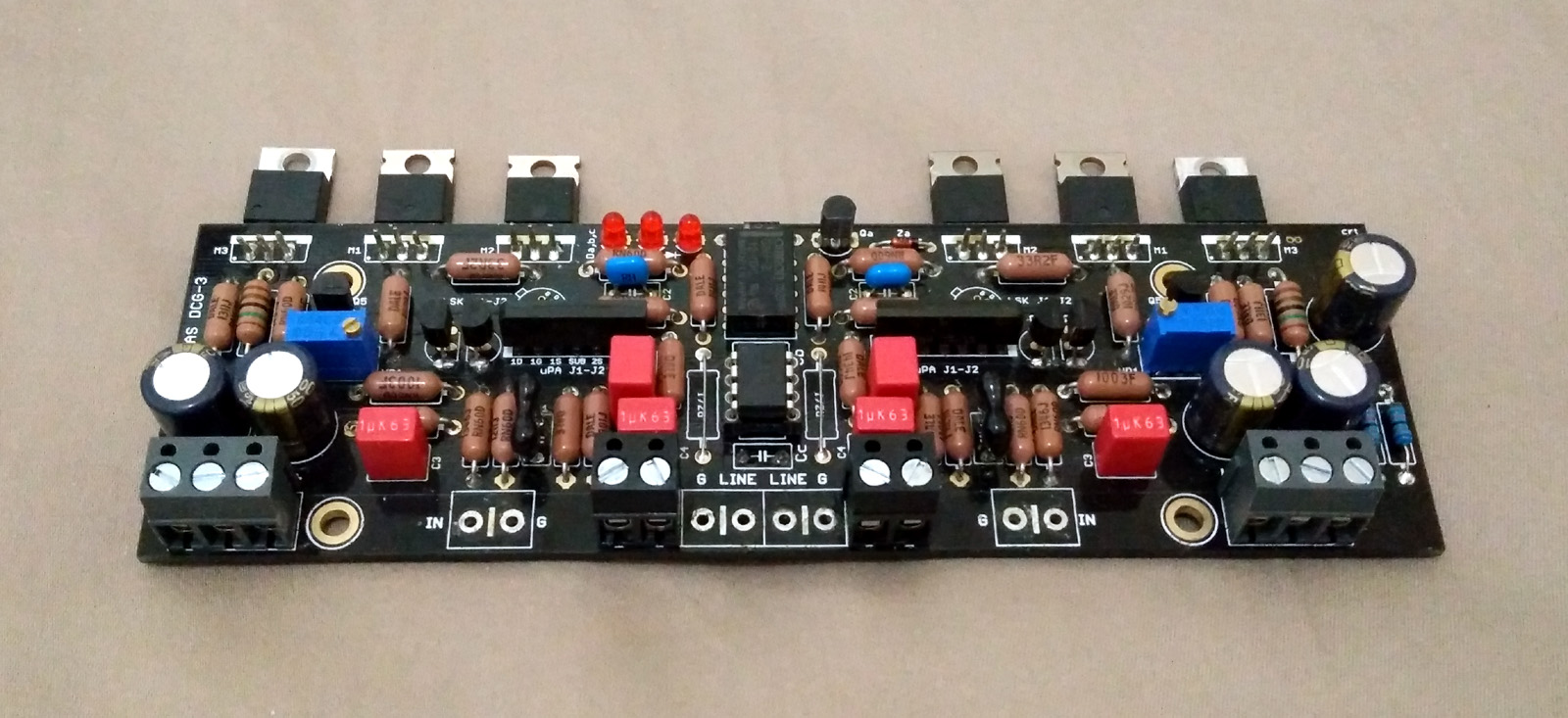

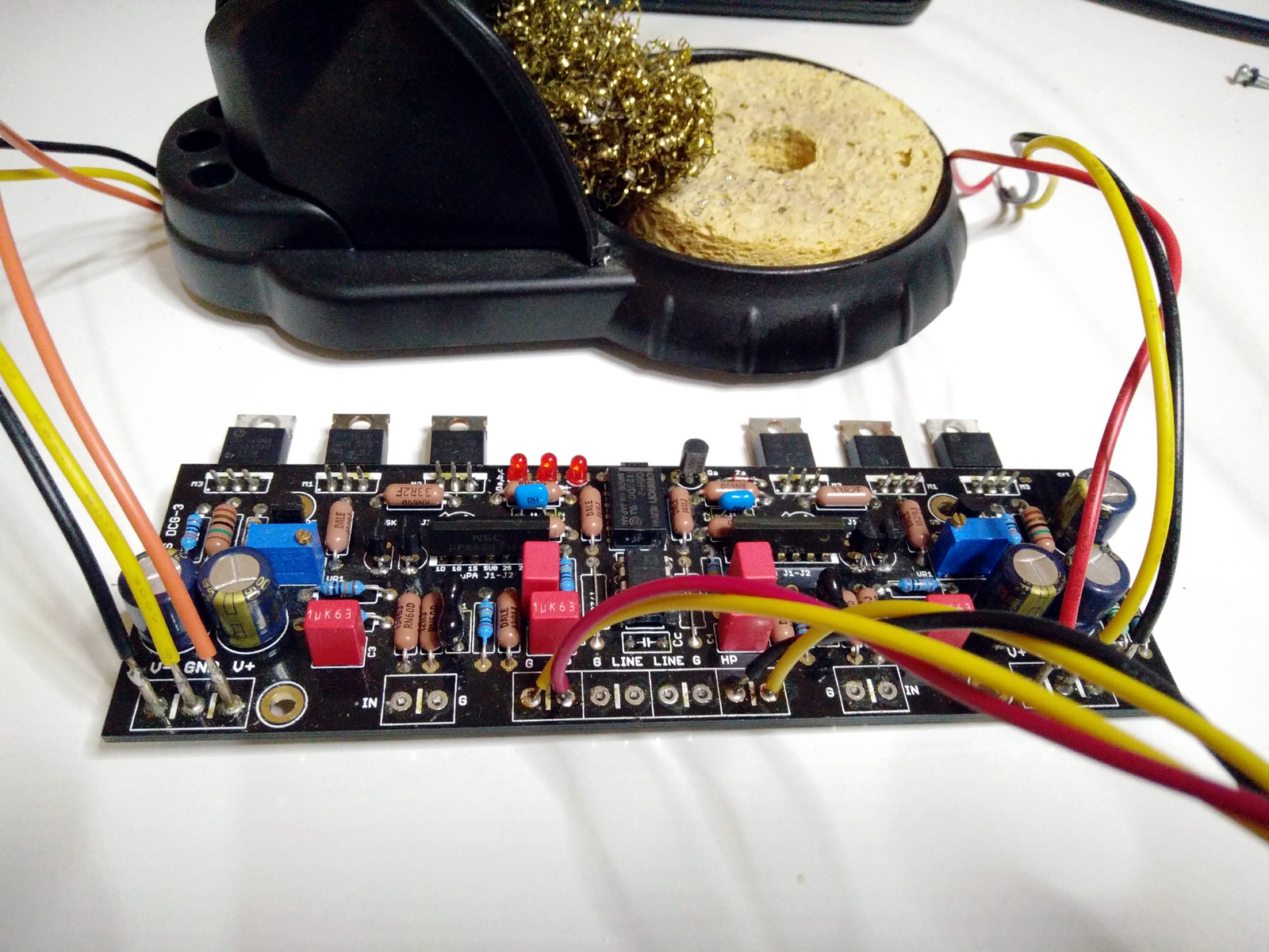

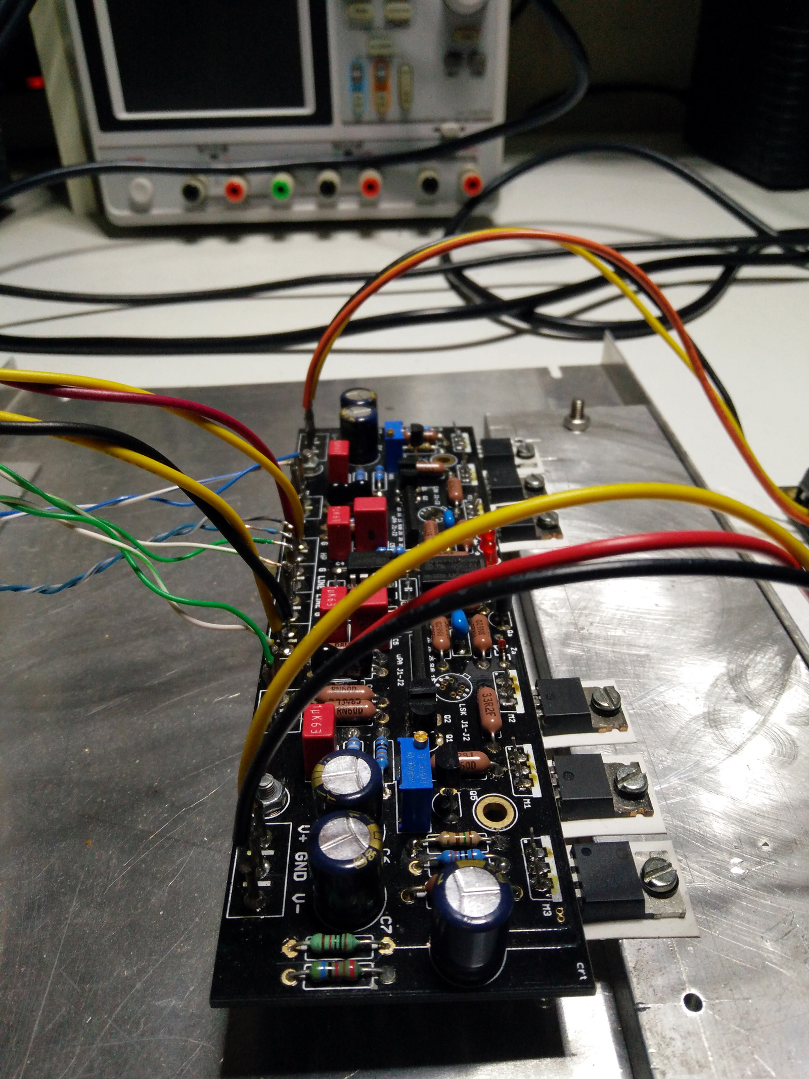

News are I had finished with the minor practical stuff so I completed with Crt the little corrections on the protoboards. Added MKP2 C5 frame, corrected the silkscreen orientation of Qa, fixed correctly mirroring pads of VR1s orientations, added alternative SMD1206 pads for Cb Cc, added output bleeder resistors to DCSTB. Now they are V1.02 and sent over to Tea.
