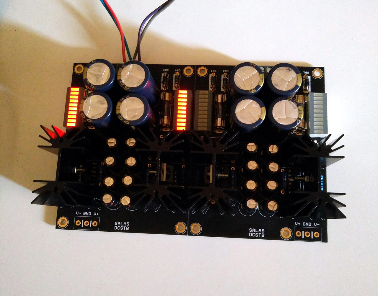

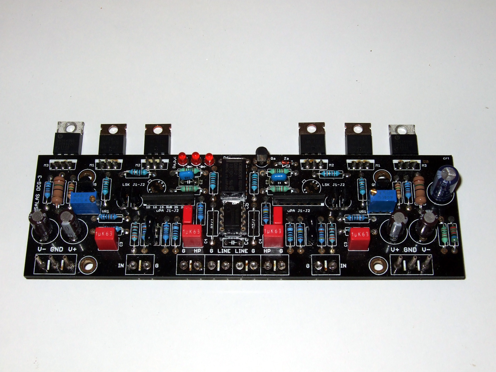

Tea has Lowthers. They can be picky. I propose he tries U1 AD823, MKP2 C5, R1 R2 33R in DCSTB, shorter signal cable runs, preferably shielded coax. RG174 is handy. Or Mogami.
I can make those mods over time. Including moving R4,R5 in DCG-3 to 33R as well from 51R.
MKS2 is currently used as C5. It is what fits 🙂
With my system, it simply does not need a lot of gain, so not being able to open up the ALPS pot all that much may be limiting too (plus it's a fairly inexpensive pot. But I honestly have no complaints at this point.
MKP2 63V DC or 100V DC for C5 also fits. I have the 100V 5% type in my hand and I can see it does because there is some free space around the MKS2. Indeed fatter and taller but same pitch. 5.5x11.5x7.2mm. No real problem with MKS2 but no problem investigating for better too.
Had also moved Cb Cc decoupling caps underneath PCB and soldered from above to could extract and change op-amps during the many done tests without drama. TL072 TLE2082 OPA2604 OPA2134 LM4562 NE5532 NJM4580 OP275 AD823 😀
*1206 alternative surface pads for 0.1uF 50V C0G Cb Cc are already added for the future.

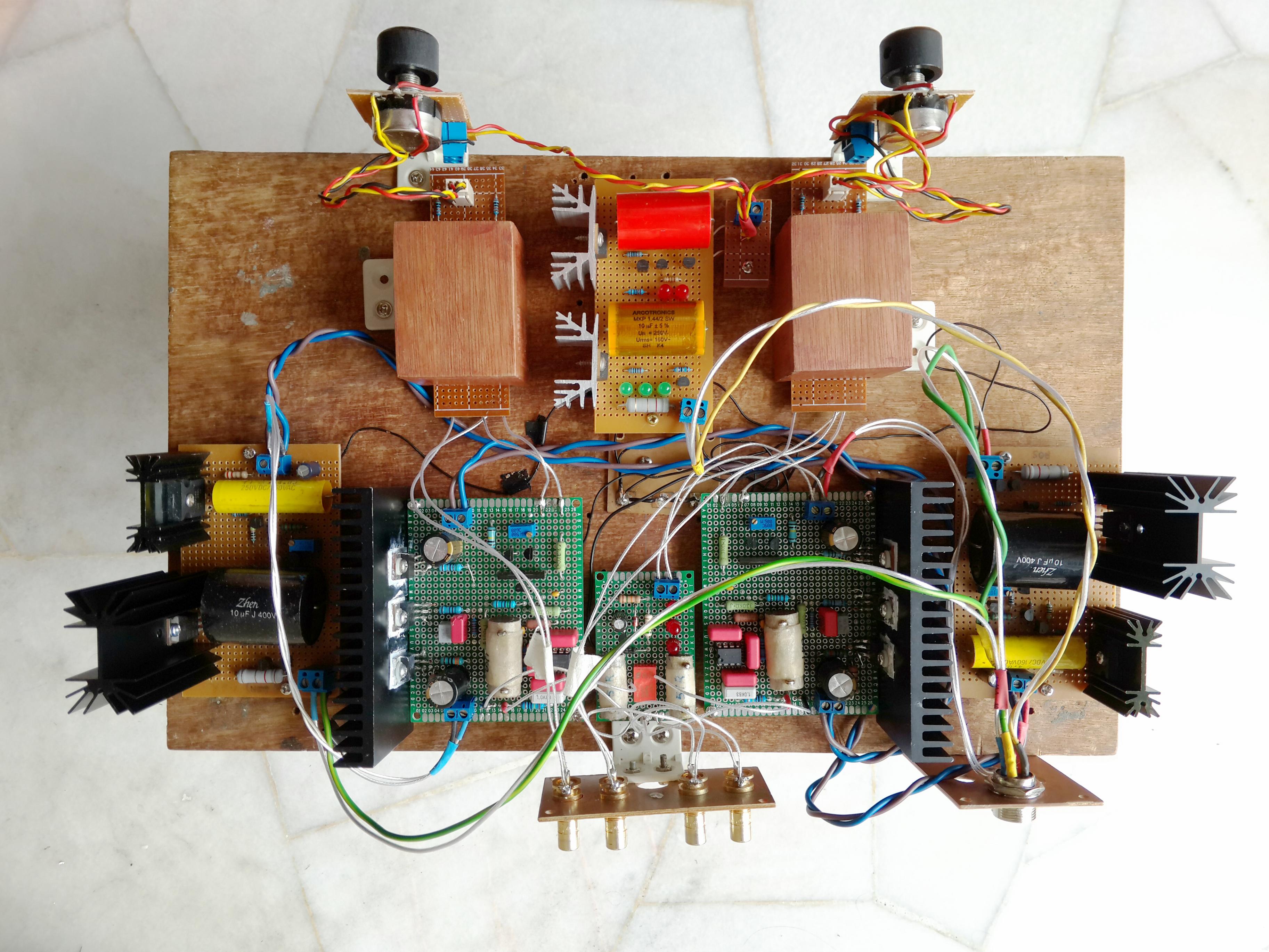

P2P DCG3 built ready for boxing 🙂.
Ayrton-Perry hand wound R6 and R15 speak traditional DIY

A few questions, for R4,R5 - I get the impression now they are part of the signal path and maybe should be decent resistors?
Also, how limiting is the Alps pot here? It's worth purchasing a Goldpoint or better attenuator, I am interested in that as well.
R4 R5 are gate-stoppers i.e dampers. Signal is there but no real current and no drop due to high MOSFET gate impedance. On the oscilloscope 33R gives slightly smoother corner on very high frequencies and amplitudes square wave tests than 51R, but generators, probes, and layouts can change this. Even with 10R it was stable and even smoother but I prefer bit more anti layout inductance damping to be there as good general practice. I got Dale RN60s for all signal associated resistors to use at a point but I always keep the initial test board as generic as possible in order to make sure its basically alright without fancy parts. No difficult tonal problems as for now. Stick an AD823 first which is very easy to do. Tham says he can easily prefer his DIY LDR over a Tocos. I use $1.5 carbon Alpha pot for tests 😀

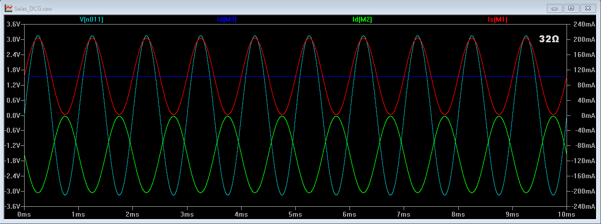

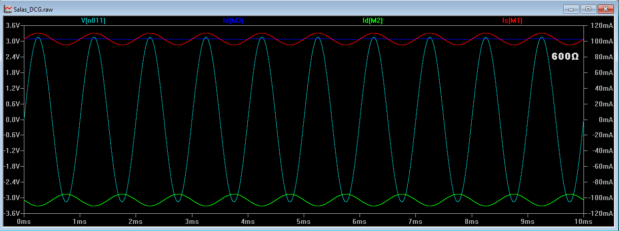

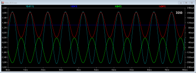

Few words about power
Lets talk two examples. One is wanting to drive 2.2VRMS into a 32 Ohm headphone*. The other is wanting to drive 2.2VRMS into a 600 Ohm line. Say at the standard 100mA output stage DC bias choice.
The two graphs show output voltage, M3 drain pin current, M1/M2 drain pin current (identical) and M1 source pin current. Its the same PSU drawn current amount just shown reversed phase at source pin. The output stage will only pull steady DC bias from the negative rail because its current source M3 resides alone there while it can pull double that pk-pk from the positive rail before progressively squashing the below zero going part of a waveform. Will drive 200mA pk-pk on 32 Ohm but only 15mA pk-pk is demanded on 600 Ohm for that same output voltage. 33V pk-pk (11.7VRMS) with 55mA pk-pk can be done on 600 Ohm. A 10K amplifier will be driven to 33V pk-pk with just 3.3mA pk-pk.
So the about +/-17.5V PSU should be capable of at least 200mA on the positive and 100mA on the negative to cover the demanding load example. There is little more to add for the input stage and the servo.
If using double mono BIB shunt regulators a 250mA CCS limit for the positives and 150mA CCS limit for the negatives would be the economic choice heatwise. Double that when with common between channels mono regulators. If using the double mono DC stabilizer there is nothing to set. Its just a low noise non amplified voltage reference with a compound current pass transistor (Sziklai) of high enough amperage.
When not planning to use headphones, or at least not below 70 Ohm impedance ones, then 150mA CCS per rail limit for double mono regulators will suffice. When planning to use much insensitive low impedance headphones then more DC current bias and higher super shunt PSU CCS limits can be calculated.
*That is 120 dBSPL on a Grado. Will blow your head 😀
