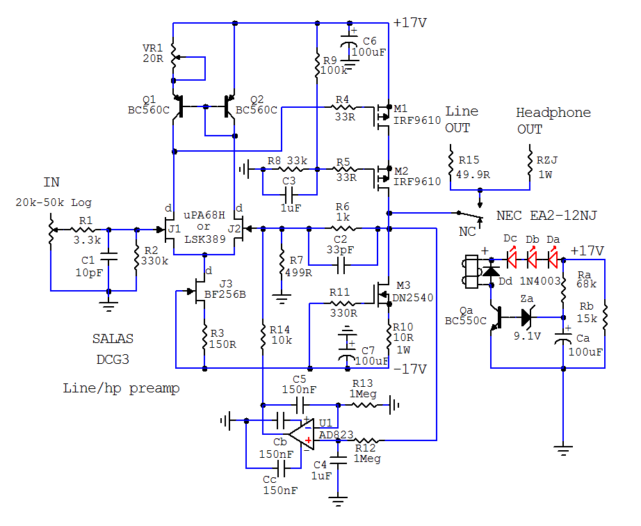

M1 Vgd does not move at the real voltage gain rate of the duo so its Cgd does not appear multiplied. Because M2 shields M1 from the Miller effect. The little JFET needs to directly drive the big MOSFET's capacitance. Without help of another stage in this case, so to keep things as straightforward as possible. By removing the output stage's Miller, the driver stage's strain is less. Bandwidth is very good and we even spared some in the end but we mainly wanted to better THD.
Time for a circuit description:
The volume pot adds impedance to the RC input low pass filter (R1,C1). But when set at max volume the pot becomes just a contact and the circuit must remain stable. So R1's value is chosen to form an effective time constant with C1 for stability even in direct input conditions. The system is also closed loop stability compensated (C2 across feedback network's R6). With the volume pot at max and a 50R signal source impedance the slew rate of this circuit can be >25V/uSec. The exact figure depends on internal routing and bench test loop specifics too.
J1 & J2 form a long tail input pair actively loaded by Q1 & Q2 mirror. VR1 is used to null the DC offset before U1 DC servo is put in place. So to work very little, against thermal drifts only, not against a residual mismatch. J3 is a low capacitance RF type JFET used as a constant current source biasing the LTP.
The signal path directly continues from J1's drain to M1's gate. M2 cascodes M1. R9 R8 voltage divider biases M2 for half the positive rail across it. C3 filters at the divider's junction to keep gate DC voltage bias clean. Low capacitance is key so to can directly drive the output stage from just a small JFET with little distortion as already mentioned. Its a delicate situation here because there is no intermediate stage to boost drive current. The semiconductors hands on choices mattered for synergy.
With Fairchild's fastest TO-220 MOSFETS the circuit's THD wasn't as good as with Vishay IRF9610s for instance. Various JFET types changed the THD figure and its harmonic trend also. Higher rails voltage keeps on making the MOSFETS less capacitive up to 25V or so. Resulting to even less THD. This output stage is a voltage gain stage too. Due to dissipation reasons for all the semiconductors but especially for the high bias output ones, and not to add special regulators for U1 and the relay, a sweet spot was chosen.
M3 is a fast depletion mode (self biasing) MOSFET. Makes a constant current source for the output stage. Having CCS both on input and output stages not only fixes this circuit's total bias current against drifting better but also increases its PSU ripple rejection ability.
R10 sets M3's current draw. Bias >100mA can be chosen with M3's IDSS being the limit (listed at 150mA minimum). This mA region is also the M1 M2 zero tempco region. Bias stability tested solid indeed with moderate sinking. R6 R7 form a low impedance feedback network to the LTP's return input (J2). Low impedance is necessary not only for low noise but to also keep this particular circuit stable. In most cases the burden of driving that network is heavier than what the preamp will be called for to drive on its line output.
By the way, with the more capacitance of output interconnects this preamp sees, the more its phase margin. I.e. no worries for long or parallel output cables. Tested stable with just a 10nF capacitor as an output load even. The bandwidth would be seriously curtailed with such an extreme parasitic capacitance example of course. Coaxial signal cable has about 100pF per meter on average to keep things in perspective.
U1 op-amp senses the circuit's output around DC through the R12 C4 low pass filter. Then integrates time via C5 and drives counter-DC corrections through R14. Working as a DC servo at about 2.3HZ corner frequency proved responsive in this circuit. Many U1 types were tested to pick a BOM favorite. JFET input technology chips in general are most adequate for this job here because of the low pass filter's very high impedance they see.
The output from M2's drain is interfaced with a lab standard 50R to line output. Another route goes to headphone output. Zero additional Rz with using just a jumper is the technically neutral thing. Alternatively a judicious Rz value can be used to under-damp and loosen up some headphones which their users may describe as "dry". Caution though, anything higher than 10% of the nominal headphones impedance for an Rz resistor will interfere with their overall response more than +/- 1dB. Unless someone opts to intentionally color them even further.
Because no capacitors are in the signal path, a delay relay system (set at 5 sec by Ra Ca) waits for the circuit to settle so no power-on DC bump gets through. It also disengages quickly during power off. Dc Db Da LEDS drop the rail voltage to 12V relay working range territory. One of those LEDs can even be wired to the front panel, as an external "ready" sign because they light up only when the output relay clicks and signal passes.

Hi all, this thread is about a JFET & MOSFET preamp I am cooking for sometime now. Its two stage single ended Class A circuit.
It was developed on the bench involving much experimentation with topology and a range of active parts. Simulations came second.
Some speakers are insensitive, some amps also, or a source is relatively low output like a phono stage. So a line preamp with gain is good to have.
Its named DCG3 because it has DC servo and three MOSFETS. Its standard gain setting is also times three. 😀
The main schematic is attached
Some THD plots when driving 1.5kOhm line input and various headphones are also attached.

The maximum output into a very high load impedance is approx 1/3rd of the supply rail voltage i.e. 24V/3 ~ 8Vac
That should be plenty.
Maybe Salas can recommend modifications to suit a slightly higher supply rail for higher impedance headphones.
It could do the K1000's max with 20V rails, 150mA output stage bias, and gain 5.5 from a 2V RMS source (2.25K R6)
That would bring 6W standing dissipation per channel. Better be built in double mono for separate sinks with 15V reg chips for the op-amps and the relays also.
And for Sennheiser H600 300 ohms?
No problem. HD 600 states 97dB/mW which is about 102dB/V for 300 Ohm. With 2.45VRMS and 20mW it will give 110dB. Don't listen so loud sustained to other than peaks in Rock concerts. I will sometime soon have HD 600s in my hands to tell you more about the quality of the combination too. K1000s are 74dB/mW and would do 100dB at 400mW (6.9V RMS at 120 Ohm) and only 104dB at its 1W max. So that's a non much useful destruction max. That inefficient headphones are simply quiet headphones and pushing them for bit more increases their distortion and probability of damage.
